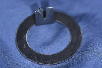

    The old style uses the pin, but the bearings on my trailer have a washer that fits under the castle nut with two tabs. The axle also has a flat cut into the side so that the washer cannot turn. You bend a tab in between the turrets of the nut which keeps it locked. I grew up with the pin and like that system better, but this is progress, I guess.
    It's dark now, but maybe I will go out and try to get a photo. The grease makes it difficult to see the tabs. No guarranty that the photos will be prize winners.

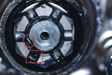

    The red circle barely shows the prong which hasn't been pried over the gap between the turrets of the nut, and the square, again barely, my apologies, shows the prong bent into the space on the nut. Perhaps the other view of the washer with prongs makes it possible to visualize what's going on. The flat spot on the washer locks over the corresponding flat ground into the hub. Make any sense?

    I have to change my original post as I was wrong. The prong was bent as it should be on the driver's side, but not on the passenger side, leading me to believe it was a one-time error and nothing to worry about. The grease tricked me. Maybe I didn't have my reading glasses on. That both of them should be wrong seemed completely out of character with everything I know about Camp-Inn. So, I am very glad to have been mistaken about this detail.
