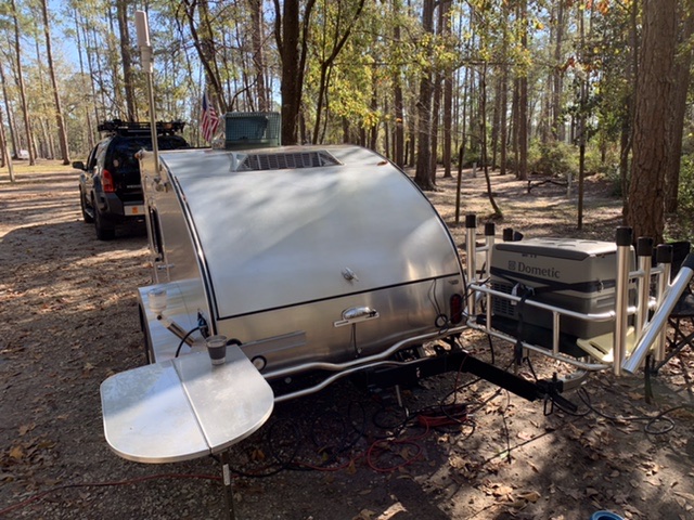

I was considering getting one of these boxes and the hitch mount/base plate to store my Honda 2200 Companion generator on while boondocking. My 560 will have the optional 2” hitch on the back of the trailer traditionally used for storing bicycles. Thoughts?
https://www.rvgeneratorbox.com/product-details
I use a similar generator box mounted on a Yakima swing away hitch mount. The picture is the only one I have and shows the mount in the stowed position. The second photo shows the open position but with just a cooler.
