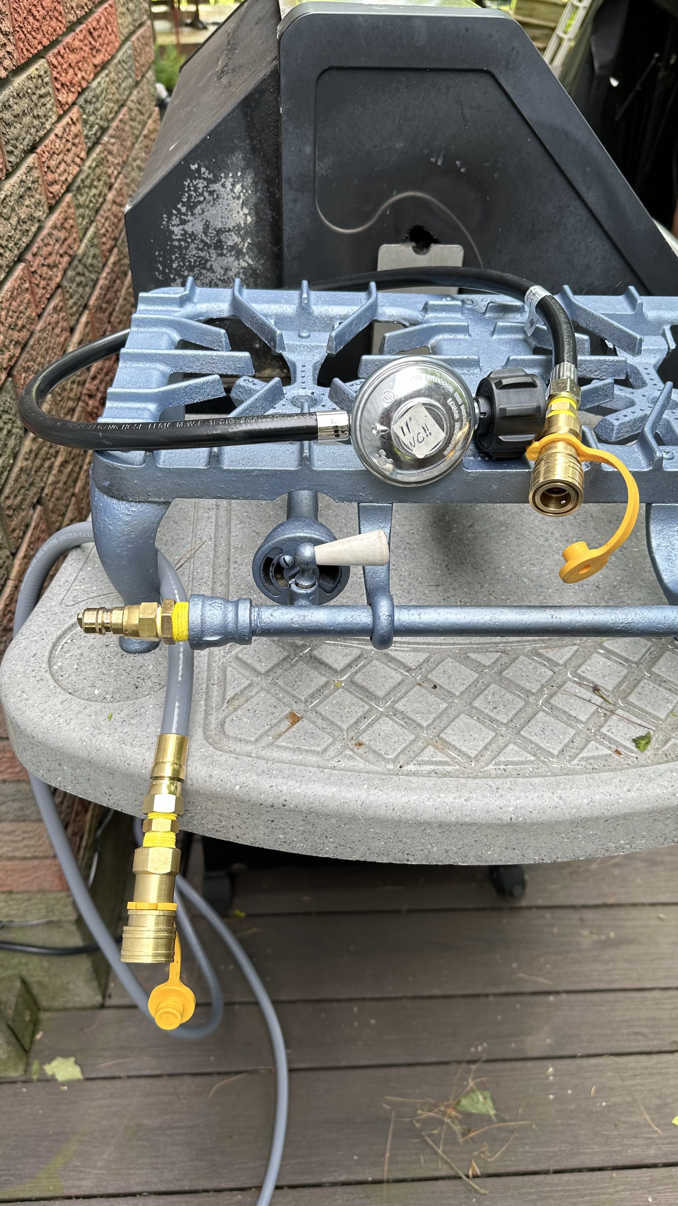

    I made a bunch of quick-connects so I can easily switch between the two fuels:

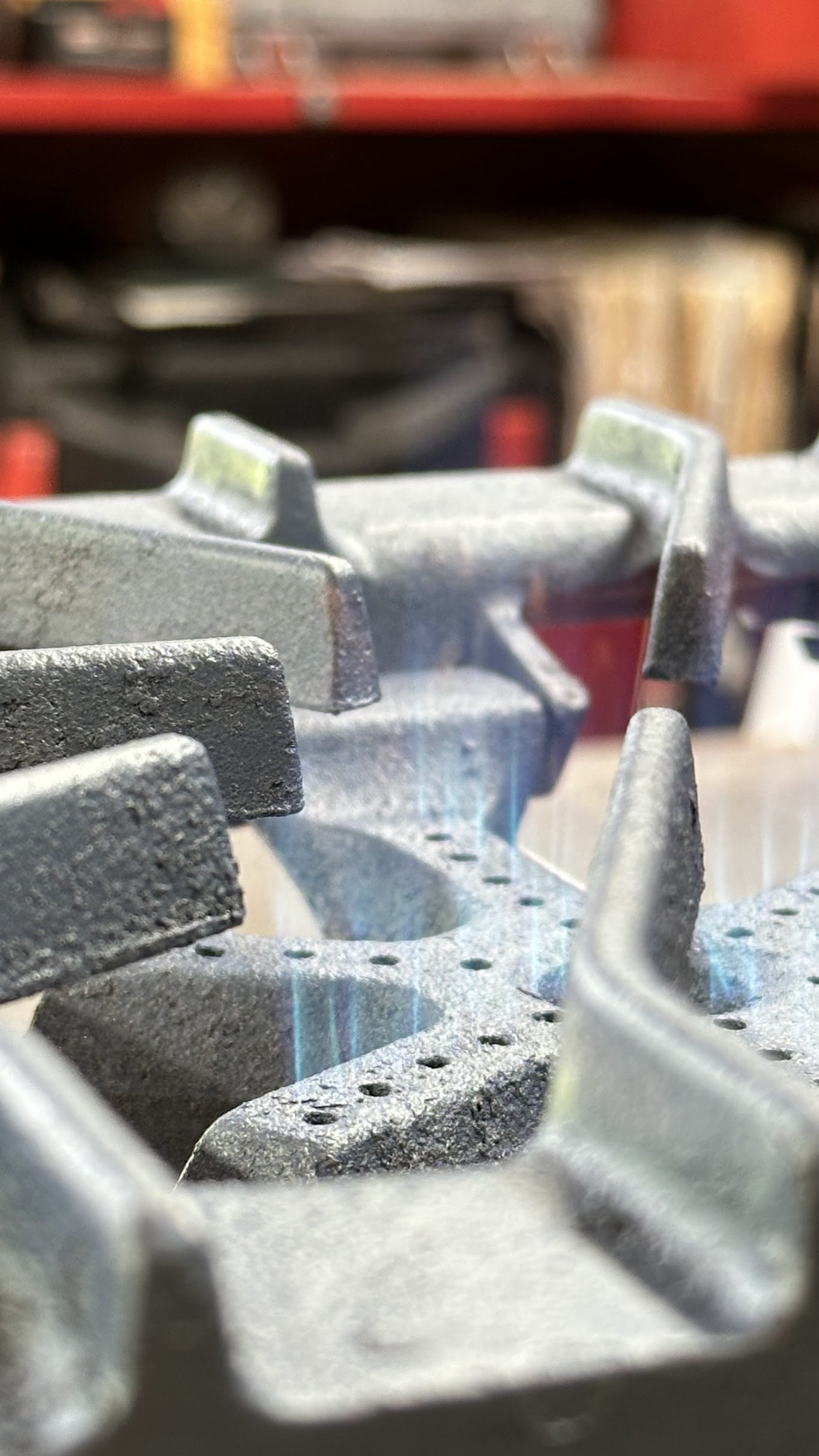

    When it is running off a propane tank with an 11" WC regulator (that you see in the pic above), and the #73 orifice, it gives a decent flame at 2/3 "on":

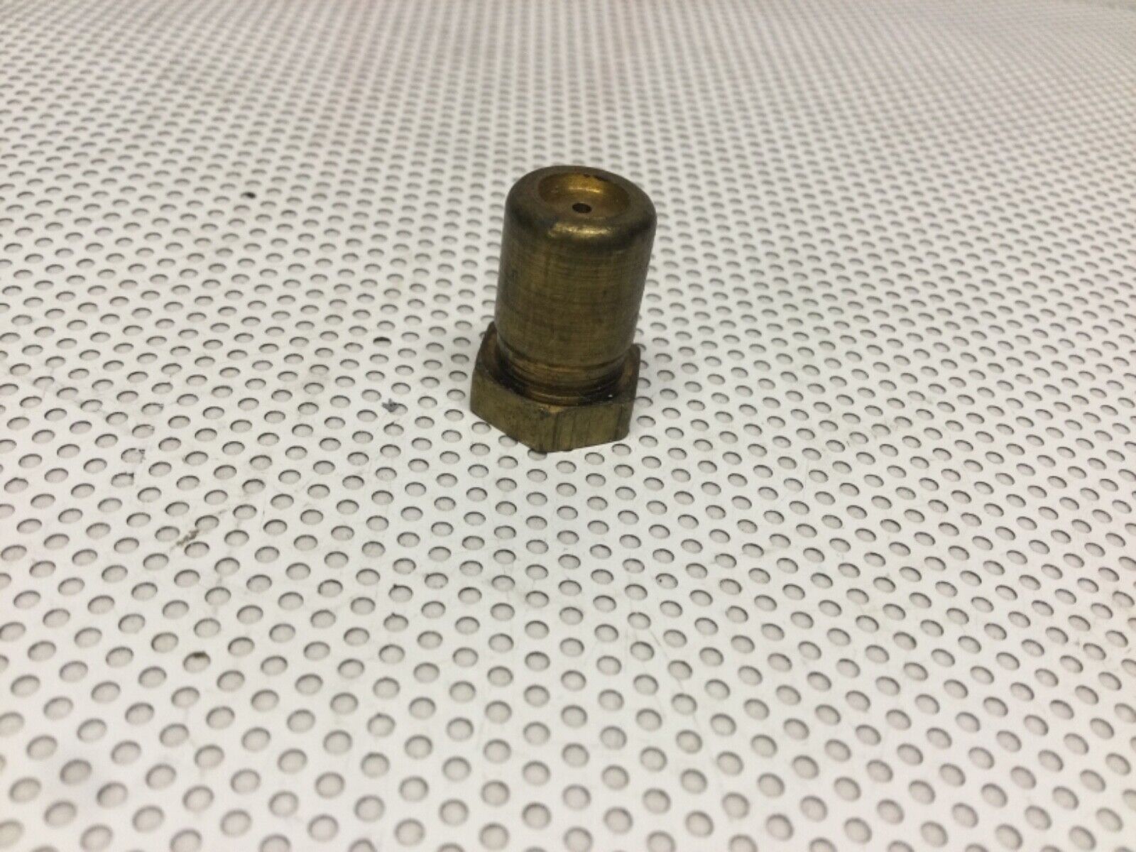

    In order to run natural gas through it, I took one of the orifices:
    ... and drilled it out to 1/16th" on my press. This allowed enough flow through at the lower natural gas pressure to mimic how the other side burns. I didn't take a pic because the flame was essentially invisible. (If you're going to do this, experiment by working your way up to the properly sized hole, as your house pressure may differ from mine.)
