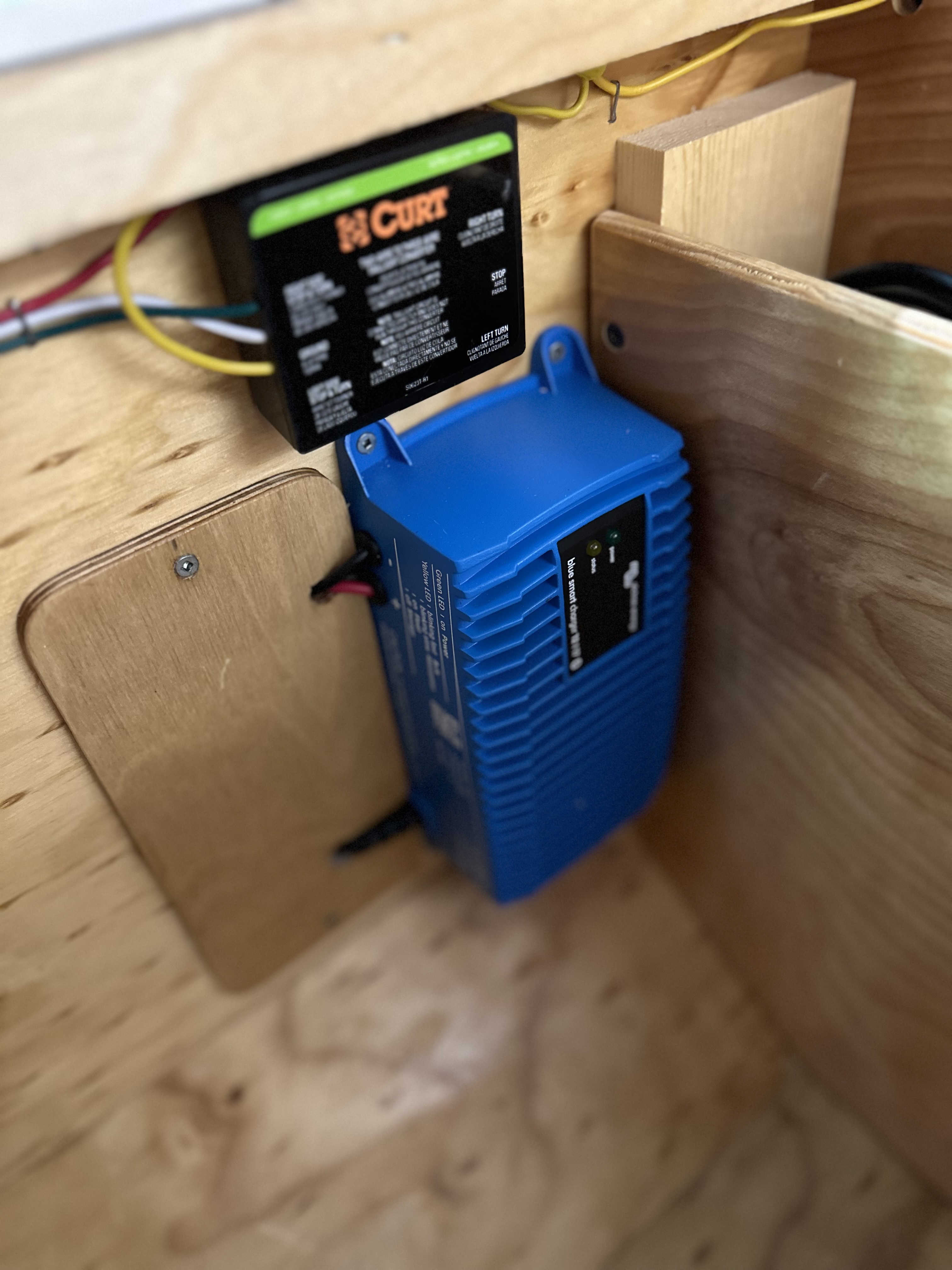

    Since my OEM mounting position was the right bin, recessed into the rear-most wall, I put the new one there as well. But it is impossible to recess it (a la Camp-Inn) in this vertical position, given the plethora of wiring in this space. This was the best location to run wires, allow the battery door removal (very important), and for our existing pots and pans storage:

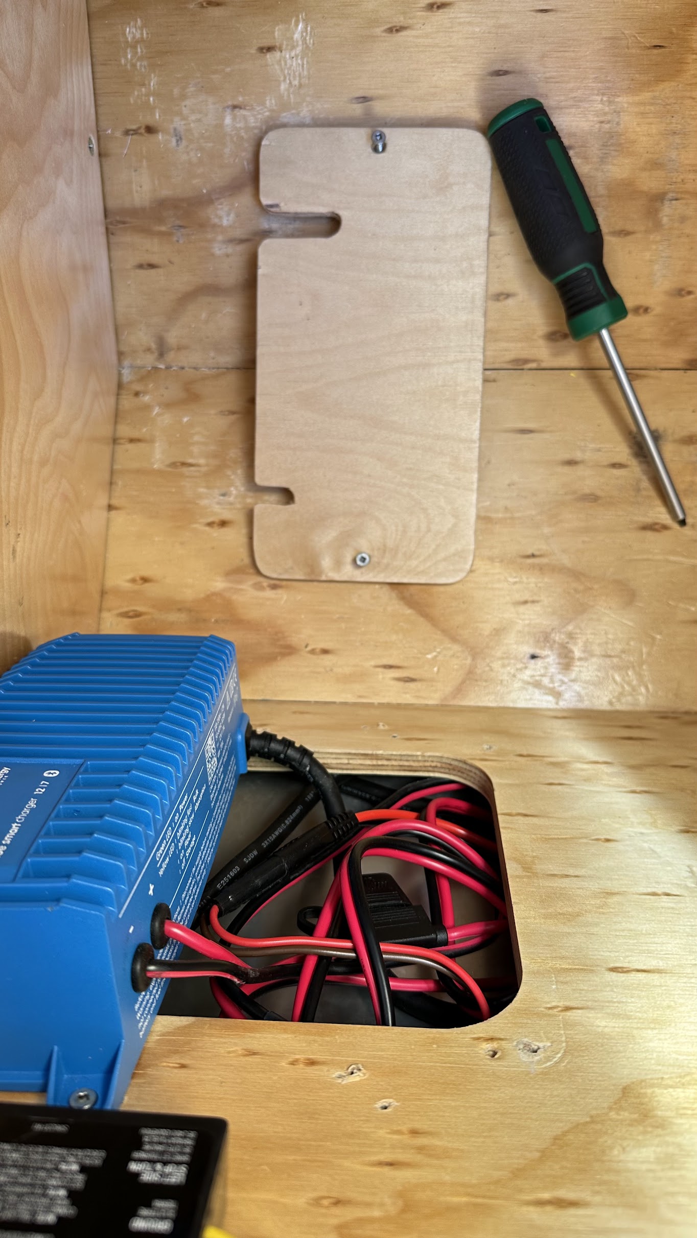

    (The Curt box above is for the third brake light control BTW) A new plywood plate covers the factory charger hole.
    I does take up slightly more room in the bin than the OEM. However, we are still able to get a 10pc Magma set, 2 collapsible kettles, a mini-saucepan, frying pan, toaster, grease splatter screen, wind screen and the Omni baking oven in, with a secure fit using some closed-cell foam and double-sided tape. There's some leftover breathing room/ventilation for the chargers. The bin tray fits on top.

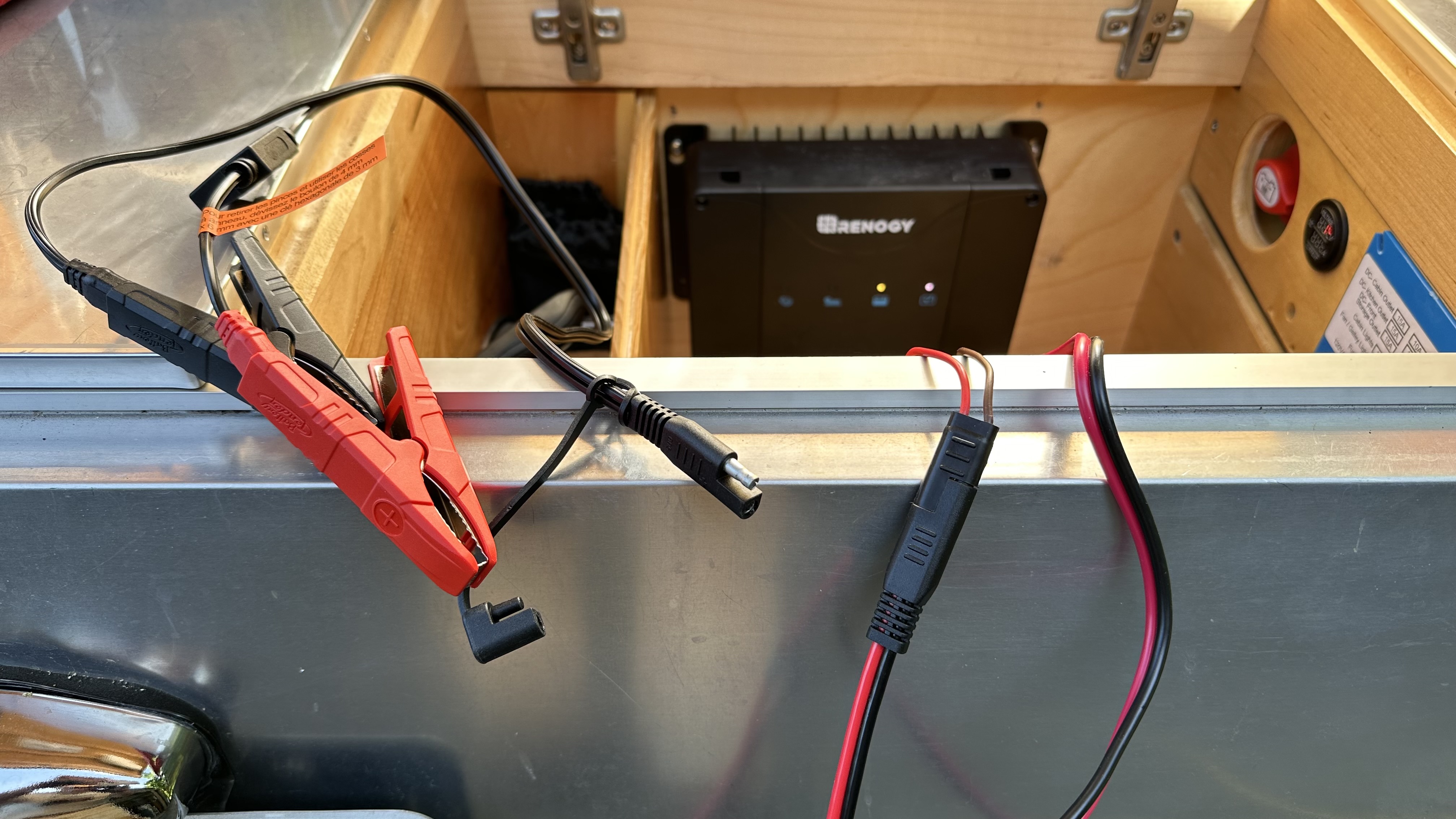

    I just fully charged the AGM on both the Victron and the Renogy DC-DC yesterday. Both went into Float. So I set the Shunt to 100%. And notwithstanding some very short period test draws today during my install of the Maxx fan I have had nothing running off the battery and am curious to see how long I can stay at 100.
    Both the Shunt and the Renogy have some minor drains. The Renogy consumes 60mA on standby, while the Shunt consumes a paltry <1mA, according to their spec sheets. The Shunt is showing a 0.11A continuous draw, which would be a somewhat accurate reflection of those two devices on standby. But the battery has stayed at 100% over the past 24 hours. We'll see how long it can go before I start to see some deficits of note. But it doesn't appear that I am dealing with any drains of which I am not aware.
    The one curiosity I am dealing with is that the DC-DC turns on, even without my headlights/trailer tail-lights as a trigger switch. The Ignition switch is wired to the Camp-Inn "Lights" screw post which I tested beforehand as an on-off circuit. Oh well. I'm not opening up that can of worms again. The battery is in; it works. And so do the chargers and all the BT apps.

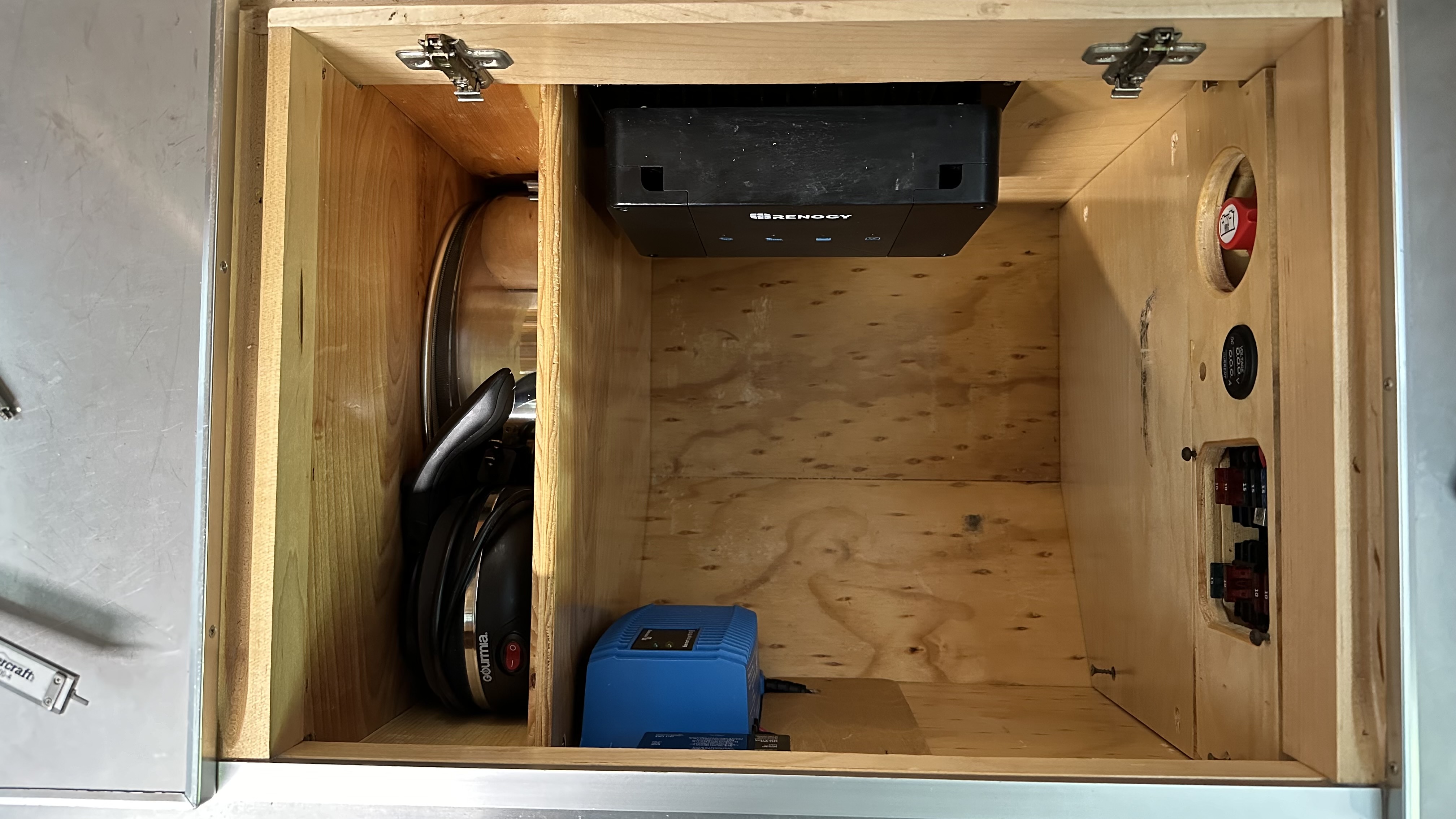

    This gives me the opportunity to charge another battery (like the the TV battery, in a pinch) by removing two screws and the panel, and connecting the alligator clips.

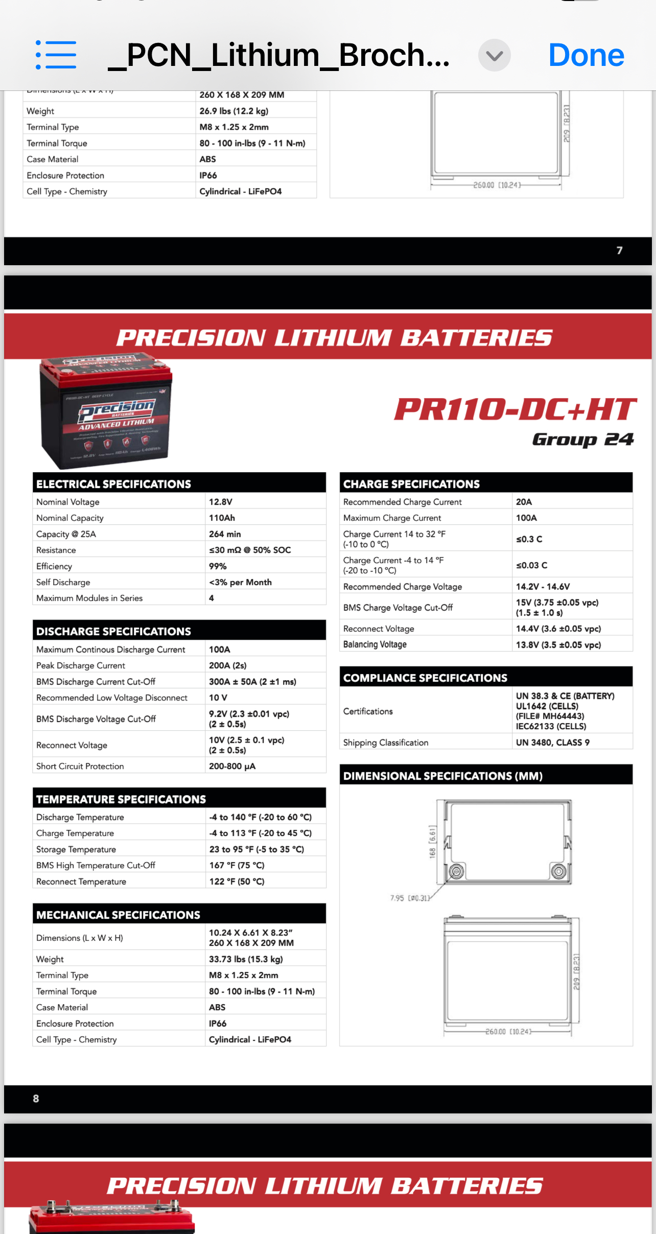

    Just re-RTFM ing on the Precision spec sheet, assuming if I am reading it right, the recommended charging is at 20a, so the IP 67 7/17 could work the high side for best battery maintenance?
    The key is nothing else before the shunt (thanks Steve).
