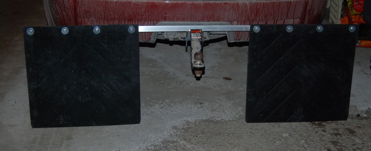

When I started using my Jeep Laredo I had more of a problem with mud/stones getting kicked up. Checked out the rock tamers and decided I could probably build something myself.
Here is my material list:
1 - 1.25" x 1.25" x 0.25" x 72" - structured aluminum angle - $26.00
1 pair - 24" x 24" x 0.25" truck mudflaps - $29.00
8 - 5/16" x 1.5" fender washers
8 - 5/16" x 18 - hex nuts
8 - 5/16" lock washers
8 - 5/16" x 18 x 1.25" tap bolts
1 - 3/8" - 16 - 3"x4" U-bolt square bend
Total - $8.50
+ about an hour and fifteen minutes assembly time to drill holes & tighten bolts.
