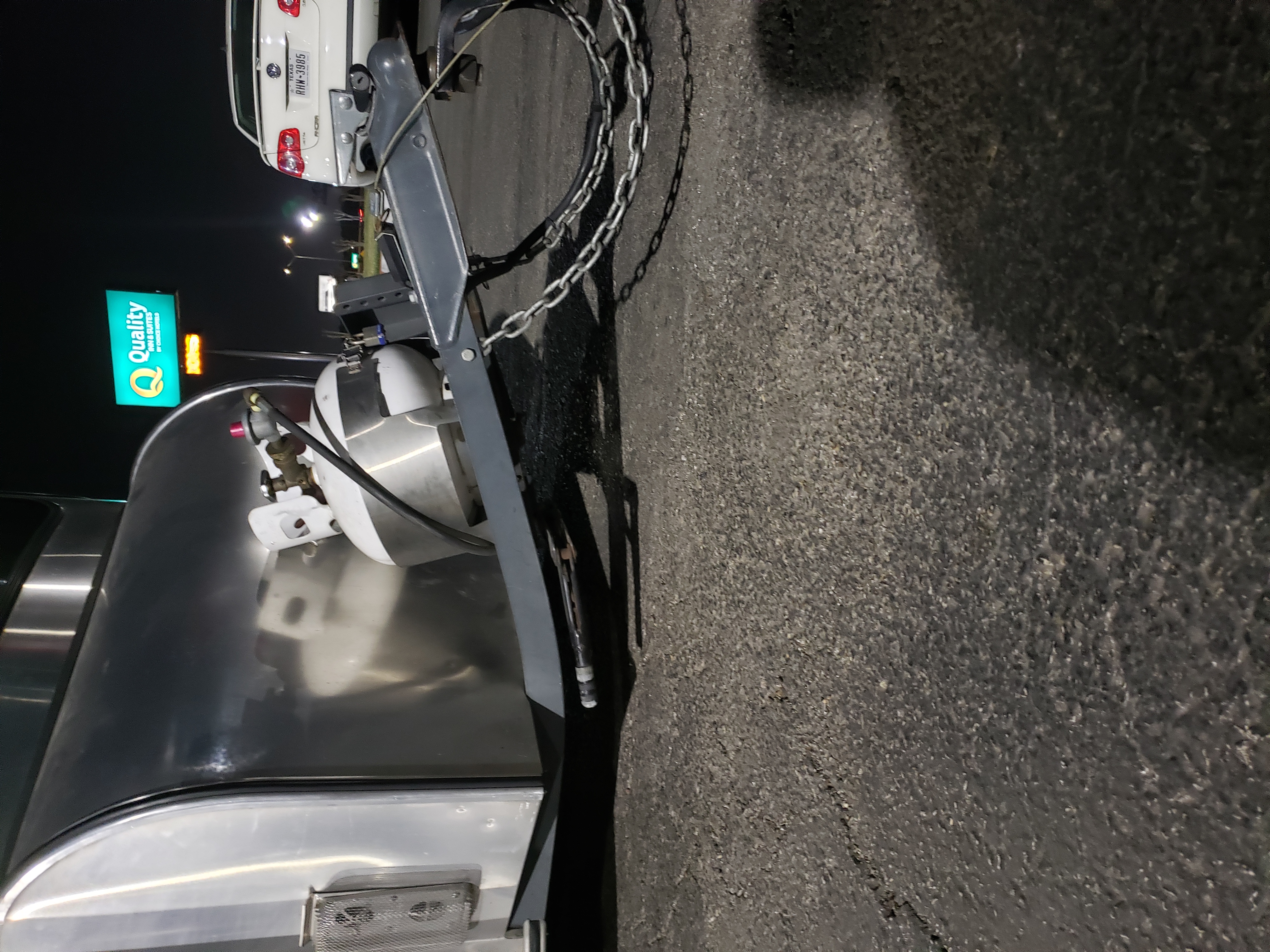

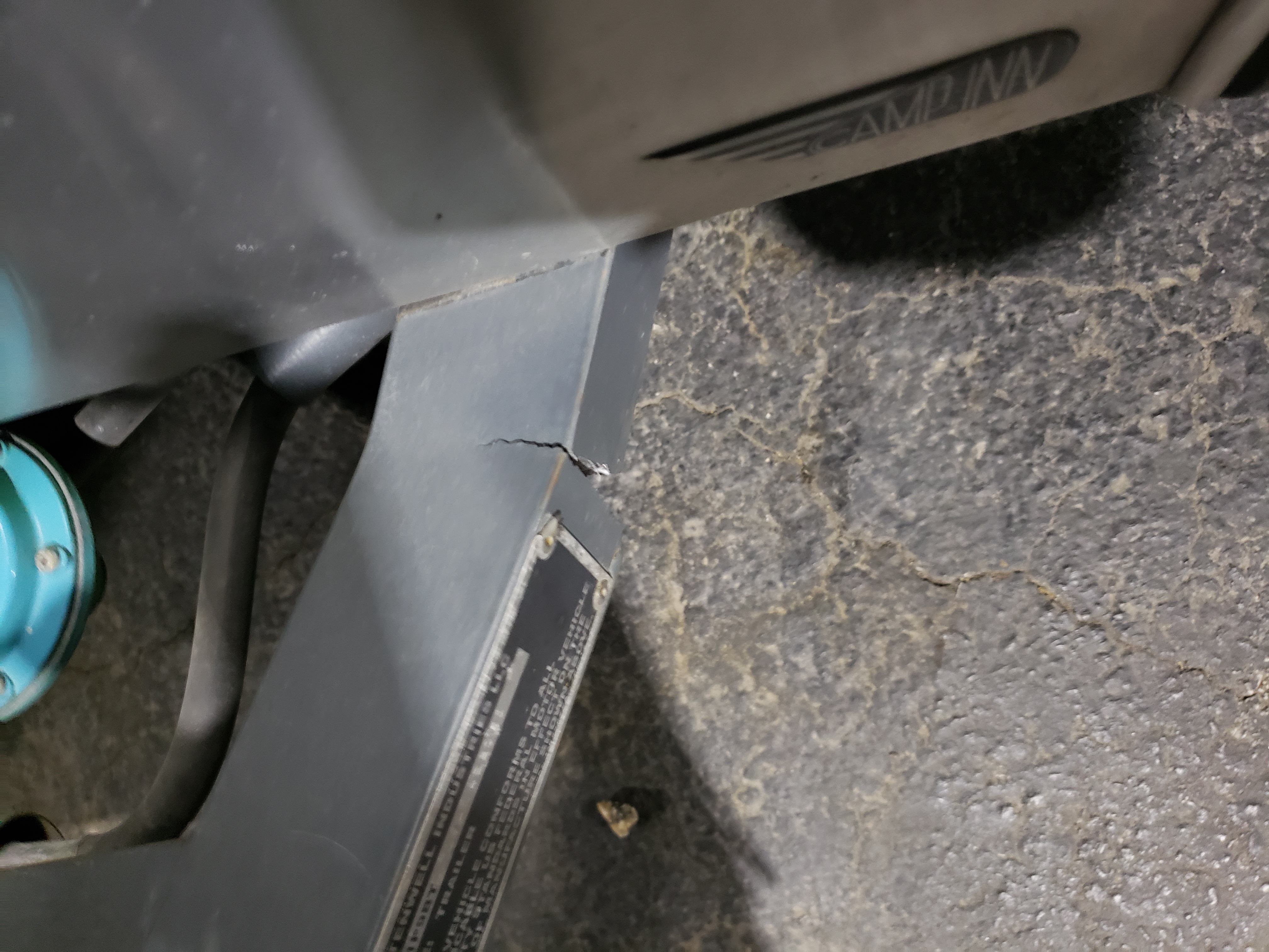

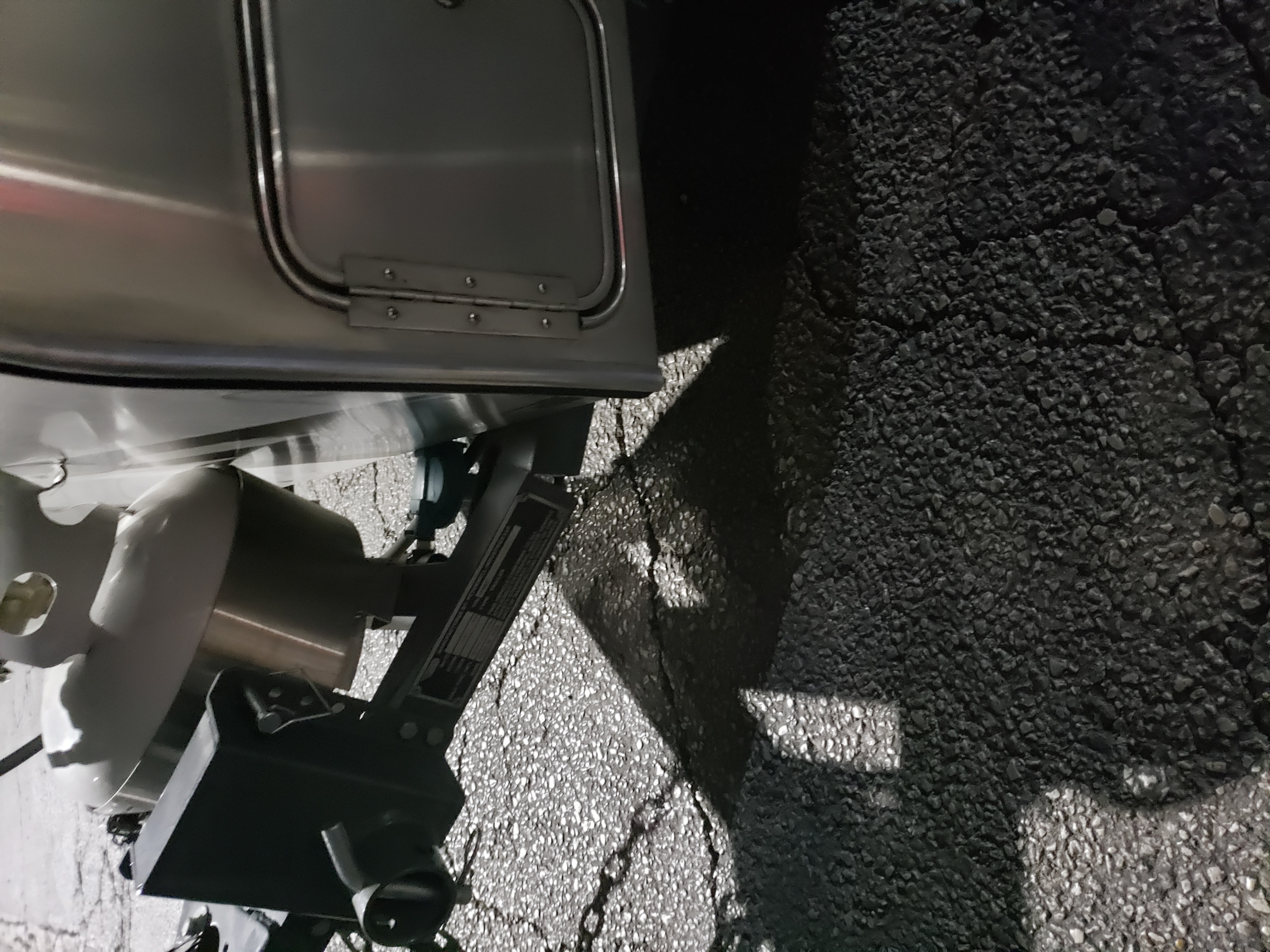

    I was towing our 560 Ultra on vacation and ran into horrible road conditions and construction along I-10 from New Orleans to San Antonio with constant pot-holes, unenven road surfaces and level changes in the roadway. Our trailer was constantly bouncing down the highway. Upon arriving at a hotel in San Antonio I discovered that the frame on the trailer was broken. Has anyone ever had to seen this type of trailer failure before? Is it fixable? I had to rent a flatbed and trailer it back to Denver.
    The trailer had about 200 lbs of camping gear, if even, and the 11 gal propane tank on it. No cracks were noticed prior to the failure.
    If you have experienced a similar situation I would love to hear how it was repaired.

    Oh my, I am glad you are safe. That's not supposed to happen, it looks like Camp in is going to make it right. I have never heard of something like that, we have towed on some pretty rough roads in the back country. Good luck and keep us updated with the progress of the repair.

    Holy cow! That looks gnarly. It doesn't seem like you had an excessive amount of weight in any way. I'm surprised the frame did that. I'm very interested in hearing what the final resolution is, since we do a lot of travelling on bad roads with ours.

    Sorry about your experience. I was not expecting to see what I saw when I opened the pictures.

    That is crazy. Surprised to see this. I never would think frame would bend from bad road. With such a short wheelbase you would think it would just bounce up and down. Look like a lot of down force needed to bend the frame.

    I've seen this, it yes it is very fixable.
