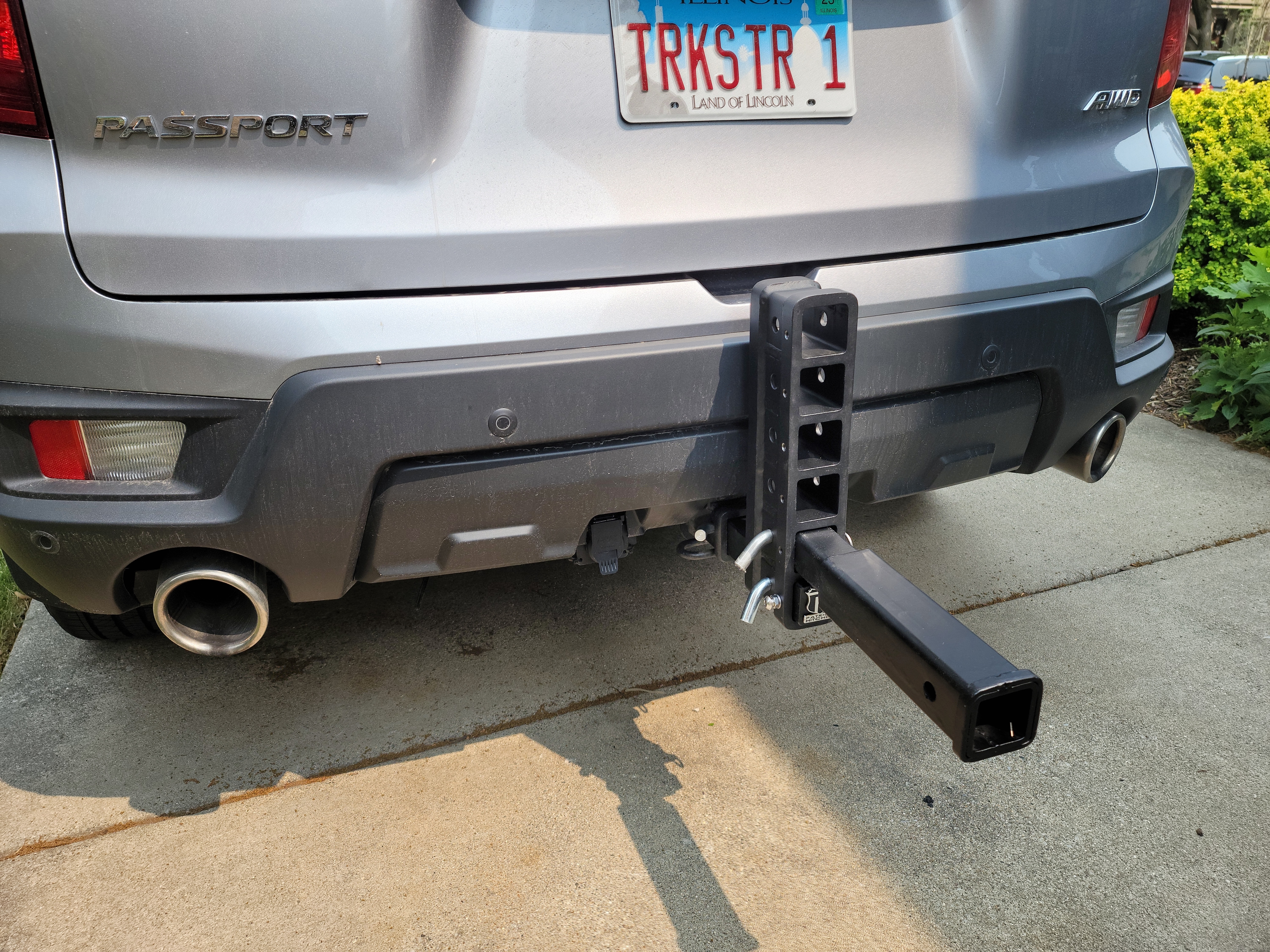

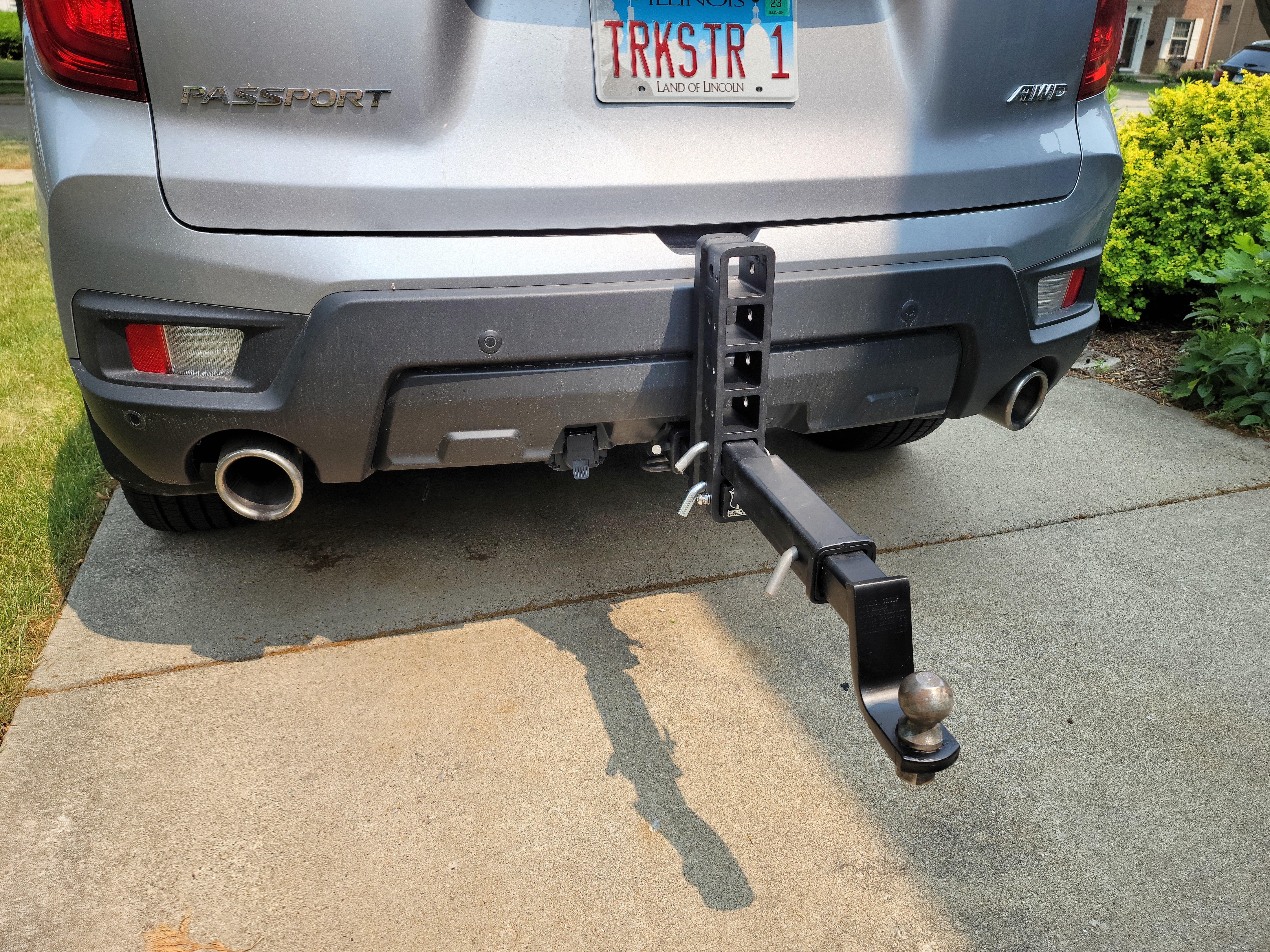

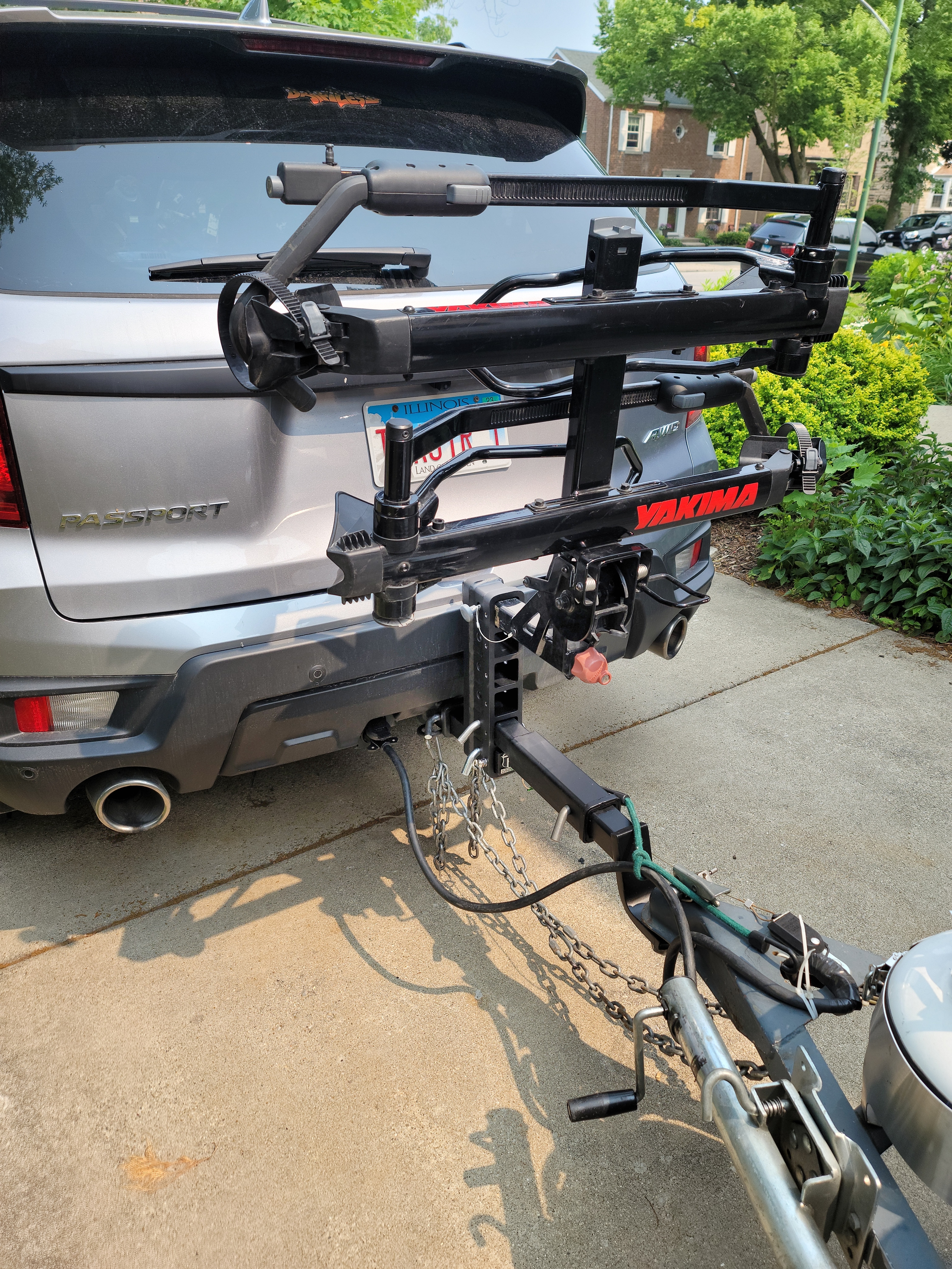

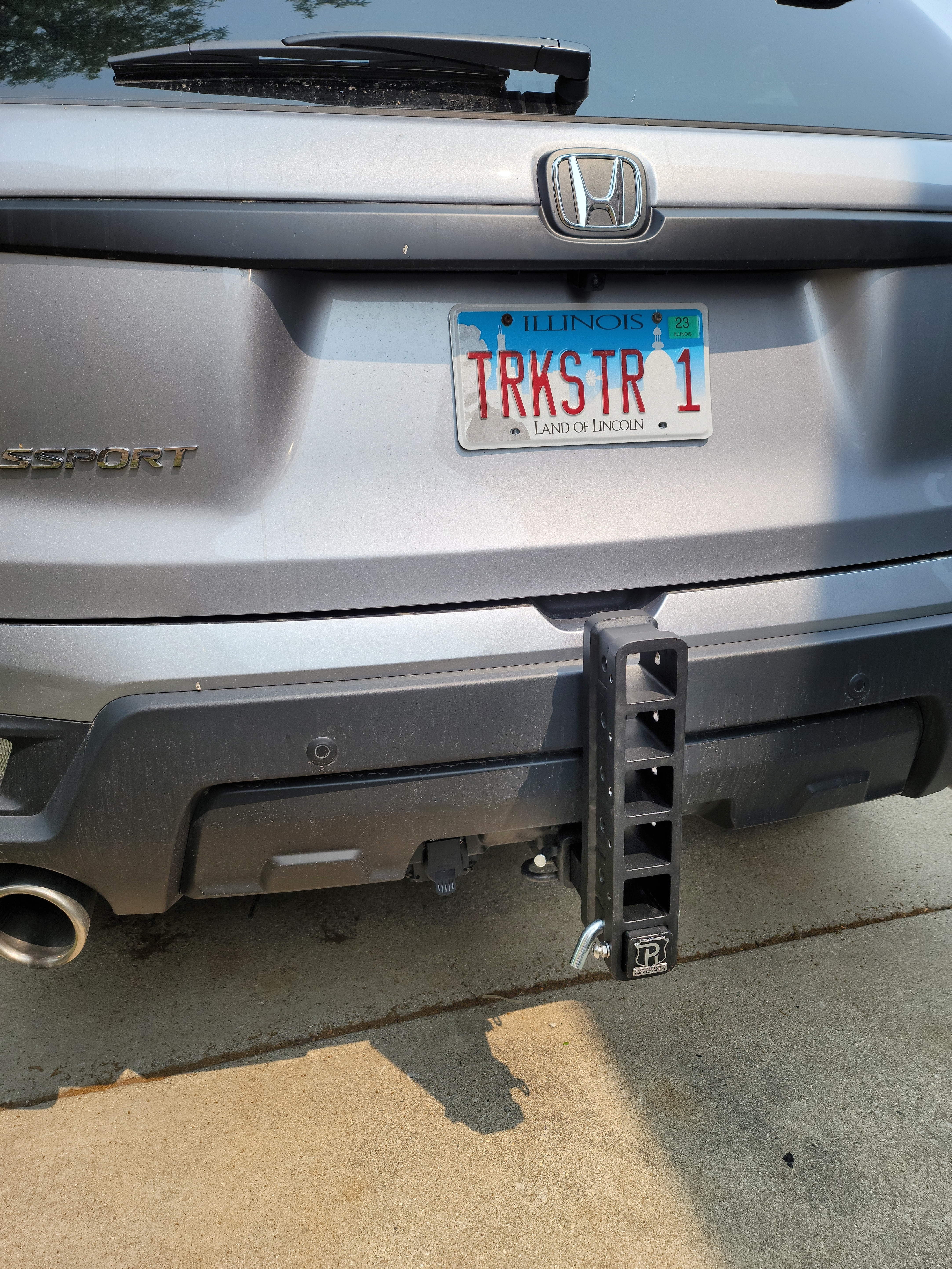

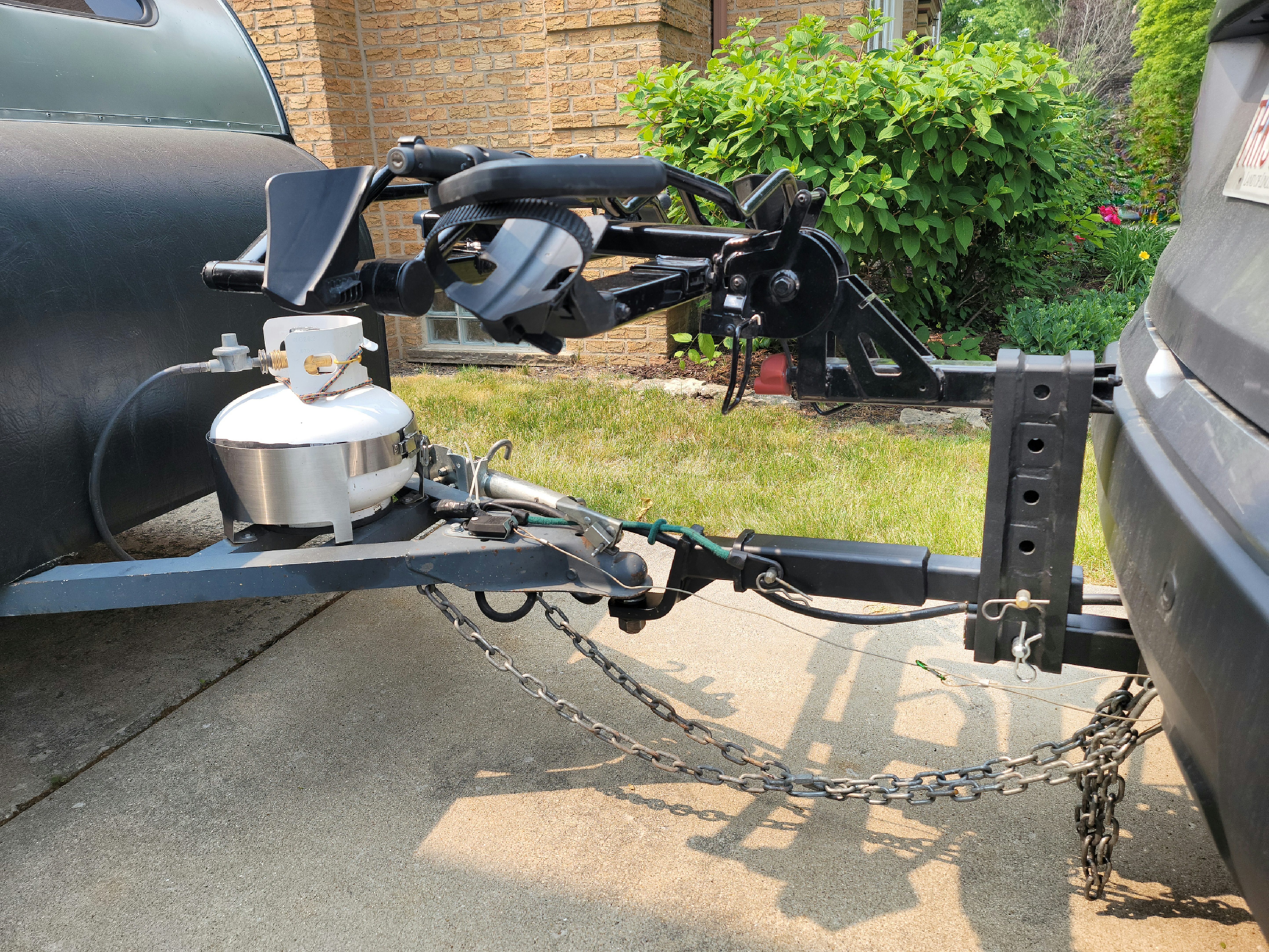

There are a couple posts here about using a combo hitch on TV, that the CI attaches at bottom and elevates another receiver high enough thatt the rack and bike clear the trailer and propane tank, if careful on turns...
Have you seen those?
Pretty nifty but all depends on your TV, do you need access in back, how, etc.

That's what I have gone to with the new truck. I wanted to get the bikes off the back of the TD so we could more easily get into the galley on the road, so I got the dual hitch extension so I could put them between the truck and camper.
The rack we have has the oval loops that the bike tires sit in, that can be adjusted for the length of the bike. I found that the square bar that the ovals are mounted to were coming close to contacting the TD when turning sharp, so I ended up shortening them so that they still had some length adjustment, but took about 6 inches off each end, which was enough to let them clear everything. I was able to take my Lectric bike to Oshkosh using that setup, and it worked well, allowing the tailgate to be dropped (but not the tailgate flexgate step). I was able to carry everything that we used to put into the cabin, into the truck bed instead, making the TD cabin accessible for rest stops en-route if desired, or if pulling into a campsite late in the day.
Here's what I ended up getting : https://www.amazon.com/dp/B081TTNSX4?ref=fed_asin_title&th=1
Unfortunately, I didn't get a pic of it setup on the truck during the trip. One thing of note was that the TD tongue jack handle wasn't usable with the bike in place however.
That's what I have gone to with the new truck. One thing of note was that the TD tongue jack handle wasn't usable with the bike in place however.
That's the 1 thing that led me to our current setup with the Patriot Hitch. But the cost then was nowhere close to what it is now.
