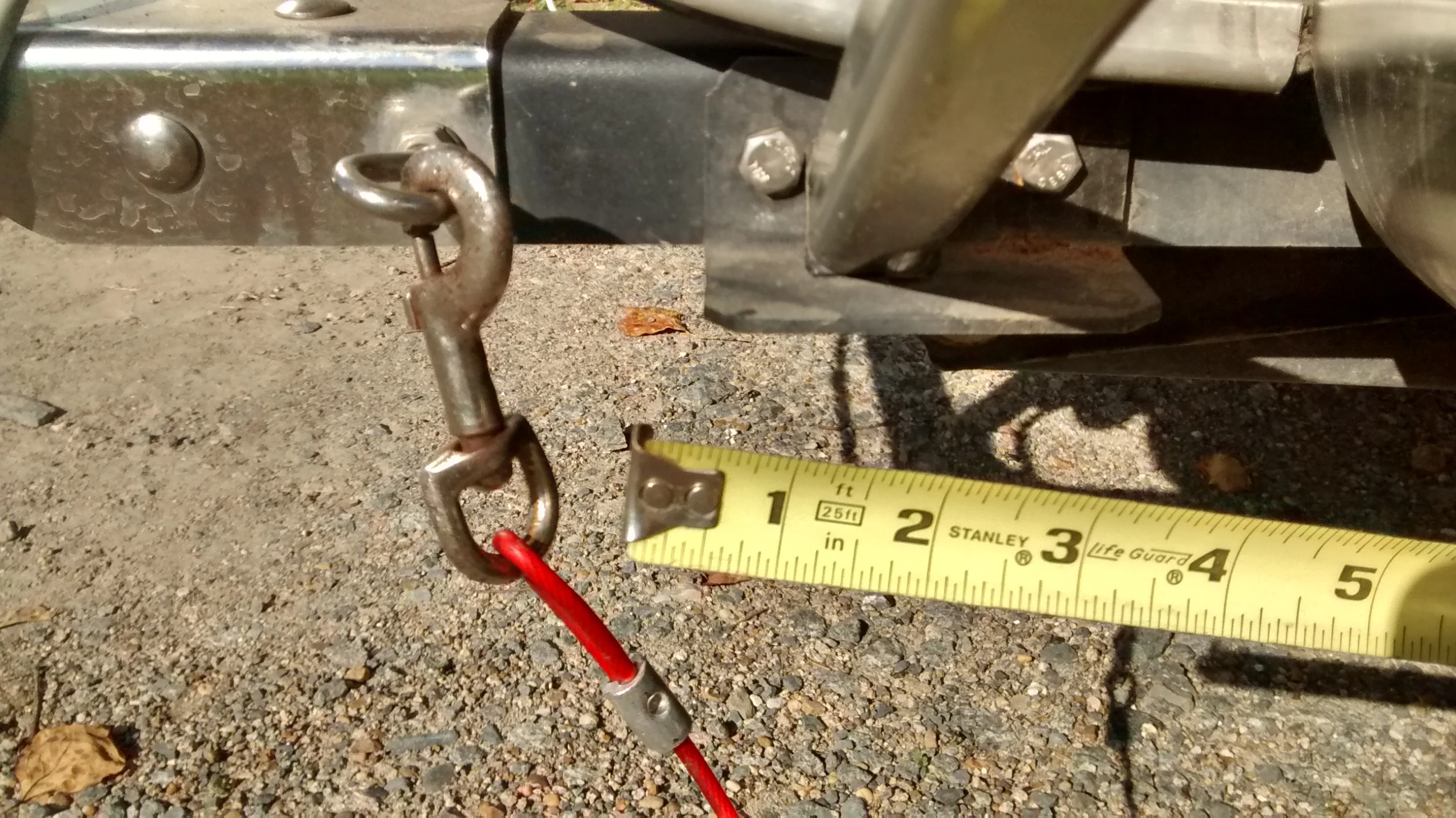

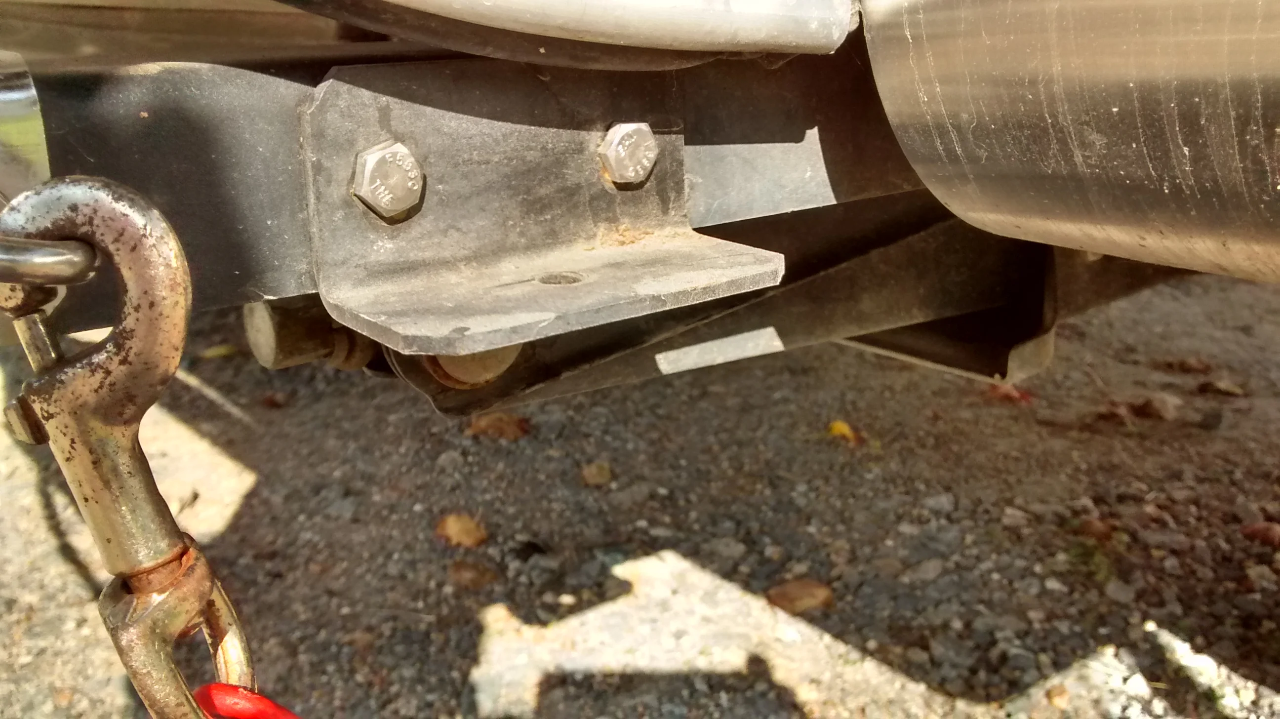

    Craig, being a born problem solver, went inside and fetched a piece of angle iron. He adjusted the leg of the side table to the middle hole. We then attempted to keep the side table level while he determined if attaching the angle iron to our frame would work as a place for the table leg to sit against, allowing the leg to act as a strut to support the table.
    It was possible, so he went inside, and cut the angle iron down to around 3" long. When he came back, we slapped our level on the table while he refined where to position the bracket. He then drilled two holes through the angle iron and frame, slapped on two bolts, and viola! Our dog can no longer pose a threat to our refrigerator!
    The one word of caution is that the side table can be an inviting place for someone to come along and lean against, or for a kid to climb on. BAD IDEA!! That sort of stress MIGHT be sufficient to either pull the screws holding the table brackets away from the side of the camper, or create a sufficient lateral load to do something similar to the six screws that hold the leg bracket to the bottom of the table. To minimize the chance of the former, we drilled out the topmost screw hole of the forward table bracket (the one closest to the tow vehicle), replacing it with a 2" long stainless steel pan head bolt and nut (I think it was a #10). The hole thus created came through in the battery compartment, where it was easy to access and tighten down. It is possible to do likewise with the topmost screw of the other bracket, but good luck with seeing where it comes out in the battery compartment, as it will be hidden by lots of wires and stuff. So we only did the one.

    After more than six months of daily use we noticed that the topmost screw of the rearmost table attachment on the camper was starting to work its way loose a little. The topmost screw of the other attachment we had replaced with a 2" bolt, so it was unphased by the extra load that has been created by using the side table leg as a strut.
    It seemed it would be prudent to replace the loose screw with a bolt. Toward that end, I removed the LED taillight, thinking it would be possible to drill through the original screw hole. Wrong! The wood at the corner of the camper is over 2" thick, which was longer than the drill bit that I had available. And it is doubtful that I could find a #10 bolt any longer than 2 1/2". So instead I replaced both of the original screws (which were 3/4" or 1") with #10 X 2" stainless steel oval head screws (the longest that I could find locally).
    I suspect that with this additional modification that it is possible (though definitely not advisable) to now do a table dance atop the side table.
    One other modification that we made was to put two #10 stainless steel washers between the strut bracket and the trailer frame. By shimming that out by 1/8" or so the side table is much closer to being level.
