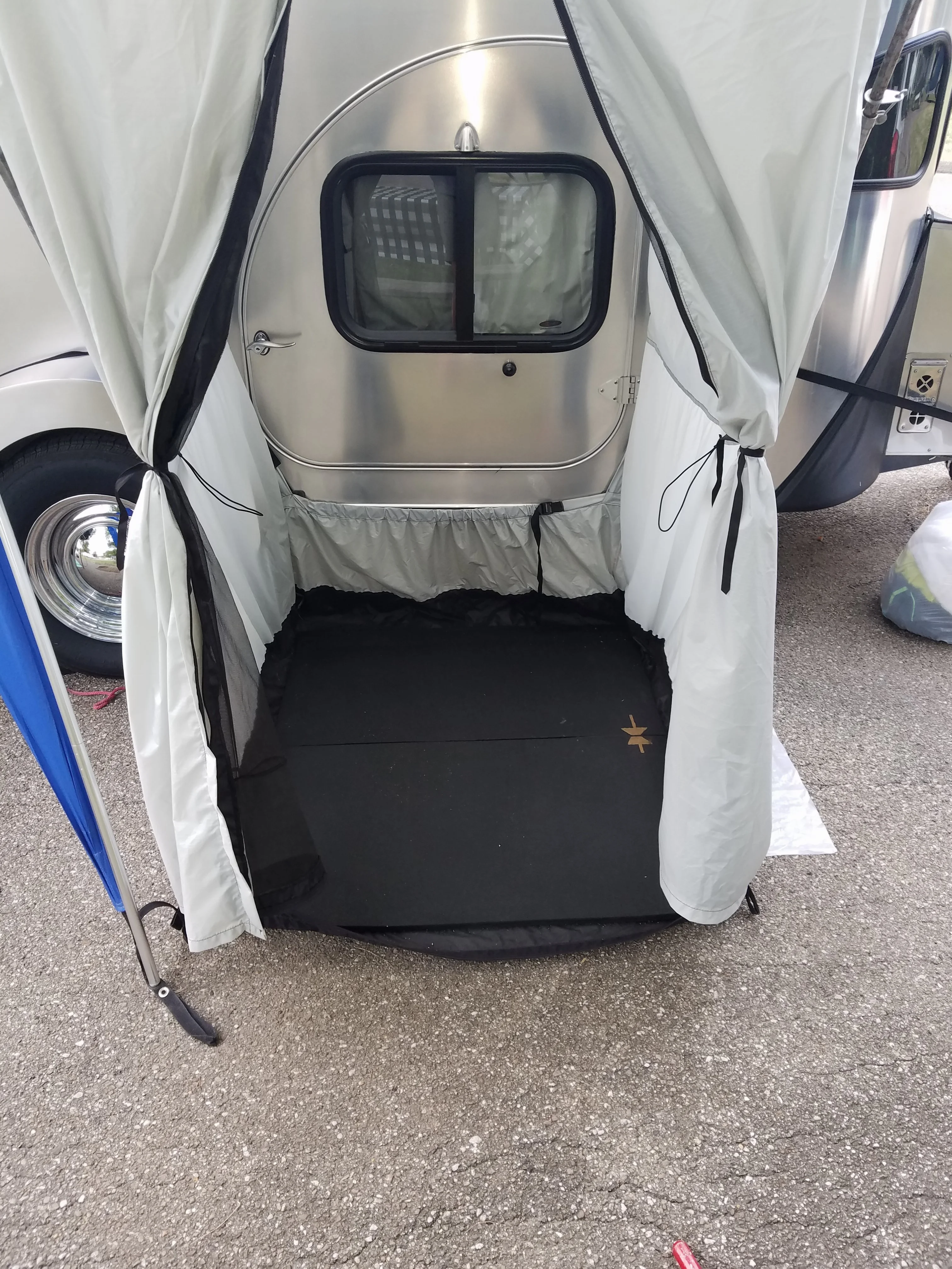

We have had several occasions where we camped on a concrete pad and would have liked to use our CI side tent. I didn't like the idea of using sand bags. My solution was to use a rubber stall mat. I used a 1/2 inch thick rubber stall mat that measured 3 x 5 feet and cut in two sections each 21.5 x 36 inches. Combined they weigh 25 pounds and lay nicely inside of side tent and keep it very stable on concrete. It has not been wind tested but our first outing with it went well. They both stack nicely in the back of our Outback and take very little room.

So I looked into hiadventurer's solution using a rubber mat. I found 3/4 inch thick rubber
flooring. Cut to the size of the side tent floor (42x36), I figure each mat will be around 40 pounds, which I think should hold the side tent in place even in gusty winds.
