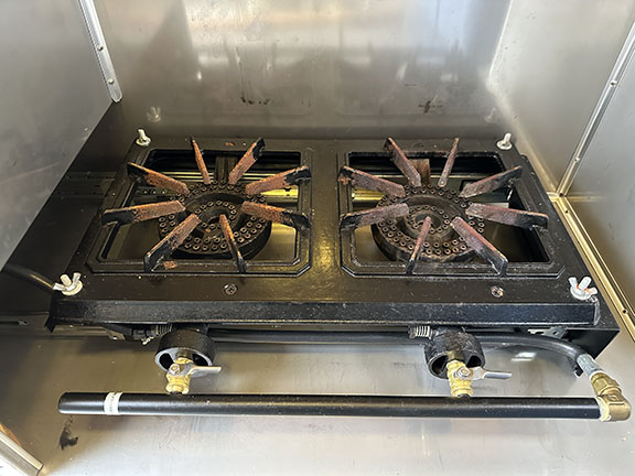

  16. I'm resurrecting this one. Ours needs a facelift:
    I'm torn between the two options described above.
    Sweeney: Is it too far gone at this point for a beeswax treatment?
    Painting options run the gamut from a full paint strip and re-do (maybe in a different color), to just masking off the surround (the enamel of which is still shiny and in good shape, once you get the grease off it) and painting the supports. I've discovered that paint formulation choices can run from what I would imagine to be pretty near near useless spray bomb stove paint from the hardware store, to 2000 deg high-temp automotive ceramic coatings for manifolds that are expensive, time consuming and involve numerous steps, prep and multiple bakings. I was looking at POR-15 and VHT Flameproof products. both of which fall on the upper end of the scale. Any feedback on success/failure/ futility in this area would be welcome.
    I was also going to get the Carolina Cooker (Ken and Peggy's post) if only to switch out to the needle valves. We find the that the ball valve adjustment on ours to be very finicky and difficult to dial in accurately. (The CI valves can go on the new one for an outdoor cooker that doesn't require such fine adjustment.)

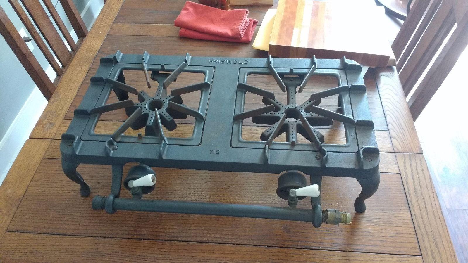

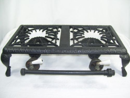

    I am also curious to know if anyone has attempted a vintage refurb retrofit cooktop, like a Griswold, mounted on the factory slide-out?:
    This would obviously have its challenges, such as a proper refinishing of the cast, mounting hole placement, and the possibly necessary orifice conversion from natural gas to propane. I don't believe that overall dimensions, generally, would be an issue.
    CI obtained the best cast iron cooktop for the build that they could; it out-shines all the other mojo-lacking modern stove slide-outs that you see in TDs. However, it can't hold a candle to some of the more ornate castings of yesteryear. This might end up being a longer-term project after I get the current one back up to speed.
    On a closing note: the factory wingnuts that hold the cooktop on were obviously placed that way for ease of removal and cleaning. However, they can be reversed with a little more difficulty, if you consider them a bit of an eyesore.

  19. Thanks Rotus8. Just worked my way through this: How to Build an Electrolysis Tank for Cast Iron Restoration. They make it seem easy enough. But I defer to your experience.
    I'm somewhat apprehensive to embark on (but am still leaning toward) the expense and effort of a "pro" ceramic coating, as you suggest, even if it's just doing the pot supports. Stripping and re-doing the whole thing in a completely different colour might make a tad more sense. In for a penny...
    The million $ question is: Can a home DIY job improve upon a Chinese factory enamel? Maybe, if done right, I suppose. Pretty sure I can get the first two coats baked on in the BBQ at the lower temps. Where to pull off the final 600 deg baking is much more of a head scratcher. (I'm using the VHT Flameproof directions here; Jet-Hot might be different in their application).
    Even two types/colors/qualities of paint might work, since it's only the supports that really get the heat; the outside frame could get a nice contrasting color:
