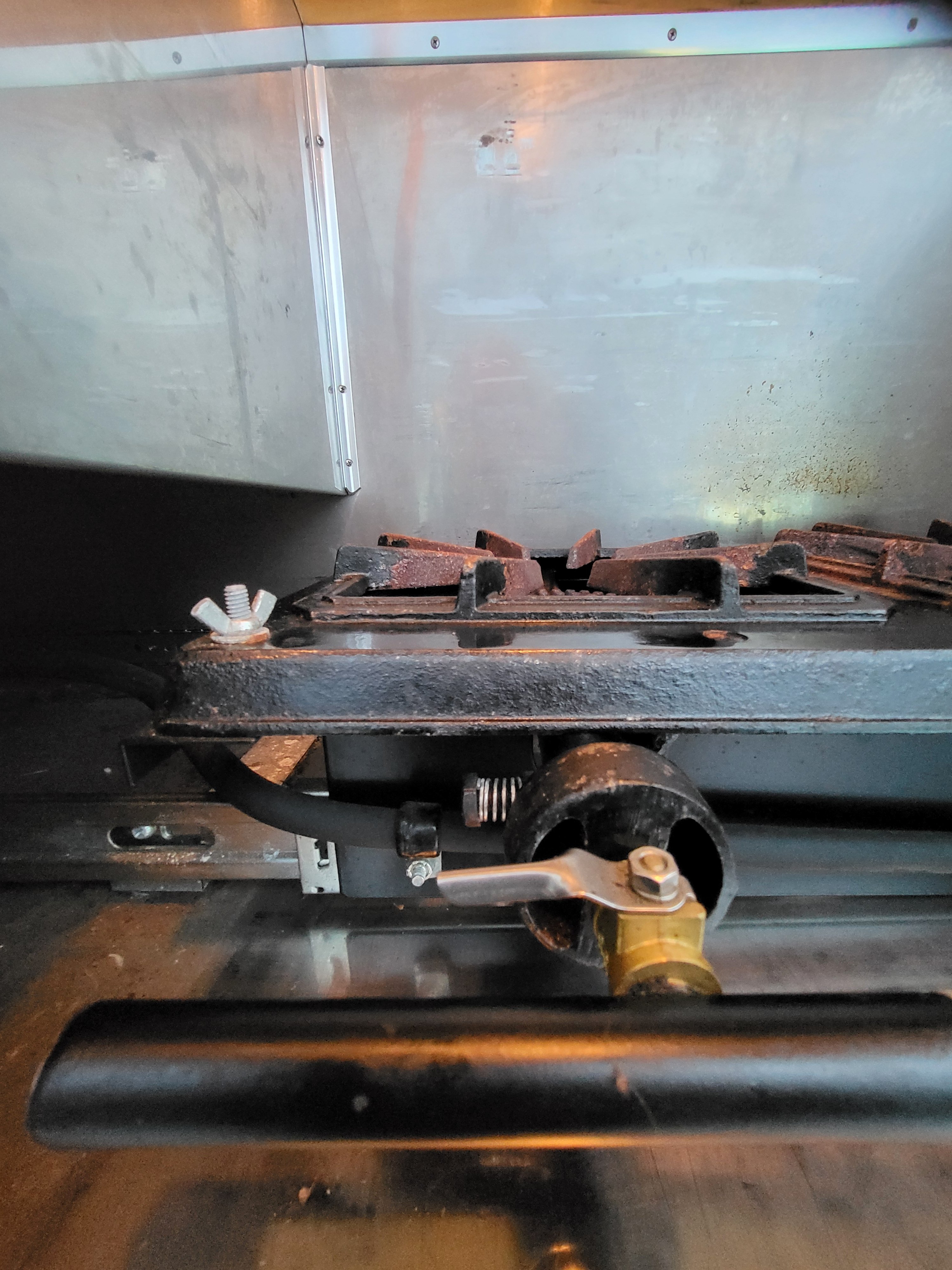

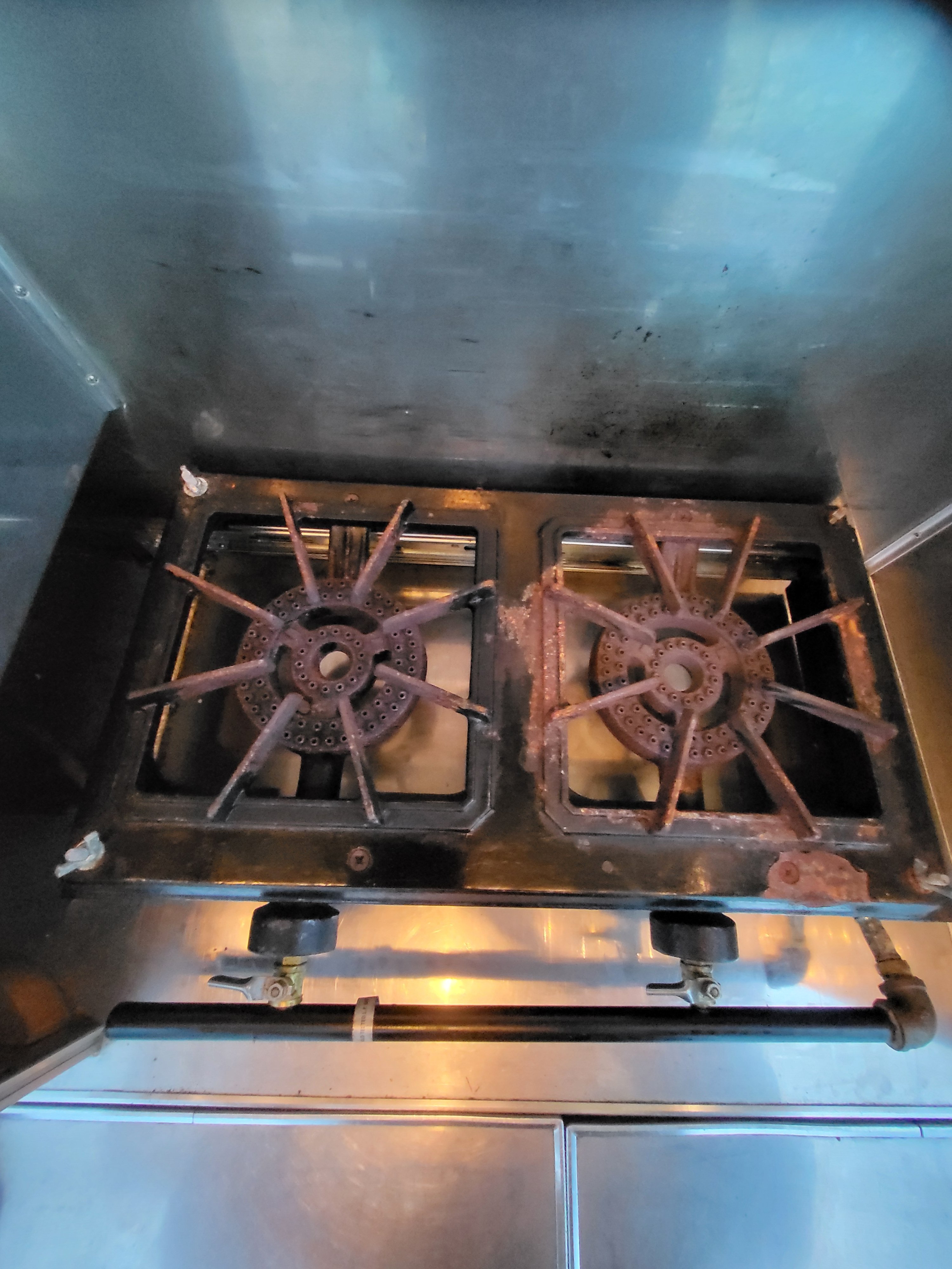

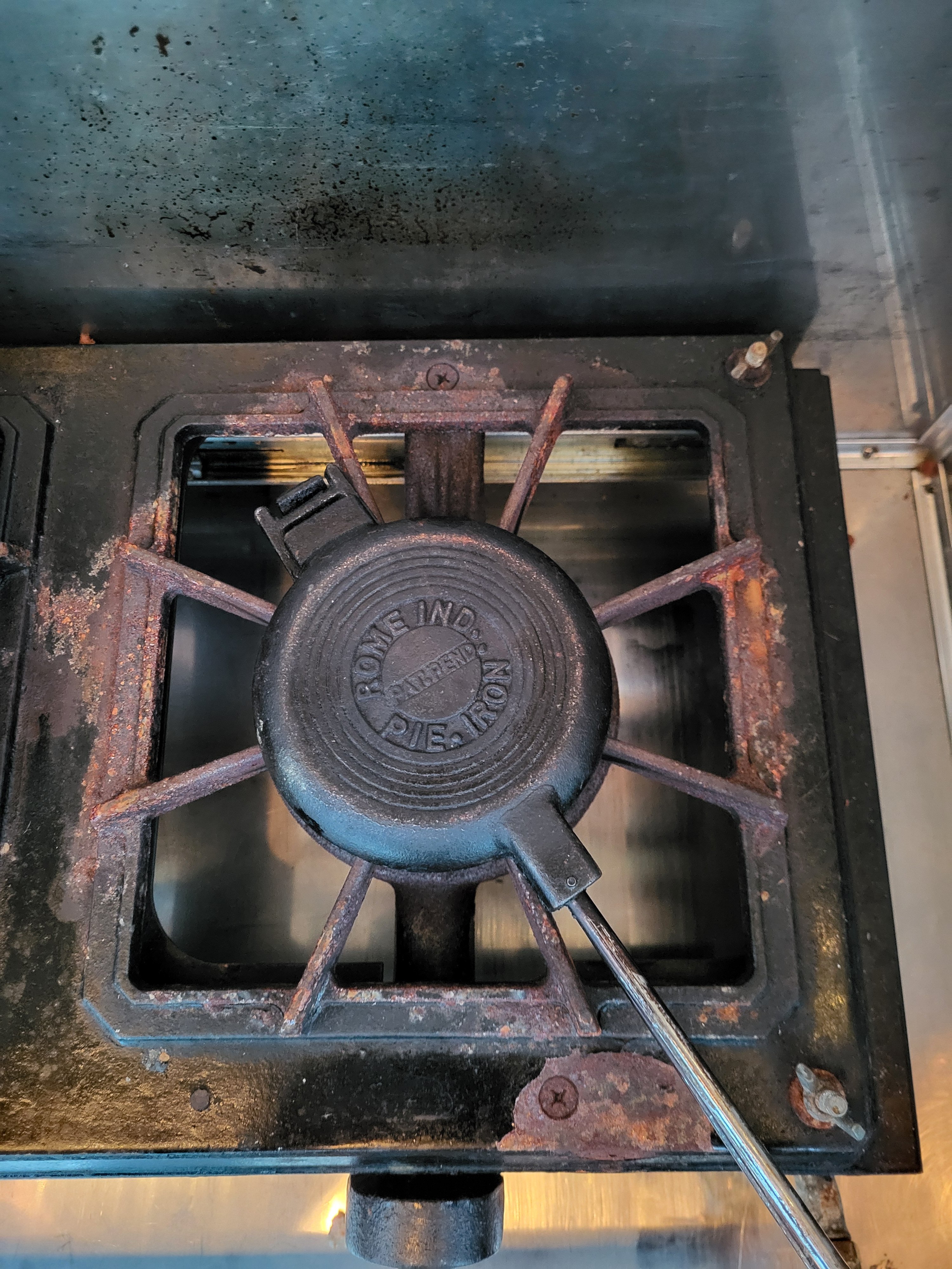

So this can also go in campers confessional. I rolled out the stove this morning and found all this rust. whew! Any one have some advice on how to clean this up? Thank you!

Or, do what I did. It doesn’t look new now, but certainly fits the rustic kitchen look!
Empty the supply line of propane by turning off the tank valve while the stove is burning.
Hit the wingnuts & screws with your favorite penetrating oil.
Come back the next day, apply more penetrant, and take it apart.
Use a powered wire brush to clean up the rust. A cup-style brush on an angle grinder is excellent, but a wheel brush in an electric drill would work too. Do this away from the galley!
Spray a little high temp cooking oil (avocado!) on a paper towel and rub in the lightest possible coat. Some of this will later evaporate/burn off.
Put it back together.

When I'm getting to it with the elec wire brush tool I expect it will be taking off the paint around the edges?
Any paint that the rust has lifted will come right off. The rest is up to you, you can be selective with your brush.
