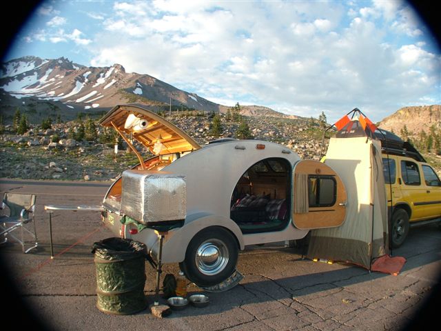

    I wonder if this cover on Ron's cooler is a custom built item, or something readily available?

    I made the cooler cover using insulated duct wrap held together with metallic duct wrap tape. Both are readily available at any home improvement center. The duct wrap is highly reflective and is a great insulator. It makes the ice last almost twice as long in very hot weather. Kind of a pain in the rear to have to slide it off every time we need to get into the cooler but well worth it if you are a long way from an ice source. Olga came up with the idea to cut out a 'hinged' trap door on top that opens with the cooler door to eliminate the need to pull the whole thing off. I'll be working on that soon. Bye the way, I've also made a cover for our Coleman stainless steel 5 gallon water cooler that works just as well.

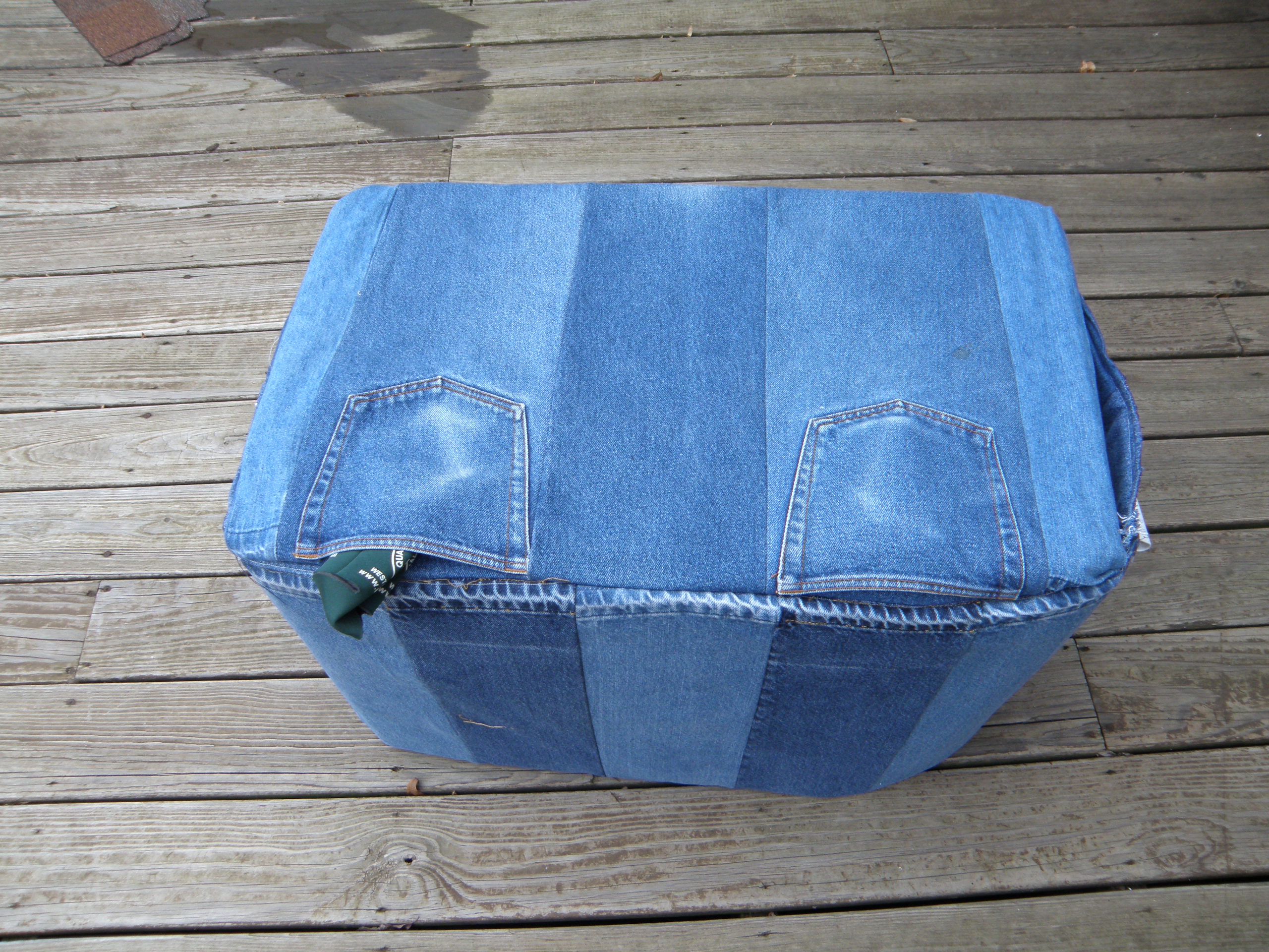

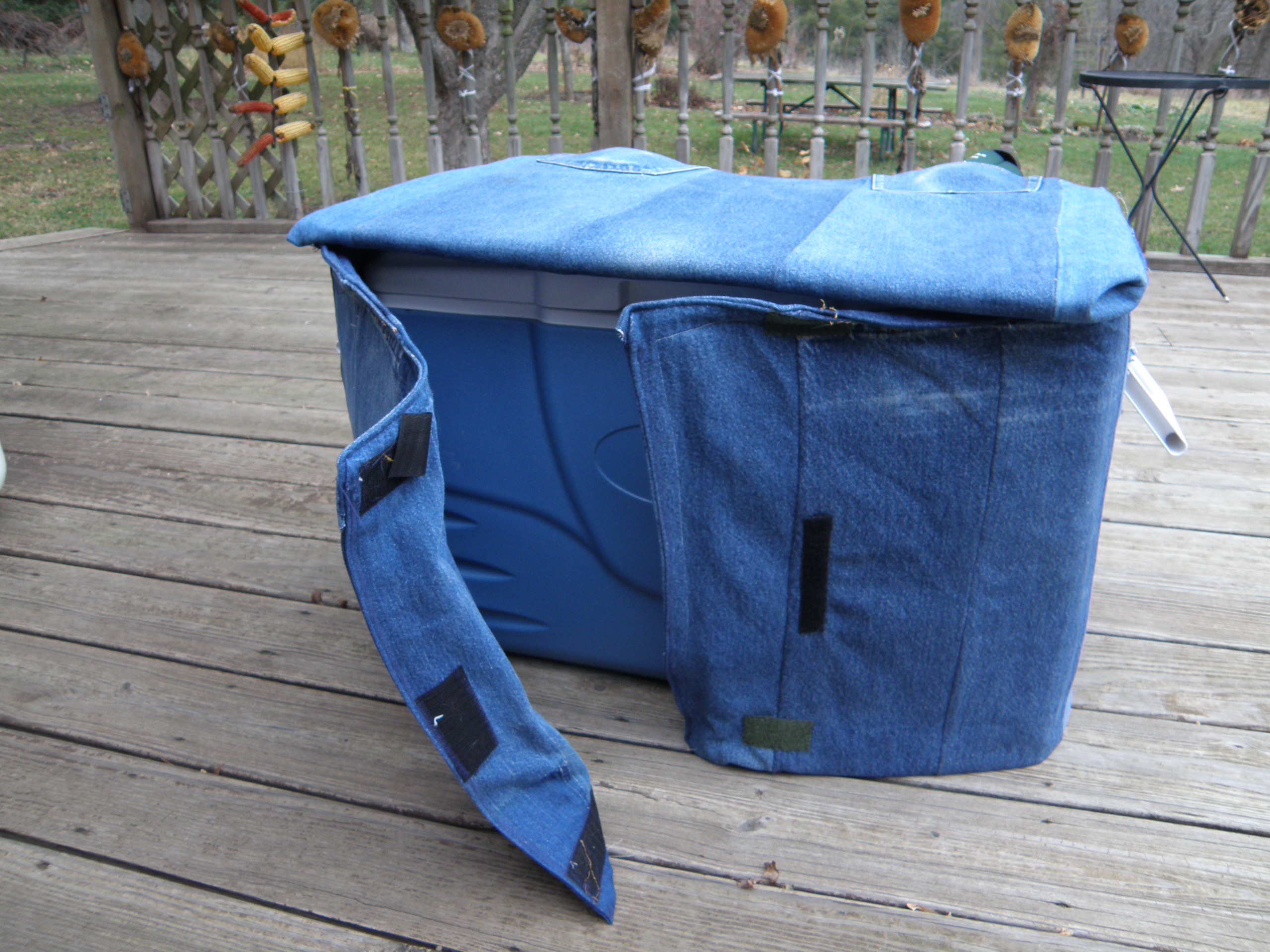

    So I am attaching photos from Oly of his cooler cover. He can chime in with the materials, etc. Just my two cents but I really like the pockets!

    Thanks for helping me out Gary,
    Becky made our cover. It is old blue jeans with a double bubble aluminized winshield sun blocker inside we got at a flee market for a couple bucks.Rather than have to take the cover off to get in the cooler Becky made it with a lid so. That way if it is in the vehicle with stuff packed around it we can still get in it. It is a wrap around with velcro to hook it together. Yes i like the pockets to, good place to put our cozies.
    The handles on the cooler fold down when not in use but also can be put through the cover to move the cooler.

    Oh, that's so cute. Looks like a little plumber at work...minus the fanny hanging out. So is it insulated? Give us a list of material, please. Been after Jim to get one of those.

    Sue, The cover is old (but clean blue jeans:D ) the insulation is a Sun shade that would normally be put in a cars windshield to block heat. The one we used was aluminized on both sides with double bubble air pocket honeycomb. Got it at a flee market for a couple bucks.
    p.s I thought her idea for the pockets was a neat touch. (minus the butt crack) :eek:
