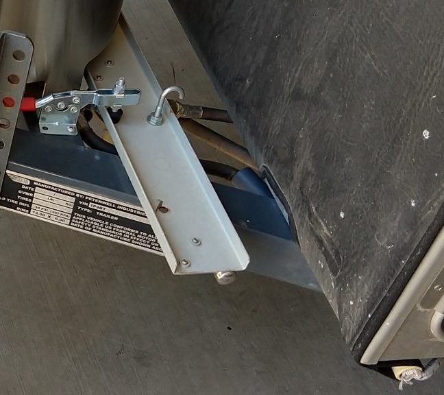

    Photos below show showed position of table extension and camping hardware used.

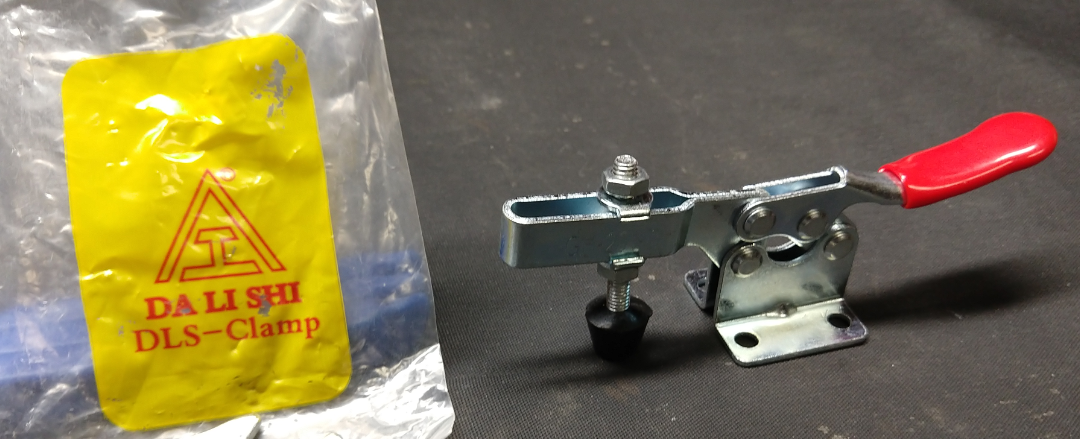

    The table extension is attached to the trailer frame, behind and under the propane tank (left photo). There are two clamps (right photo shows the detail of one), stamped GH-201-B (you can find on Amazon, searching with “GH-201-B Clamp”). One clamp is on each side of the propane tank, screwed to the frame cross member. I drilled and tapped holes into the cross member to secure the clamp with screws. I originally ordered 4 clamps (right photo is of one clamp never used) and the ones used to secure the extension as shown in the left photo have been in place since fall 2018, and travelled over 12,000 miles in 2019. The hook on the table extension is to hang a trash bag.
    I rarely use the table extension while one night camping going from point A to point B. However, the extension is well used during multiple night stays at a preplanned destination campground. The modification came about as I found that having the extension strapped to the table was inconvenient. It adds weight for removing the table from the stowed position and hinders setting up table just to get at the cooler to add ice and/or groceries.
