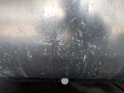

    This is some of the corrosion that was on the Time Capsule when I picked it up. It had sat 1/4 mile from the Pacific Ocean for 5 years without being washed or waxed. It had a cover that was pretty much disintegrated and went straight to the trash. I've started working on shining it up, but still have about 1/4 of it left to do. It is complicated because of the large decals and some brass accessories. The roof was also heavily scratched from having the ray gun and wind turbine set on top and slide around.

    Looks like you have your work cut out for you, but at least it looks like you don't have the stainless bumper to have to work around.:)You'll have to post some before and after pics.
    Just remember it's a labor of love.;)

    I have the bumper - 6 bolts hold that on. The bumper brackets were getting rusty, so off they came to get cleaned up and painted. The leveling jacks were more rust than paint - to hard to clean and paint, so new ones installed. Here are picts of the back with all the hardware removed, mostly sanded (only way to remove deep pits) and buffed and put back together. On the right side of the before pict - I did some polishing which removed the oxidation, but not the pitting.

    Huge improvement!:)
