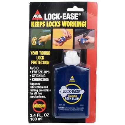

I agree, lubrication is the answer, but it seems to me that bicycle lube is the wrong thing. Lock specific lubrication has a thin solvent that carries graphite into the lock and then evaporates. Other lube doesn't travel well into the lock, and leaves greasy stuff that gums up the mechanism and captures fine dust. Something like this:
Thanks, rotus8. I suspect something got in the tumbler, it was just odd that it would it would also be difficult to pull the key out. After letting the lube sit in there for a couple of days and then testing it repeatedly it now works fine. But I think I'll get the Lock-ease.
