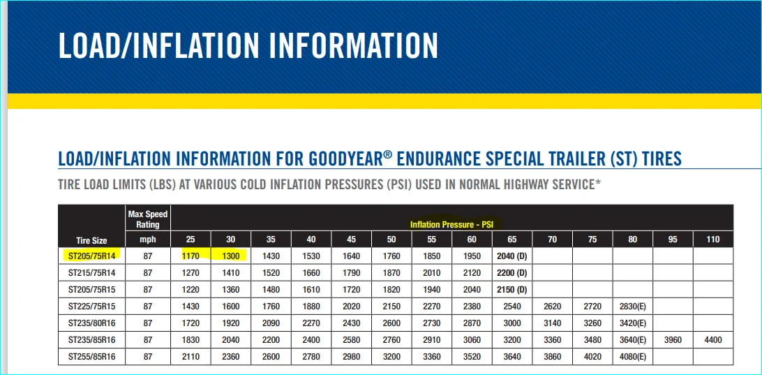

    Well I ordered (actually Cindy did) some Goodyear Endurance 205/75-14. They are ST tires and American Made which is also important to me. According to the Goodyear Engineer the ST are better belts for trailering, sidewalls, etc. On the upside, according to the Goodyear chart below, we are good to tow at 87mph :). (I hope everyone knows I am kidding). Speaking of kidding, I am surprised that no one suggested the Mickey Thompsons in my OP.

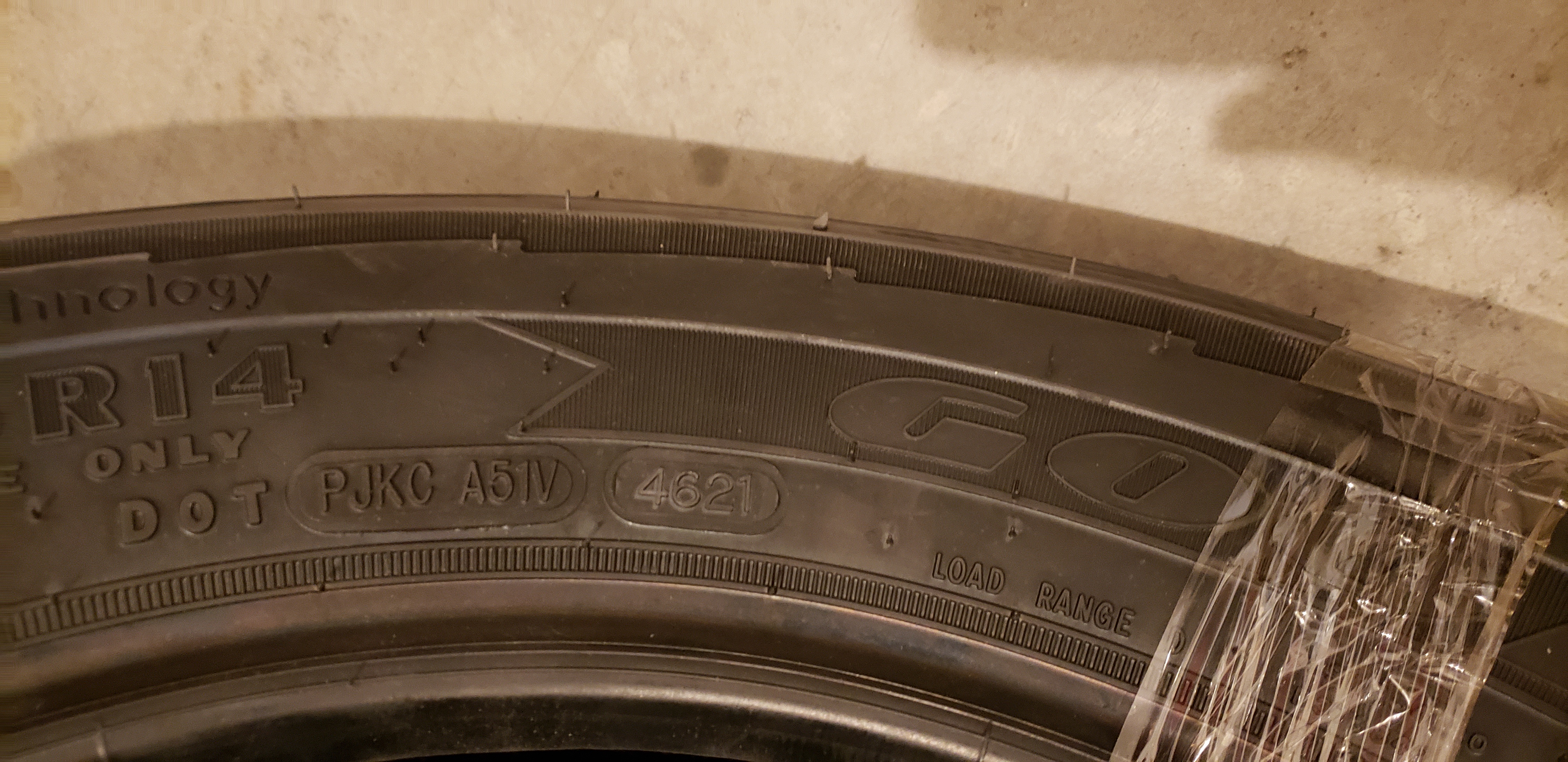

    Well today I received two Goodyear Endurance 205/75-14 tires from Amazon. I had read that sometimes Amazon tires are over 18 months old. The first thing I checked was the DOT date stamp. It is 4621 so they were made the week of Nov 13,2021. My existing tires look great for tread and no sidewall cracking but they are old. I paid $260 for the set of two delivered. That is cheap insurance for the next few years so we are not having a blowout on the road. Now to get them mounted and balanced this snowy weekend.
