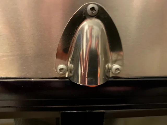

    There are weep holes on the bottom of the windows that will let water in when traveling at highway speeds. Getsome 'wax'ear plugs and put them in when rain expected while traveling.

    The little vent is just above the window. Can allow water in when towing in rain. Thus the ear plugs.

    I see above you believe the front windows are leaking. The weep holes are on the bottom of the side widows.
