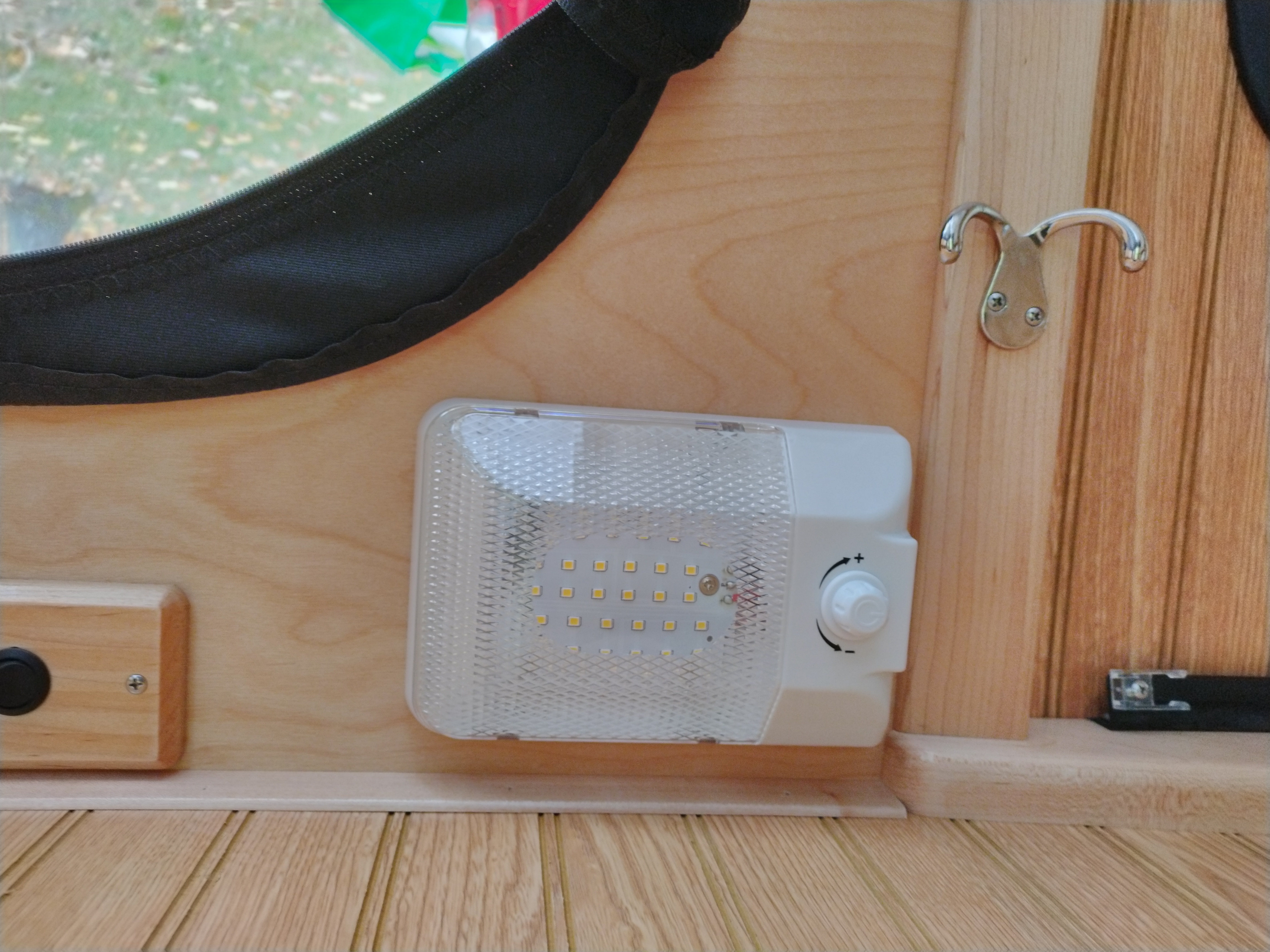

  1. When we got the Classic 560, we were trying to save $$ in certain areas. Opting for the plastic "RV" lighting over the Zenons was one area. Over time its basic look and dull diffuse lighting and "budget" appearance has not worn well on me.
    I switched the #1156 incandescents out to LED bulbs but still was not satisfied.
    Unable to find a decent-looking chrome LED fixture, I have settled on these as an upgrade, if not much in appearance, then certainly in performance:
    The galley light has 3 temperatures (cool, natural, warm) and is dimmable. Both sides come on together. The single cabin light is dimmable as well but has one temp. The double cabin ceiling light I kept the same single temp as the wall lights, but it has a rocker switch similar to the factory model (1 side on, 2 on). I couldn't find anything with a red light for night vision like the Zenons do. All are noticeably brighter at max than what they replaced.
    These are easily switched out as they occupy the same real estate as the factory ones, but with different mounting hole positions. Similar to factory ones, you may not be able to use all the mounting holes owing the large access hole in the wall panel that is necessary for feeding the wires and tucking in the connectors and marrettes. It still mounts flush and solid even with 3 screws. The 2-sided ones in the galley and the ceiling don't have this issue and you can easily use all 8 screws. I didn't detect any wiring under the skin that could pose a problem in any of these areas.
    Made by Blue Fire: https://www.amazon.com/stores/page/...2729-0c4c-45c3-a30e-ce5b6f106d09&ref_=ast_bln
    These will do until there is another enhancement in RV lighting comes along in 5 years.

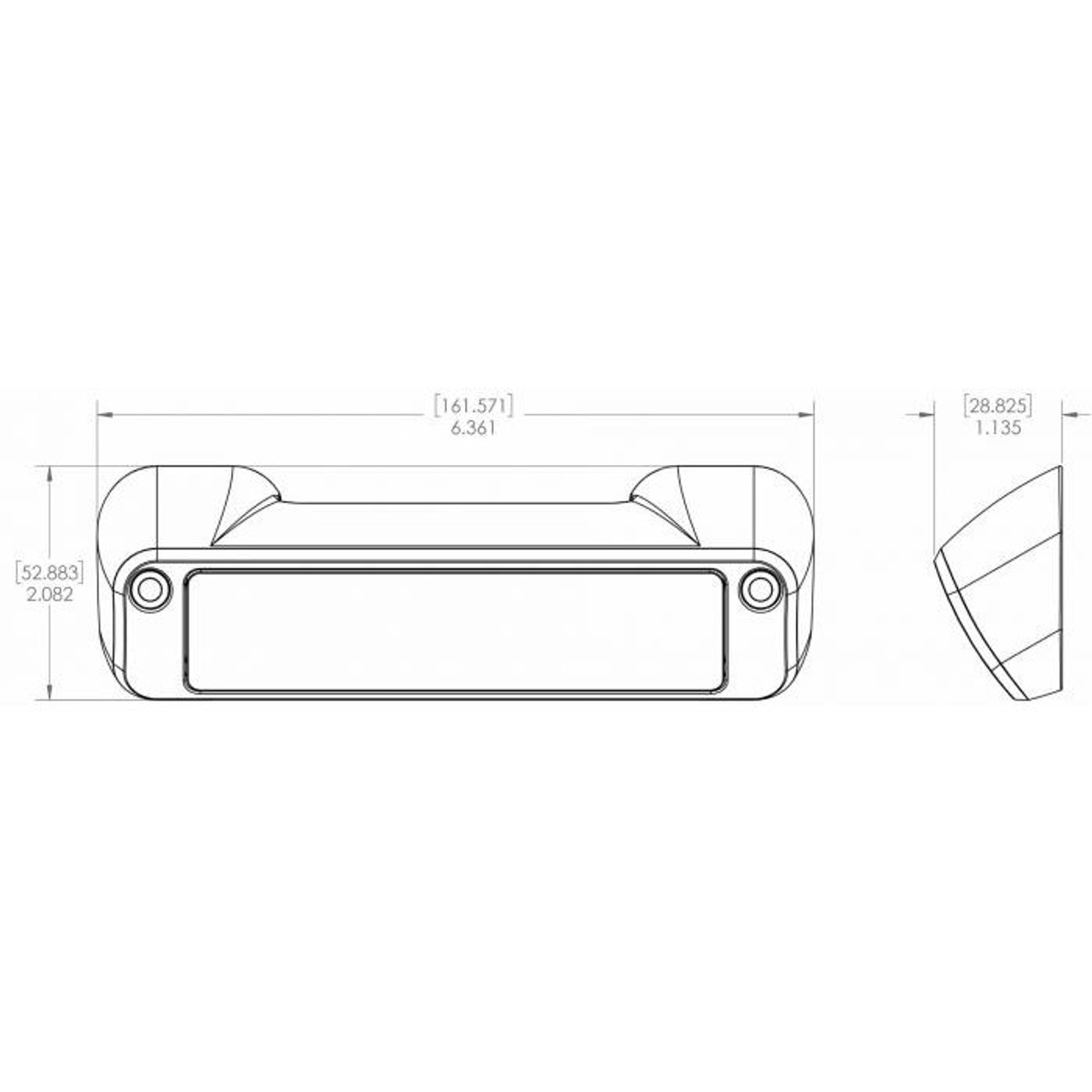

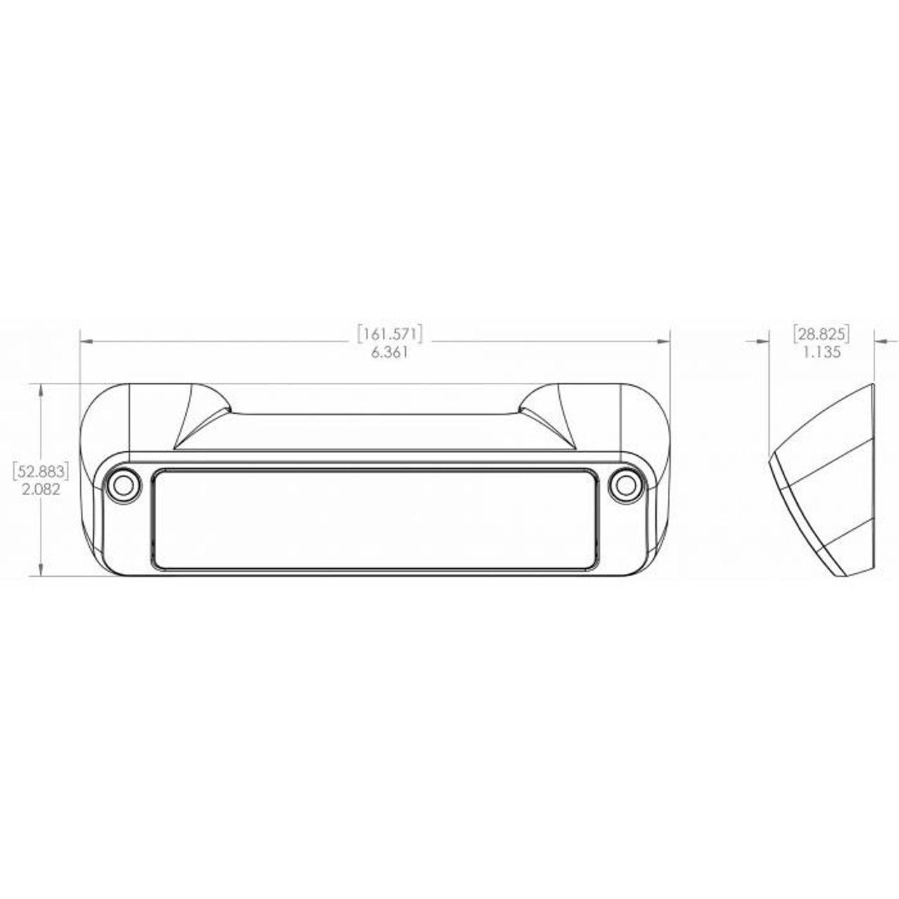

  4. This may be more what you were thinking: Perimeter LED Flood Light - White Finish/Chrome Trim. Comes in "cool white/red". Not sure how you'd switch the color choice though. 3-way toggle?
    1000 Lumens will light up the next 3 camp sites.
    Dimensions:
    Kevin and SethB like this.

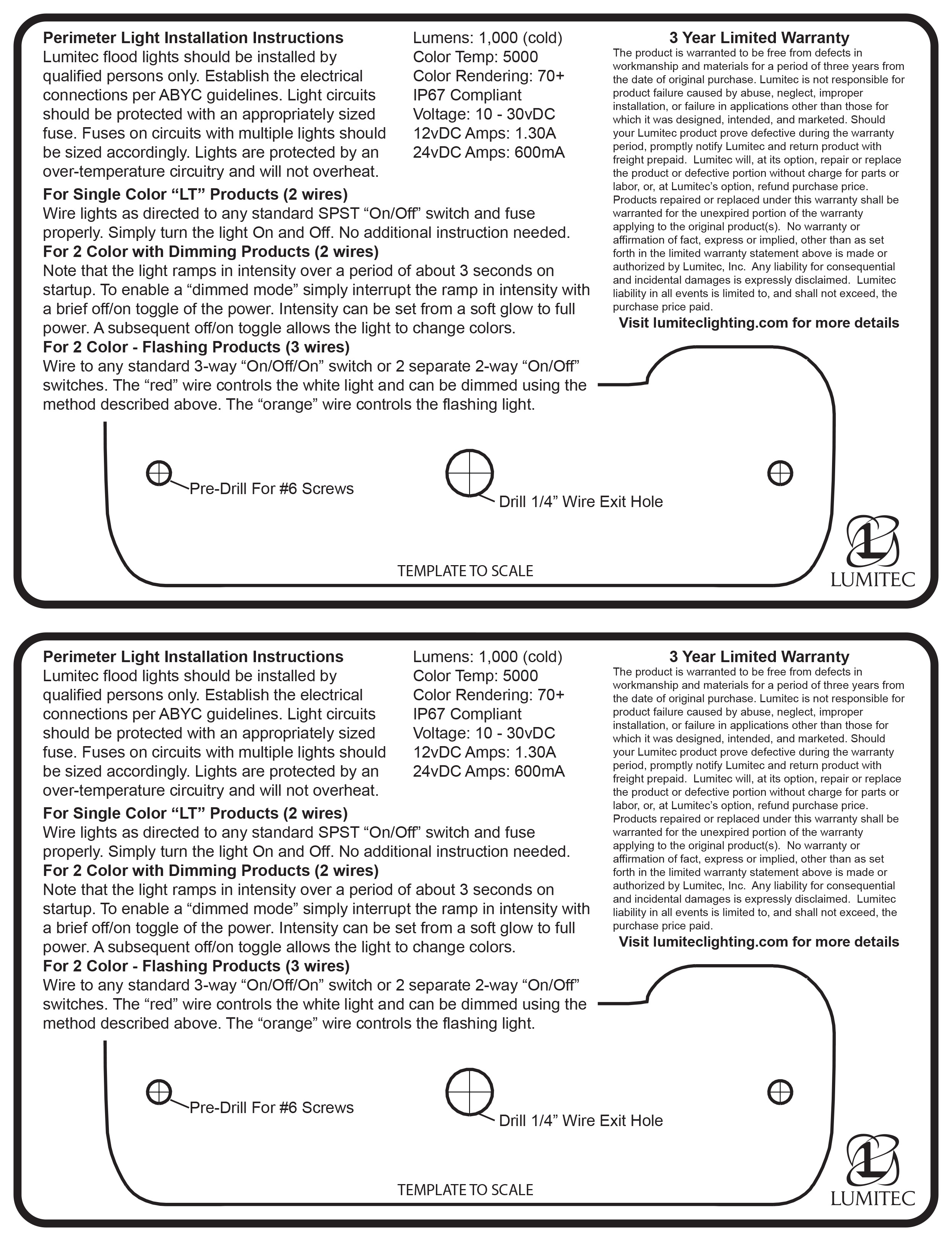

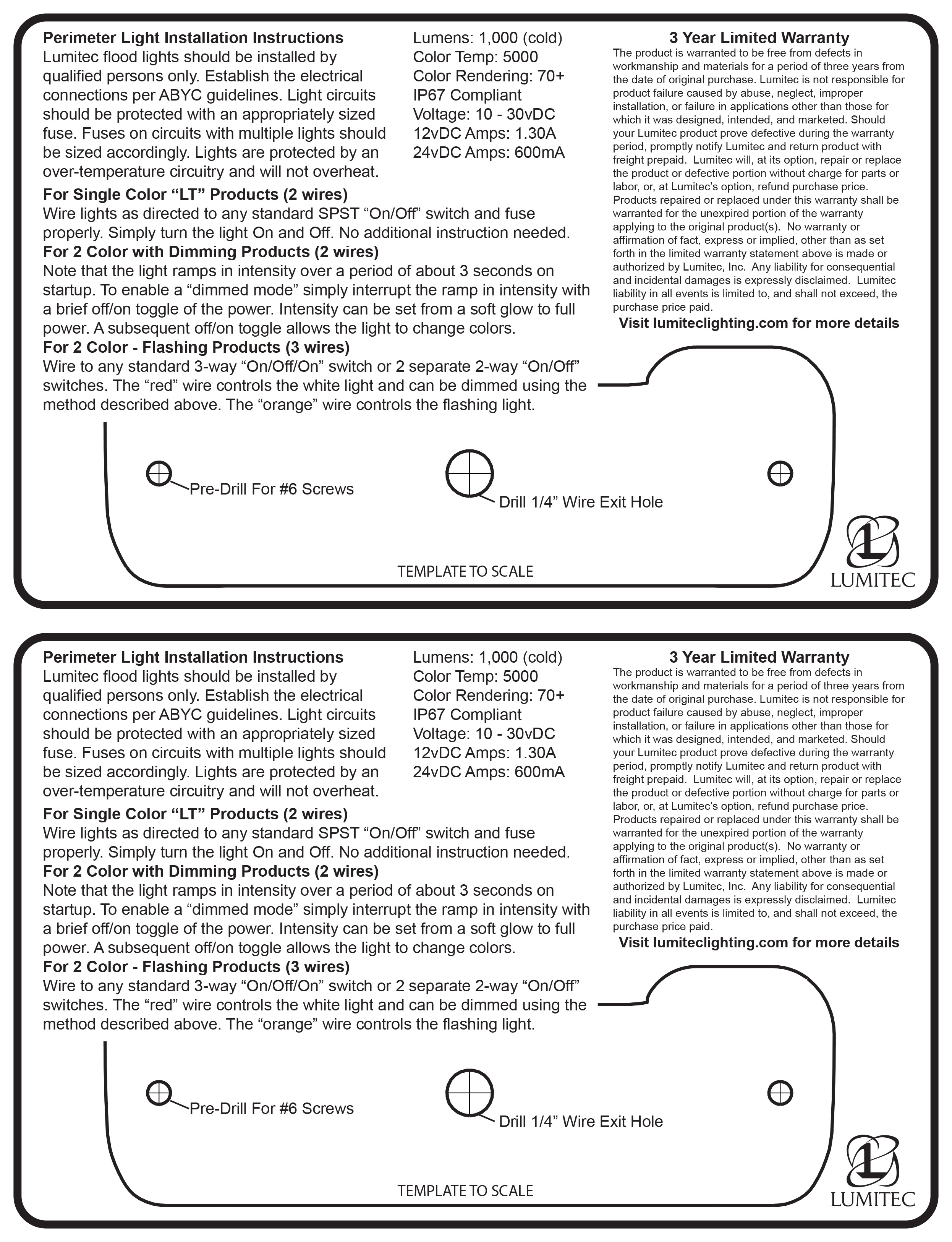

  8. Seth: I discovered that the Lumitec light is available in white/ red with both colors dimmable. And it's operable by way of a single pole toggle, if I read the following install sheet correctly:
    The install keeps hole-poking to a bare minimum.
    Far greater utility than I had first imagined. But still doesn't do anything about the price. Unless we win the lottery.
