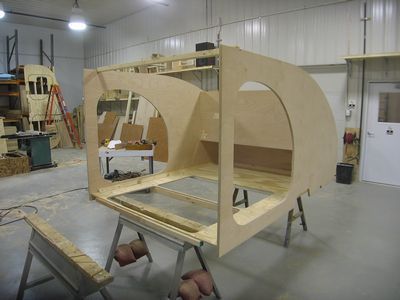

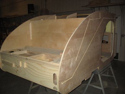

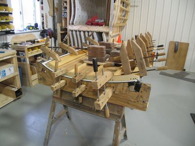

    The body assembly is started on the side to help keep everything square.
    Then it is put on saw horses.
    Working on the kitchen area.

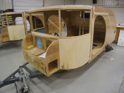

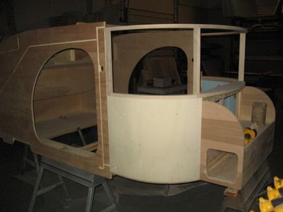

    Assembling the front.
    Finishing the front assembly.
    The kitchen is complete.

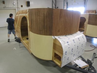

    The assembled body is varnished on a rotisserie so we can reach every surface.
    The varnished body is ready to mount on the trailer frame.

  10. Oysterpot
    I see by the photos that a lot of glueing and clamping takes place. Do you use fastners along with glue, or just glue. What kind of glue? Hopefully not asking trade secrets! ;)
  11. Cary Winch
    Cary Winch Camp-Inn Staff
    George,
    Glued and fastened. We use all Urethane glues on anything even resembling structural.
    Cary

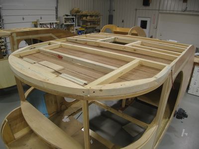

    The roof structure is added

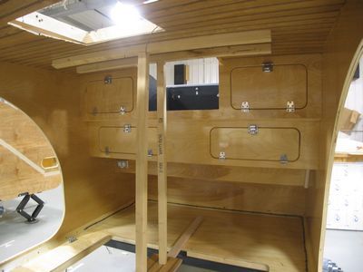

    Interior cabinets are hung

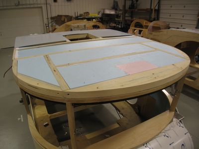

    The roof is insulated

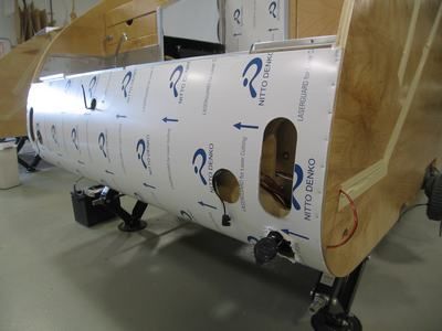

  15. wonko
    wonko Novice

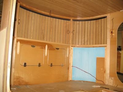

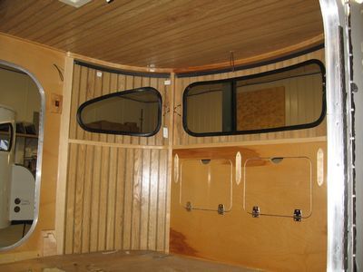

    Here's what there is for week 4. I must admit to a small shock of fear when looking at picture 19 (The inside is panelled.) It sure looks like no windows are planned to be installed, but they must cut holes in the installed panels at a later step.
    The front is covered.

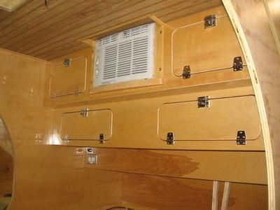

    The air conditioner is installed.

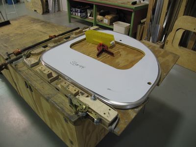

    Rear roll pan is skinned.

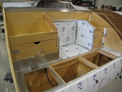

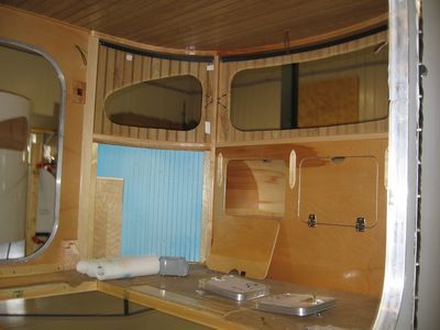

    Stainless countertops are added. Kitchen cabinets are assembled and installed.
    Stove is mounted.
  16. Steve & Ellen
    Steve & Ellen Novice
    So you wanted windows?..LOL :)
  17. Evan
    Lyle - you forgot to ask for the window option???
  18. wonko
    wonko Novice
    OK, looks like I ordered the window option :D

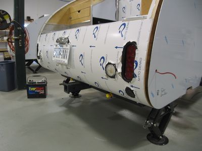

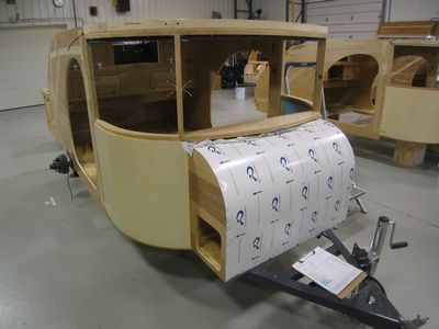

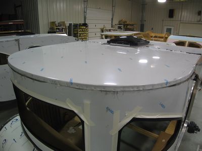

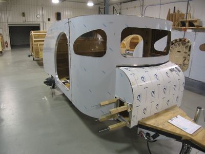

    Tail lights are wired.
    Front and sides are skinned.
    Hatch is assembled.
    The roof is skinned.
    the lower front is panelled.
