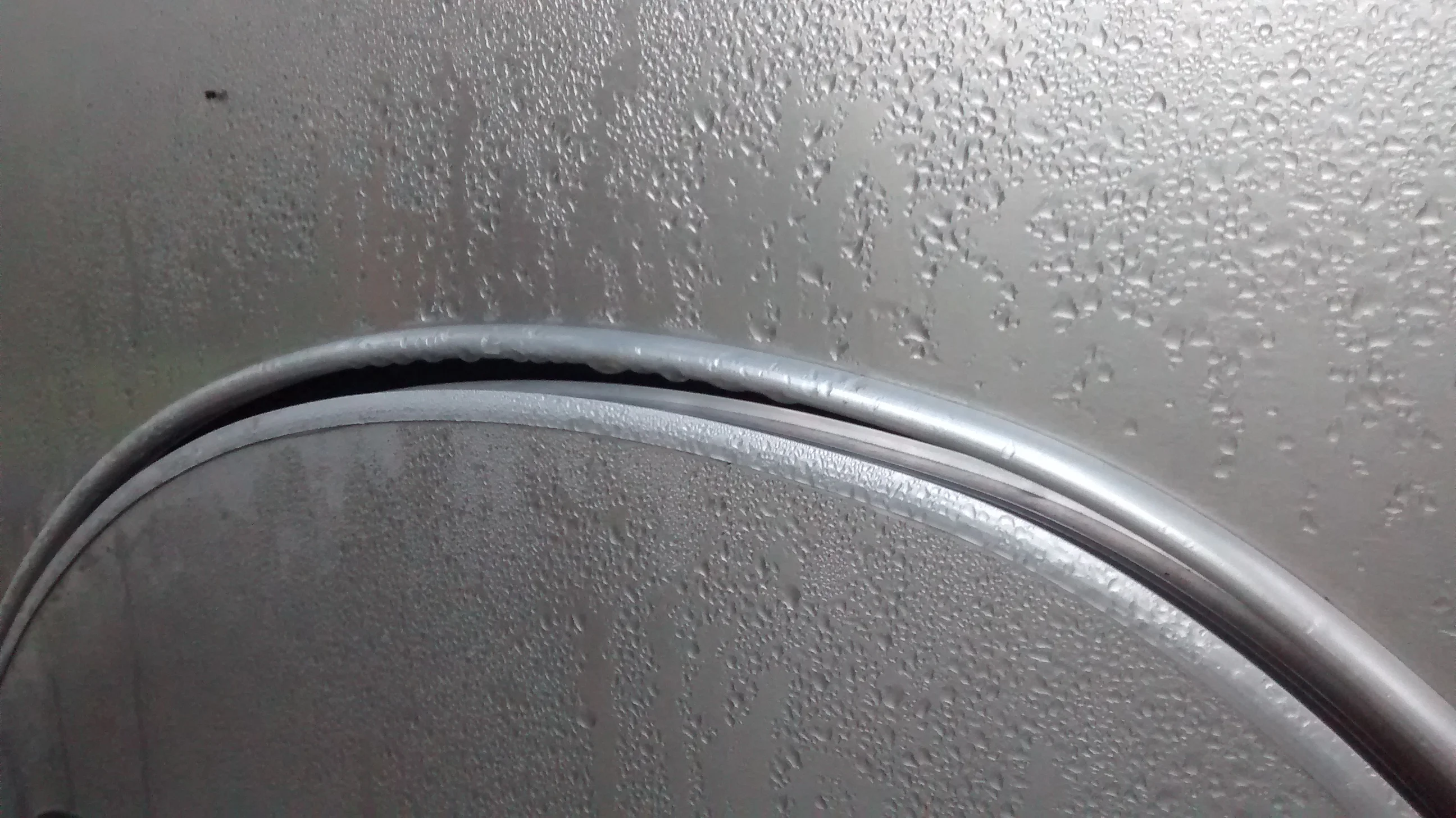

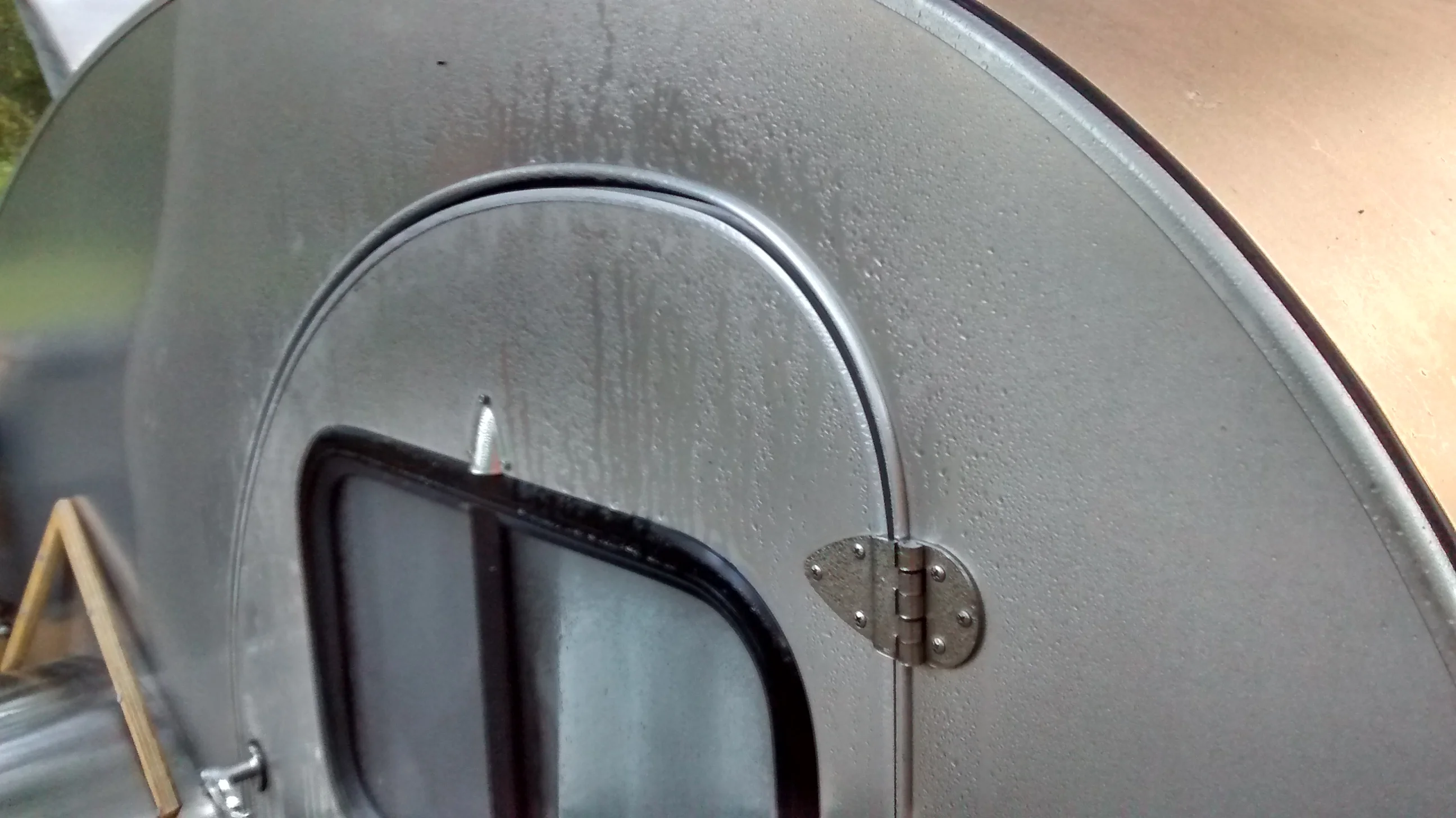

About a year ago, another Camp Inn owner with a trailer of similar vintage to ours cautioned us to keep an eye on the area where the Alcan cover folds over and is attached to the underside of the cabin floor, as water can get trapped there, causing the floor to get wet. We did so from time to time, and for nine months of traveling we saw no signs of any such issue. But then we spent far too long in some sweltering heat and humidity. One day I happened to notice that the Alcan flap on the curbside of our camper was sopping wet, and there was a huge amount of condensation on the bottom of the cabin floor in that corner. We checked inside and found the wood of the cabin floor felt as though it was absorbing moisture. In this case, we had been running the air conditioner so much in order to stay cool that there was significant condensation forming on the cabin skin. And it seemingly all managed to eventually drain to the front corner of the cabin, where it was trapped against the cabin floor by the Alcan cover.

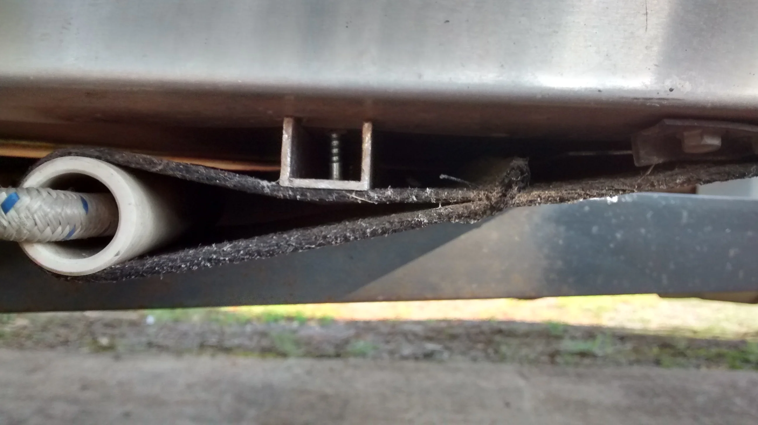

In just about any hardware store's metal section you can find 1/2" and 3/4" U channel trim capping, used for edging wooden sheetgoods (plywood/particle board). We took some of the 1/2" stuff, cut it in pieces, drilled holes in it and mounted it, open side up, to the bottom of the cabin floor. There are likely many other ways of skinning this cat, but this seems to be working, though in hindsight I think the 3/4" U channel might work a bit better.
At the ends of the Alcan cover is a plastic tube with a bungee running through it. I think the best place to mount the U channel is about an inch or so behind where the plastic tube sits with the cover attached. This keeps the cover away from the floor, allowing moisture to safely drain away. This location doesn't seem to add any undue strain to the Alcan cover.
A side benefit of doing this is that the drain hole on the curbside of the pass-thru box can't be blocked by the Alcan cover. This drain hole was blocked by debris on our camper because the debris couldn't get past the Alcan cover.

I should add that this scenario is most likely to occur when the camper is outside in the elements for extended periods of time. Folks using their camper for short term camping and parking it in a garage when not in use aren't too likely to find this to be an issue.
