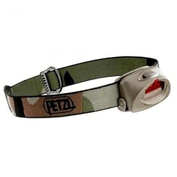

    Yah, I'm interested to, more for the "Red" option on the LEDs...
    I guess I have an older model, #250 and it only has the dimmer white light....
    If I wake up in the middle of the night, 3am of course, and forget and turn one on, I keep hearing these voices Yelling,
    "Frank!!, head for the 'White Light', head for the 'White Light'...."
    and of course I do... to turn it off.. Night vision is then shot..
    Just as an alternative, I now use the little Petzl head leds in "Red" mode and it works just fine...
