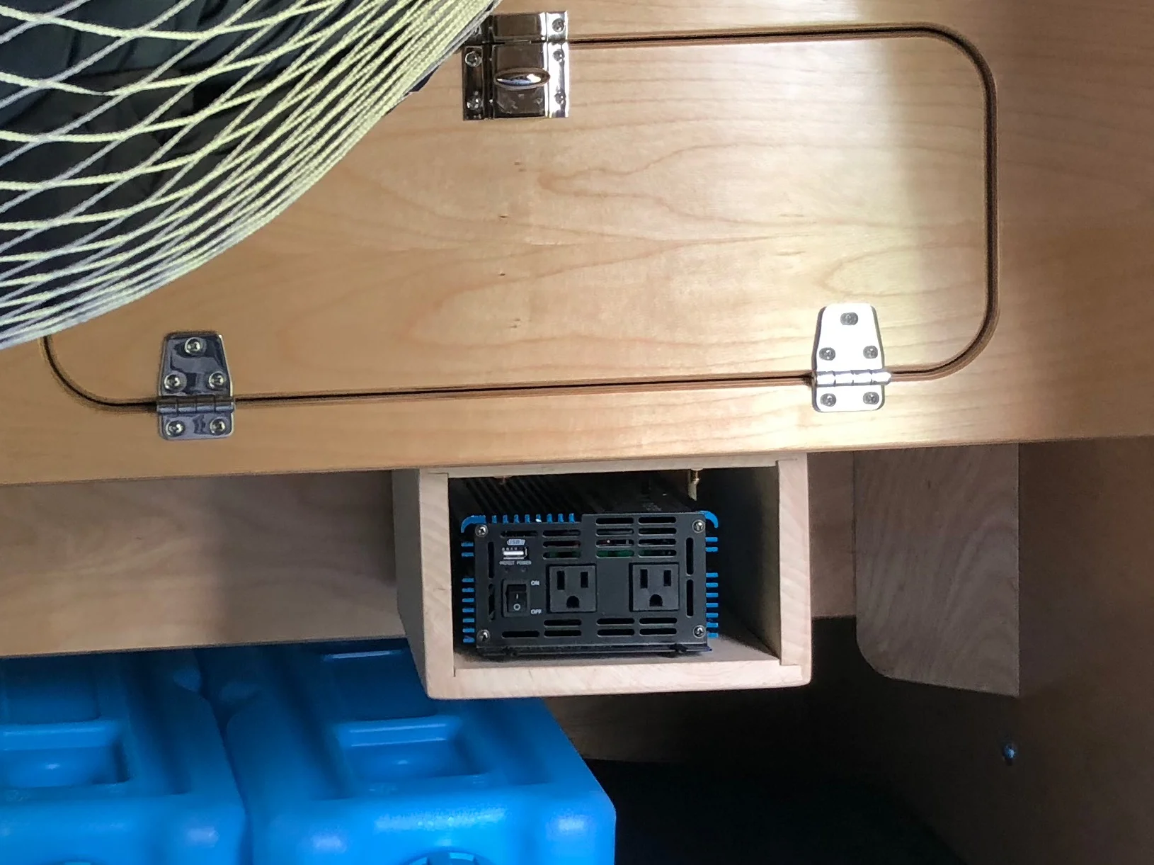

  11. Lane and Michael
    Lane and Michael Junior Ranger Donating Member
    Here is a photo of the little inverter which will charge my camera batteries, my Makita batteries and run a small electric drill. I'm pleased with it. It is hooked up to the battery with #4 jumper cable wire which is not quite flexible enough to allow me to center the inverter in the little box which annoys me no end. I fastened it with 3M Dual Lock and it is the devil to try to relocate.

  12. dustinp
    Maybe you can put some small spacer blocks around the inverter to hold it so that it's equally spaced on all sides, just until the cable looses it's old positions memory, and learns the new one. Kinda like Alzheimer's in reverse;)....or you could even mount the spacer blocks permanently with some more of your Dual Lock. I think it could still look good with them in there too.
  13. Lane and Michael
    To those of you who have been understanding the shame I had felt for a shoddy job, you will be happy to know that I have disassembled the whole thing and centered the inverter properly. Funny how annoying such a small thing can be, but it would have been a source of constant aggravation. There is no point in buying such a fine trailer and then doing less than my best. The circuit breaker I installed is nice as it doubles as an on/off switch so I am not likely to leave the inverter on accidentally only to find later on that the Firefly's battery is all tuckered out.

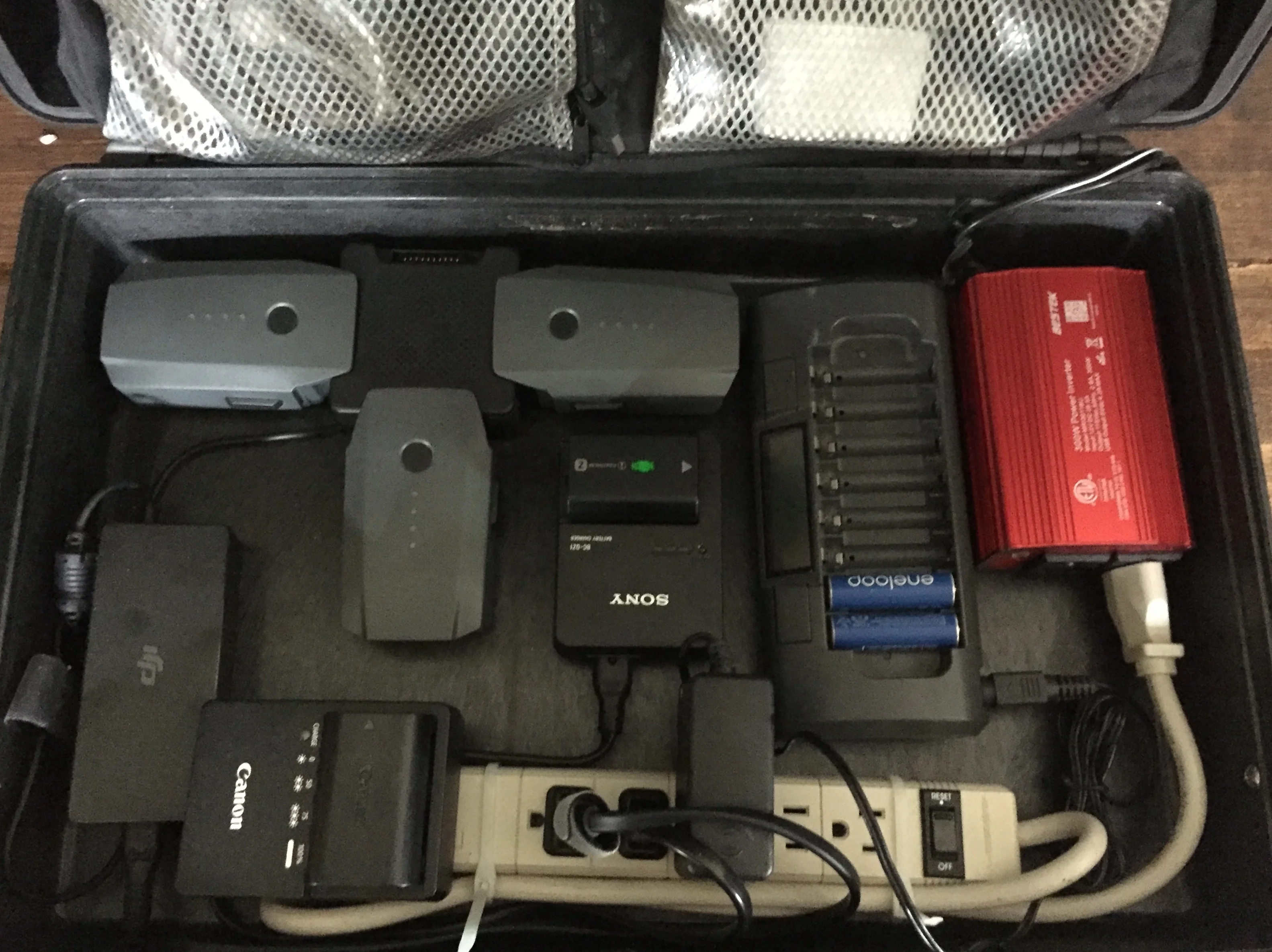

  14. fishbisquit
    fishbisquit Novice
    Cool install interested in hearing how this works for you. I just went through this on our last trip last month. I have a lot of camera batteries, drones laptop and AA batteries all with different chargers. It's a pain to pack and keep track of all that stuff. I would have chargers laying in the back of our TV when traveling and things would fall out or shift around. I decided to make a charging case for this trip. I bought a cheaper 300 watt inverter and velcroed it and all my chargers in a pelican case I wasn't using much any more. When I need to charge I lay the case in our 550 and plug in the inverter. I like the case because I can move it around. So if we are camping where we have power I can have the case on the picnic table and run a 110 extension cord to the case and by-pass the inverter. I can also use it in the TV if needed. Worked great this last trip. However this set up was strictly battery / laptop charging. Your set up looks more robust and cable of more options for equipment larger electical draws.

  15. Lane and Michael
    A neat, efficient arrangement.
    I'm happy with the inverter now that it's centered. It makes no noise, charges my computer and camera batteries and will run a small electric drill (an experiment which will not travel with us, but nice to know it will run with no voltage drop). I don't think I needed one as large as that, but I did want an inverter that would not ruin my computer.
