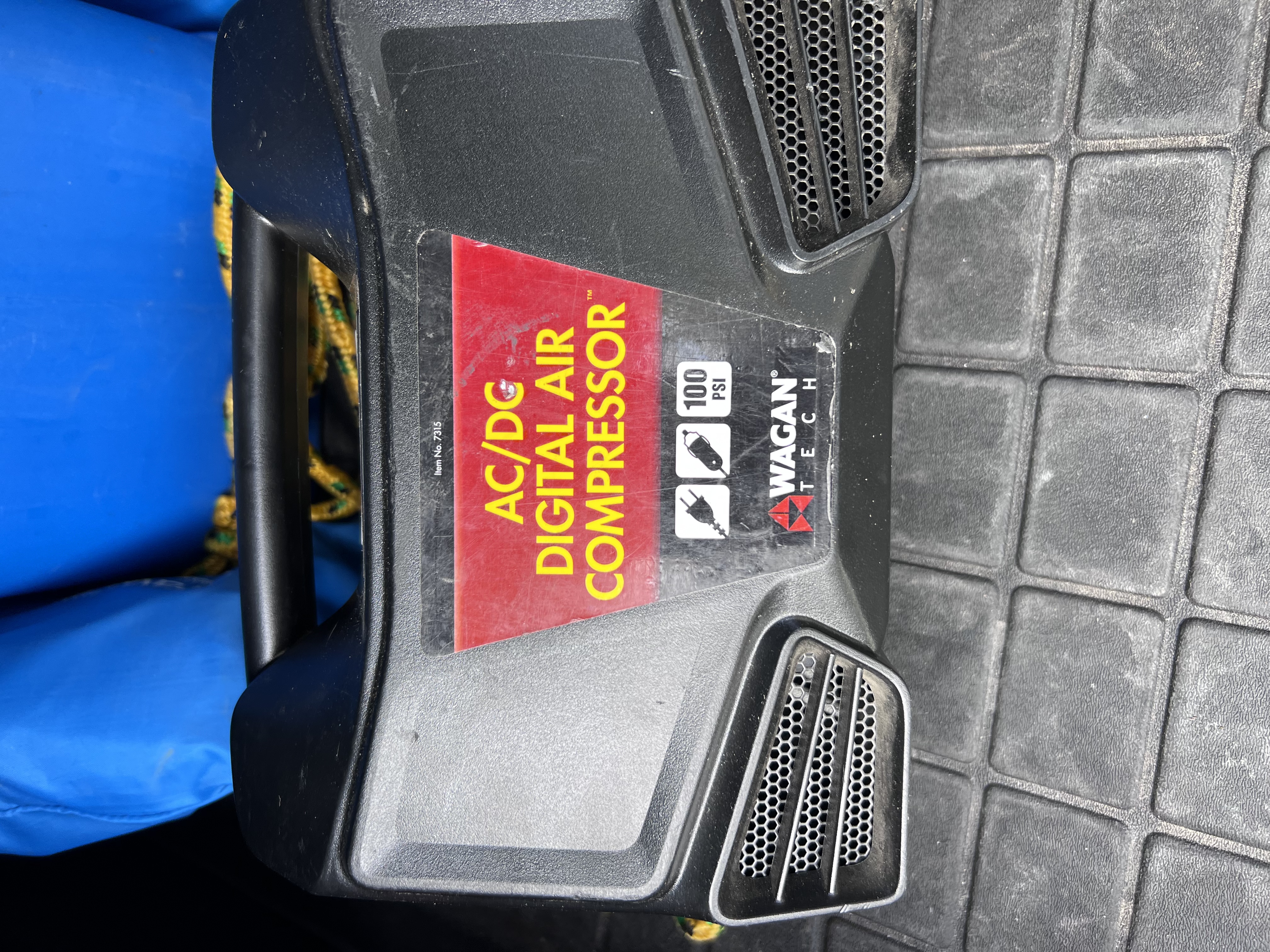

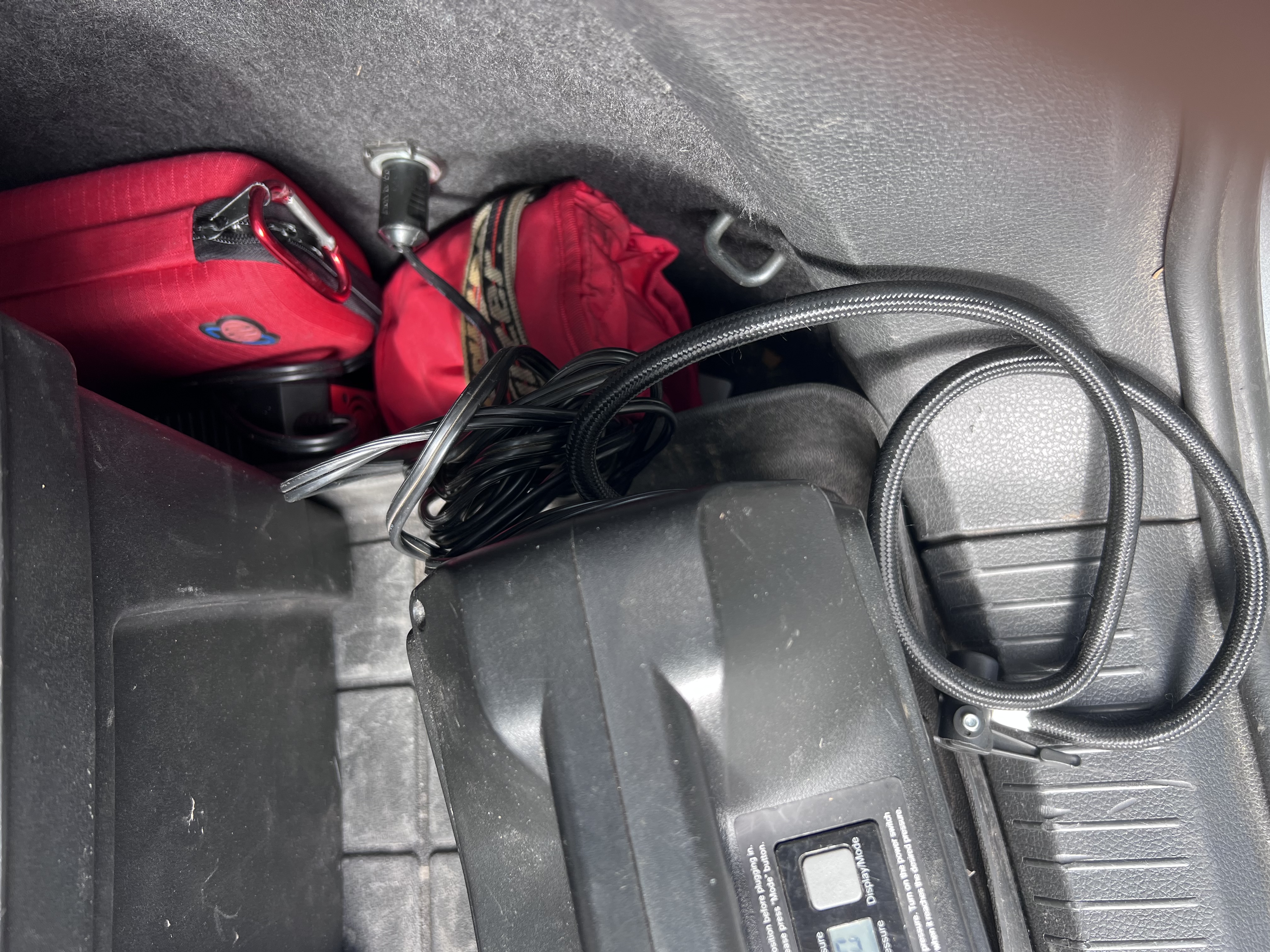

  20. Kevin
    Kevin Ranger
    John I got this lil "Warn" on Amazon a few years ago. Very handy, works off 120v or 12dc cig outlet in car.
    It will air up my 215/65/16" tires from aired down in desert to say 20 backup to 40psi but takes awhile, 6-8 min each and will turn off at preset pressure.
    If doing all four tires a lot, or bigger truck AT type then would need to wait to let it cool down in between each as the compresser heats up as do the wires...
    Looking on Amazon at ranges of inflators thats the trade off -faster more volume is more money.
    This has been reliable touching up tires on long drives, after repairing a flat, and used it often to inflate AirLift manual helper bags inside coil to hold up VW wagon saggy butt when heavy loaded, then air down to street ride empty.
    If I am going back aways I'll bring my 80psi standup manual pump for mtn bike as a backup but thats painfully slow on car tire, as I'm guessing you know. One is none two is one.
