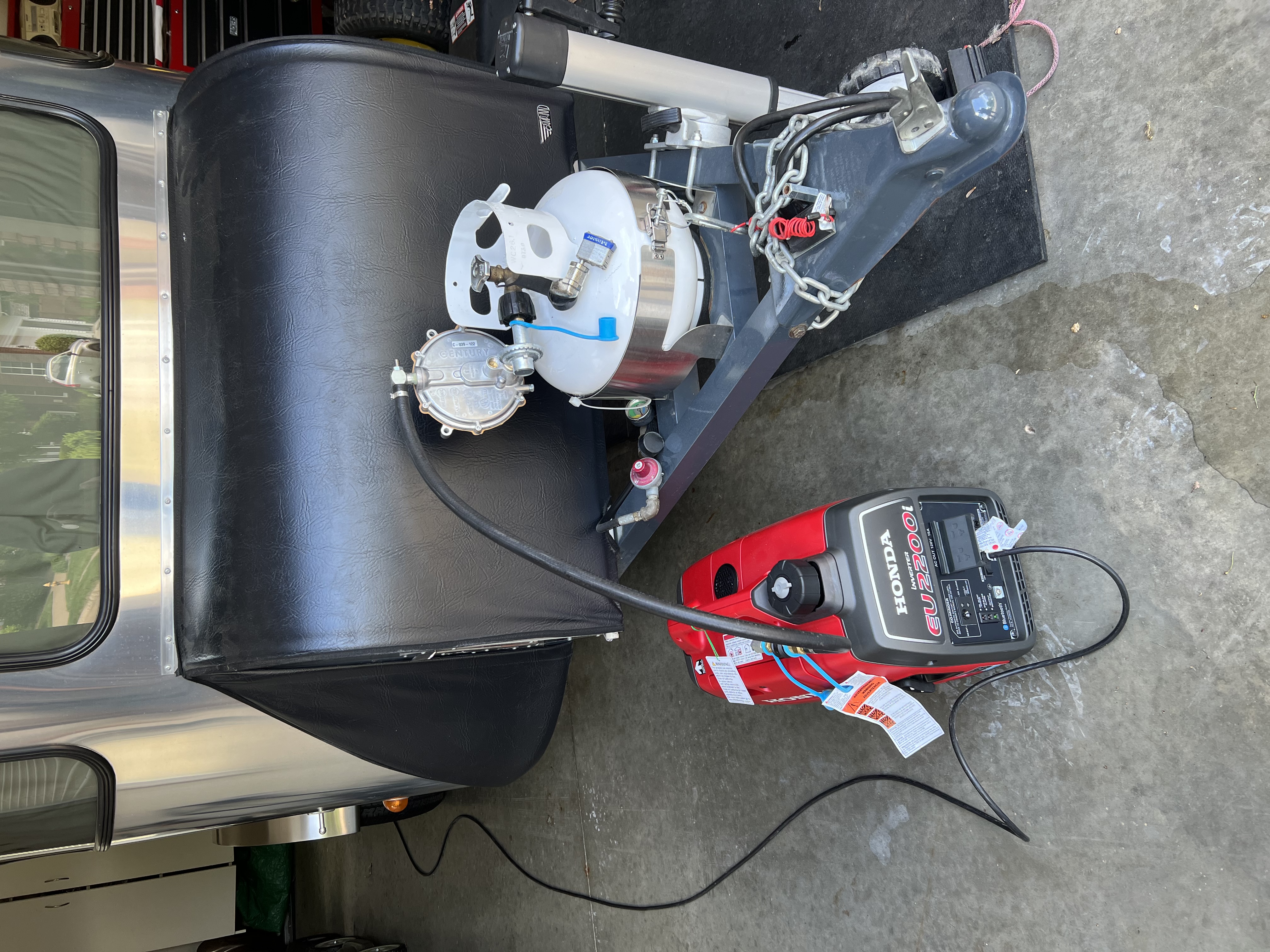

    Planning a 6 week trip next year and wanted the convenience of having a generator along, just in case we need to recharge battery or run air conditioner while boon docking. Not wanting to carry gasoline converted our Honda generator to propane. Process was pretty straightforward. Tested and works great..

    Have you done any run testing? those are quiet aren't they? I bought one for the same purpose last year....Its worth a few bucks night just to get some sleep...and 90 degrees with 90% humidity is a pretty sure way to ensure you don't get any.

    Congrats on a great project! It’s one that I’ve wondered about, because getting gasoline out of the generator in favor of propane would be a huge difference in transporting a generator.
    Please do post on your experience with it!

    The EU2200i operates at 48 to 57 dBA, which is less noise than a normal conversation. I did test it and actually you can’t hear it over air conditioner.
    I explored the natural gas route also, if memory serves me correctly, the natural gas route would require a different needle size in the generator carburetor. Really like the propane conversion, very easy to start and the exhaust is much cleaner..

    My yamaha 2800 has a propane converstion --- I've used it a couple times, but was never really happy with it. These conversions meter a stead flow of gas, they aren't like the gasoline side where there is a volumetric difference based on airflow and throttle position. So, if you get it running right under a certain load any changes will leave it running 'rich' or 'lean' --- it's just fiddly.

    Have never tested the run time in a 20# tank, but from what I have read the average is around 15 hrs on regular mode and longer if ran on eco mode..

    Sweeney, you said the propane conversion on your Yamaha is kind of "fiddly". What specifically does that mean? Will the generator sputter? will it not stay running?

    The setup I have likes to have a predictable load --- if you go from 1amp to 15 amps back to down to 5 --- it just is never mixed right... No change in fuel flow rate
