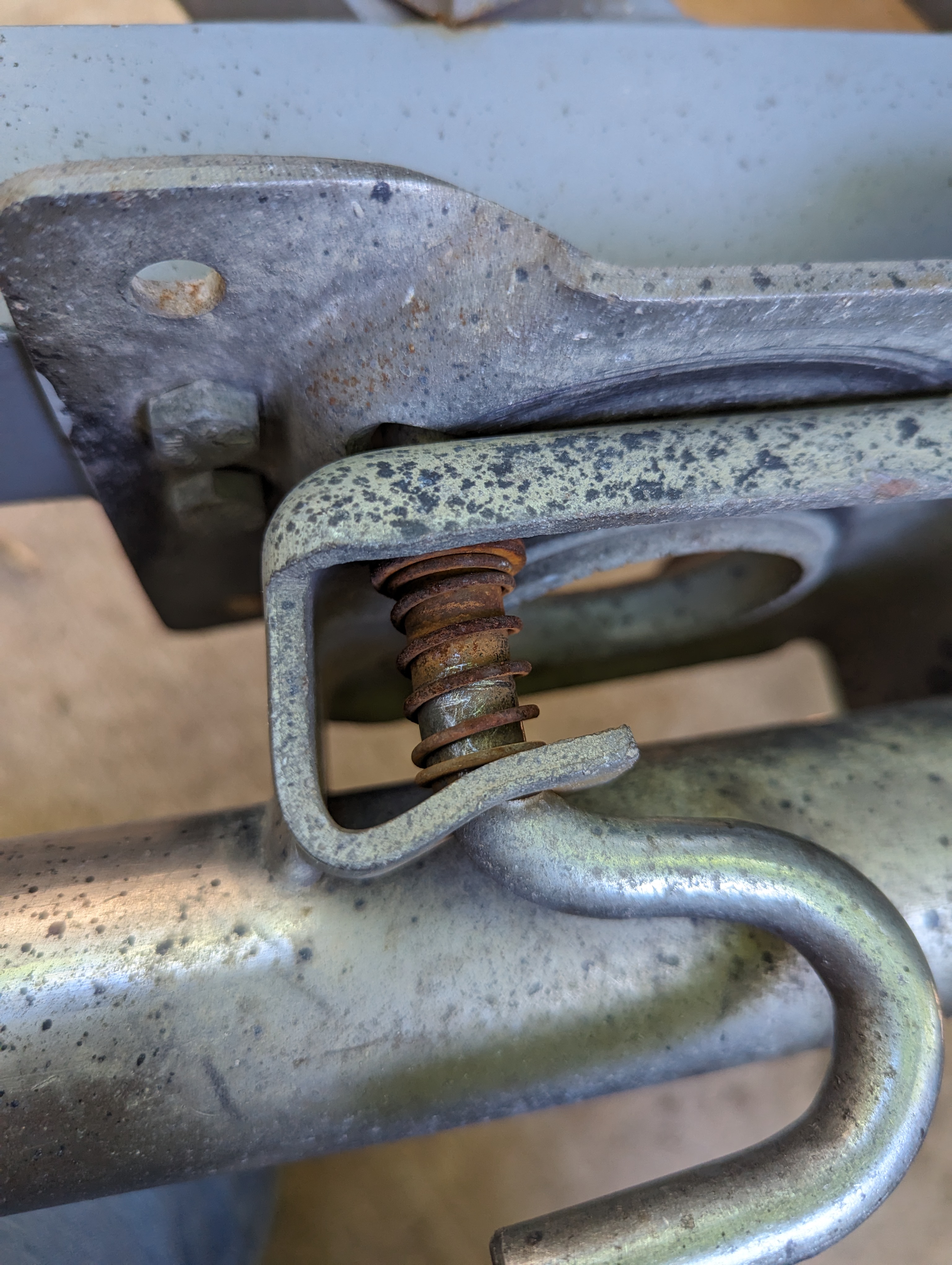

    Hi guys. I'm not sure how this happened but I arrived at my destination and I can't seem to pull out the metal piece that allows me to turn the hitch jack. When I pull it all the way out and the spring is fully compressed, the metal is still not out where I can turn the jack. I thereforw can't raise the camper off my hitch. Anyone have this issue?

    To me it appears that the part of the bracket against which the spring presses has become "squeezed" closer to the mount plate. The location of the curves in the bracket suggests that this might have been caused by a large sideways force on the jack tube.

    I'm not near mine to see if the curvature in the bracket the spring stops against, that Turnip mentioned, is normal or if it has been damaged, but it appears that some good penetrant oil like Sea Foam Deep Creep https://www.amazon.com/Seafoam-Extr...hvlocphy=&hvtargid=pla-4583520395807768&psc=1 , or something similar, along with a pry bar may be needed to get the pin totally disengaged for the jack to turn on it's swivel. Once it's movable, you should be able to tell if the mechanism is bent, and needs to be tweeked to get everything bent back into position to engage and disengage properly, then some additional regular lubrication may keep it from recurring.

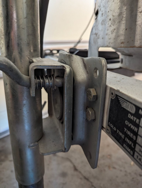

    Yeah, that became pinched which is why it will not let your pin out.
    Here is what it should look like: See if you can pry it back open if possible, but that is fairly thick. Something had to hit it pretty hard to bend that.

    Probably the turn I made where I busted my kids bike. Anyone have any ideas on how to fix this short of hammering it like a madman?

    You need a long lever to do this safely. Do you have access to a 18”-plus crescent wrench? And a pipe to slide over the handle to use as a breaker bar? Or maybe a metal-working friend?
    Slide the jaws of the wrench closed on the bent section, stand back and start pulling it into shape, as shown in @CampinnGlampin’s picture. Bear in mind that with the force you can apply at the end of a long lever there is a lot of energy that could be released if something slips!
