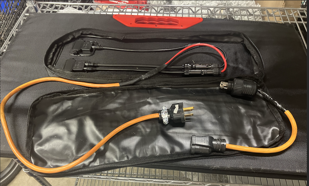

    You shoudln't need to modify the trailer in any way whatsoever. I have a 220 watt panel which works beautifully. I simply wired the MC4 off the panel into the 'twist lock' connector and plugged in in. Making sure the polarity was correct of course.
    I cheated a little bit --- and I'm sure safety sallies will jump all over me but I wired the MC4 connectors to a female 110 volt receiptcle, so I can plug in the male end of any extension cord. From the trailer side, I wired a 110 volt socket to the twist lock. The orientation is correct to protect the camper --- i could never accidentally run 110 into the charge controller this way. I could the solar panel but that would be much less catastrophic....
    The reason I use the "extension cord" method is simply to allow me to run as much or as little wire as I need from the sonar panel to the camper, without having to carry another separate dedicate cable...
    Looks something like this:
    Kevin and Van_and_Terri like this.

    The point is that only one charge controller should be in the circuit. Rather than changing the wiring in the trailer to temporarily use a portable solar panel, buy a portable either without a controller or with a controller that is easily bypassed. It’s very handy to have a controller on a portable panel… I recommend a panel with a controller that can be bypassed.
    Safety Sally here! Your install is not to code! However, code exists to idiot-proof electricity, and Sweeney is pretty smart about not plugging his solar panel connection into shore power.
    I love the idea of breaking the chokehold of household solar hardware on those of us who need temp systems at relatively low overall capacity, those d*** wires they sell just aren’t made for road use. They don’t coil. They don’t lay flat, that’s unsafe. You don’t get two conductors in one cable. You have to pair them yourself, not to mention terminating with weird connectors. And, they are expensive.
    It’s just copper and insulation! Why not a 14, 12, or even 10ga extension cord?
    On the other hand, those connections aren’t waterproof, and if you have a real soaker while you’re away from camp there could be trouble.

    Oh, it's up code....MY code :) A
    its low voltage when "used properly" and I suspect if the solar panels ever did see 120 volt they would zap themselves to death with a shower of sparks in a matter of milliseconds.
    One thing not clear here, is the ground wire is the 'key' that keeps you from plugggin the cord in backwards....whatever you use you've got to be sure the ground plug is oriented properly to prevent +/- inversion. Frankly, not sure what would happen if you did that --- but I'm in no hurry to find out. I mitigate this by never leaving the cord unplugged where some one might be tempted to plug it into the power pole.
