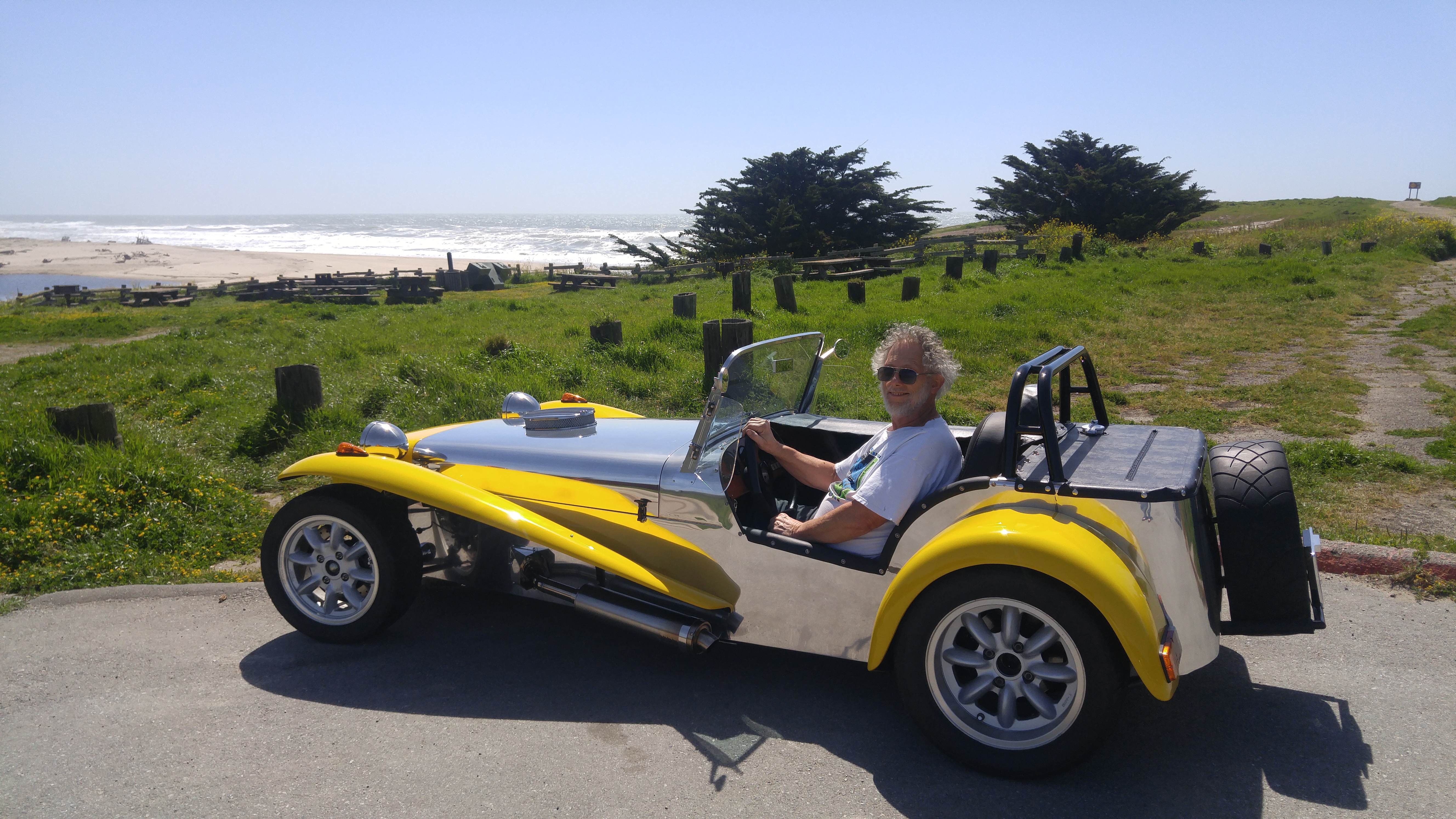

    I am a fan of the Nuvite Nushine products. They are available at Aircraft Spruce and other vendors, NUVITE NUSHINE II METAL POLISH | Aircraft Spruce
    I got a dual action polisher at Harbor Freight with a number of foam pads. I used a large piece of flannel material wrapped around the pad and polisher, this stops the pad from rotating which makes swirls, and just gives the circular motion that does the work. The final polish is with a lambs wool bonnet on the polisher. It's a lot of work, but the result is amazing, though once you do it, you are committed to the maintenance to keep it shiny.
    I have not tried it on my Camp Inn, but it worked very nicely on my aluminum bodied roadster.

    Thank you for the suggestion. If my current list of new items to try do not play out well, I will definitely give that a spin.
    Also, love your tow vehicle, I know our tear drops are ultra light, but some of the stuff I see people tow with here scare the **** out of me and I fear for them.
  15. rotus8
    rotus8 Ranger Donating Member
    It does have a V8, that's all you need, isn't it?
