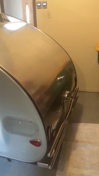

    Ok ... so, I took Bear's advice & jumped into the unknown and have arrived at a solution. Thought I'd pass along my learnins'. I didn't have an easy way to determine the correct lift-force and/or the correct length and stroke ... so, for $33 I took a chance and guessed. Ordered a pair of gas struts from Amazon with 17" expanded length and 40# of force each (80# total) ... first fit-up didn't work as my positioning didn't allow for enough stroke to fully close. So, after adjusting the positioning it closed wonderfully. However, I was not happy with the amount of lift assist (too little). So, I ordered a similar strut but with 80# of lift each (160# total). Installed the new ones in the correct position and it worked perfectly! With this lift force, the hatch actually lifts open by itself! just like a high-end car trunk! I elected to keep the wooden OEM support pole just as a safety and it takes the pressure off the struts when fully opened ... and, we loose a couple of inches fromthe storage tray areas due to the struts operating there.
    In case anyone's interested, the lifts were ordered thru Amazon Prime from LiftSupportsDepot.com ... part# C16-08789 ... $33.00 for the pair (returned the lighter ones & was charged for returned shipping - about $9.00). Note that I also had to purchase the mounting brackets - 10mm Flat Gas Spring Mounting Bracket ($5.98 for the pair) and 10MM Ball Stud Bracket for Gas Strut -90 degrees ($9.35 for the pair). So, total investment (not including return shipping for the rejects) = $48.33 ! and now ... momma's happy (which means I'm happy!). Photos below.

    nice job, looks good. The weight of the galley hatch does seem to increase over time :-o. There have been many times I've wished I could raise the hatch with one hand.
    it does look to me like these struts might inhibit the use of the galley windscreens, depending on how much space there is between the strut and the wood.
