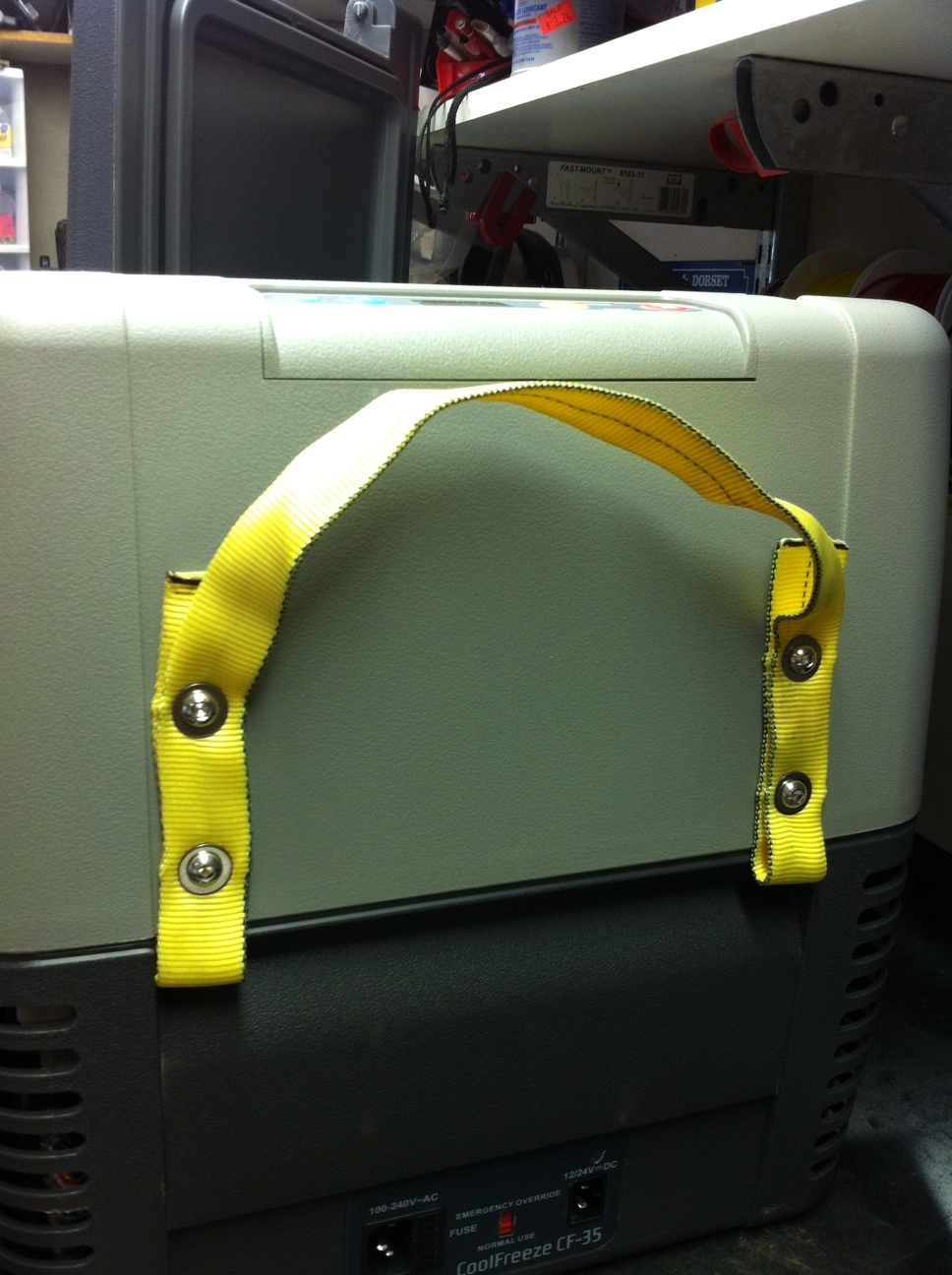

    I have been working on a little project today, and thought I would share what I did. I may be late to the party on this (wouldn't be the first time!), but I hadn't seen anything from anyone else.
    The fridge doesn't fit in the galley with the handles on, as many know, and I have been lifting it by the very small ledges all this time. Every so often I feel a little click (when it is really full and heavy), and I was getting nervous. Plus, after giving up rock climbing, my fingers are nowhere near as strong as they used to be!
    After some thought, I came up with this handle solution. We had most of the parts at home (the screws that came with the handles would have worked, but I swapped them out as I know the parts I used are stainless and won't rust).
    Everything slides in easily, and lifting is a breeze!

    So what did you use for the strap?
  4. Mick'nSarah
    Mick'nSarah Junior Ranger
    Stephen (and/or Shirley). It is a piece of 1" webbing Mick had laying around. You can get them at most sporting good stores (or REI). Come to think of it, I bet Home Depot, or the like, would have it too. I didn't actually measure it out, but I am guessing each side took around 18" of webbing for a handle the size I made.
    Side note, the screws are metric also, so you will want to look for a size 6 if you want to replace them. These also sit a little more flush with the fridge and I figured I would be less likely to catch myself on them (the ones that came with it will stick out about 3/8").

    I laid it all out how I wanted it, marked where the ends should line up, and where the holes went. Mick has an old soldering iron we use to burn holes through the middle of 2-layers of the webbing (it isn't his good one he uses for the cars, but it kind of burned the 2 layers together a bit too and held them in place). I ran to A-boy and grabbed 8 flat washers and 8 size 6 domed screws that were about 1/8-1/4" shorter than the ones that came with the cooler (all of them are stainless steel...the washers were $0.11/each and the screws were $1.30/each). With the webbing being burned, it is strong. Then with the washer and the shorter screw, it really pushes the webbing up against the cooler tight, reducing stress on the hole. I will post pictures of the process. Wasn't sure how many people might be interested, but took pictures just in case.

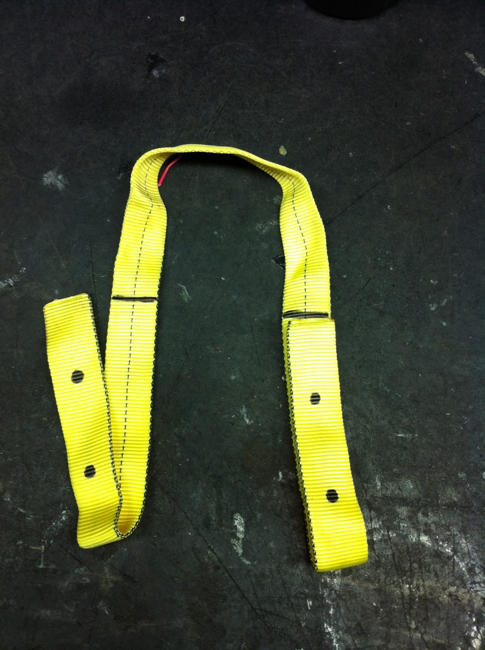

    First, I lined up where the double backed bit needed to line up, so Mick would make sure things didn't move too much. Then I marked where I wanted the holes to be.

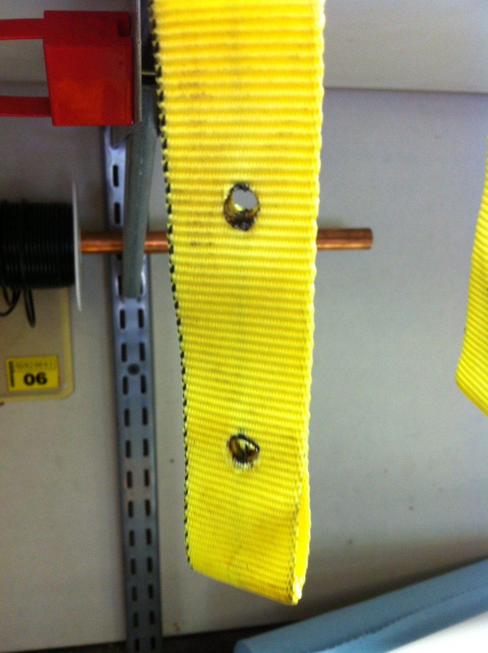

    The holes after they were burned:
    Then I put the screw through the washer and tightened it up with an alan wrench. The one that came with your cooler should also work with the screws I bought. For reference, the one I was using was a 4mm.
    After I took that last picture I noticed things were a little wiggly, so I loosened things up, pulled the webbing down tight, and tightened the screws again. I considered using grommets, but was trying to get away with using things we had around here, and that wasn't in "stock". By the time I hit the hardware store, we already had this plan in place. You could do grommets, but we feel pretty sure the webbing (it is tubular webbing, so technically there are 4 layers there), plus the burning, plus the washers are going to be plenty strong. I suppose time will tell!
