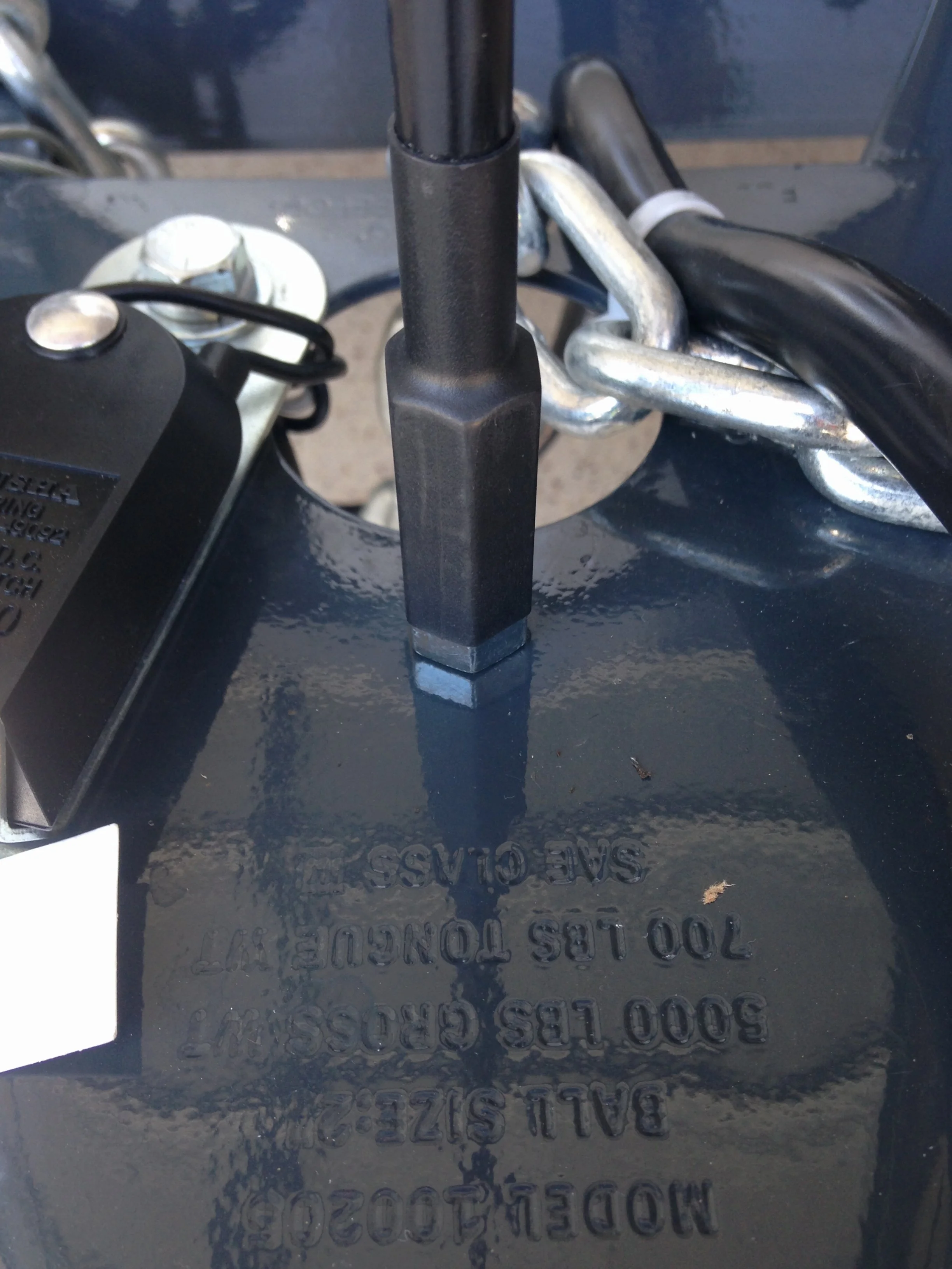

    Just got back from Lake Kiabab Campground (Willams, AZ) & got many complements on Flagpole - it passed the field & weather test. Sorry, haven't figured out photos yet, but above vendor website has them. Made a simple revision to mount for cleaner look - Ditched the 3/8" mounting bolt from below and installed a 2" long 3/8" setscrew bolt directly into Flagpole Mount with tapered end down, plus used Locktight on setscrew. Now the Flagpole simply screws into the unused hole on toung & when removed - you are back to stock.

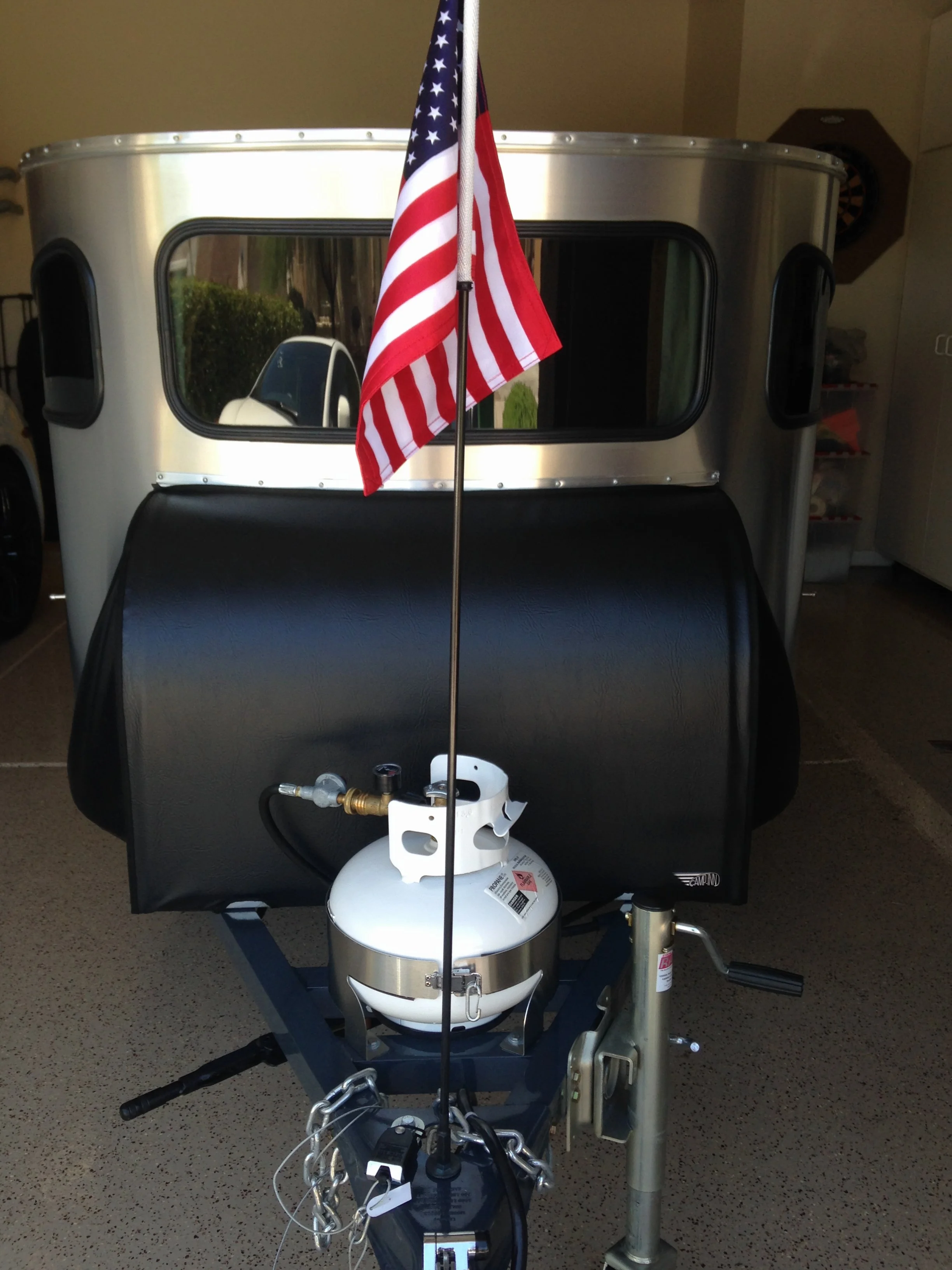

    DETAILED PHOTOS ADDED
  12. Towbert
    Towbert Novice
    Detailed Photos Added ~
