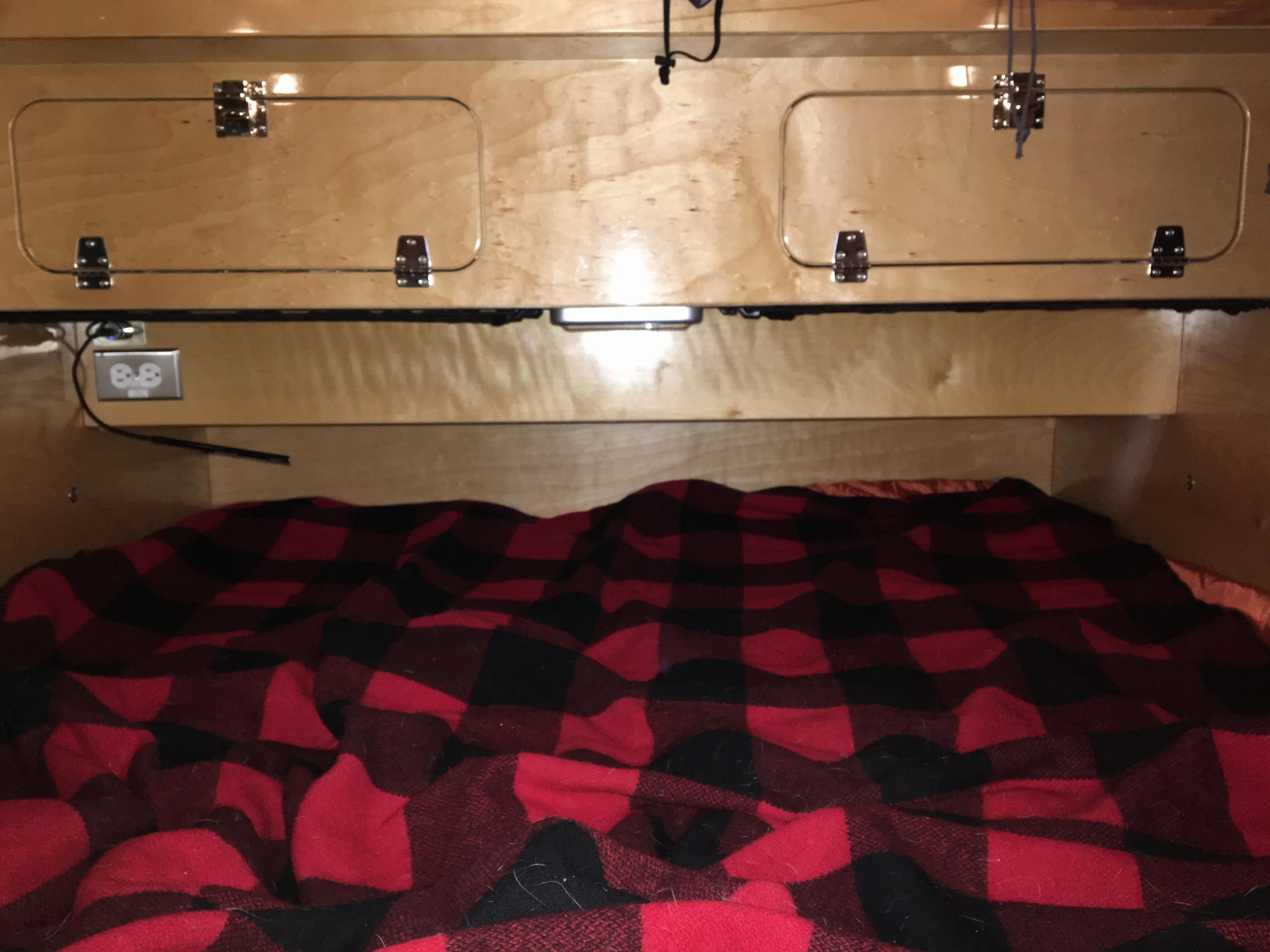

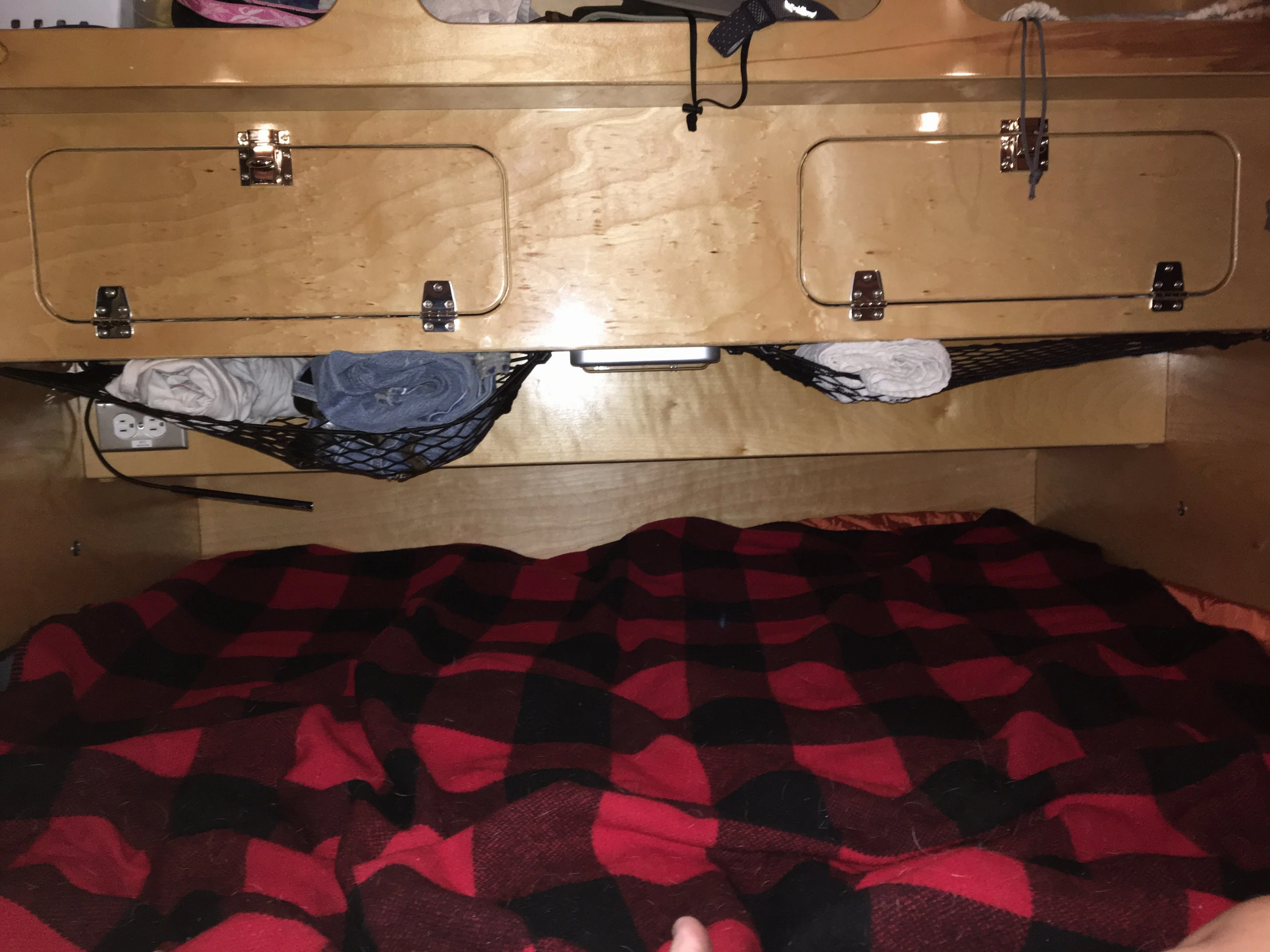

    Just got done installing some extra storage to the footwell area in the cabin of our 560 classic and thought I'd share. I picked up some small cargo nets from Cabelas and installed them under the shelves.
    Rig Rite BOATGO Storage Net : Cabela's
    I got the small console net and installed one on each side above our feet for miscellaneous storage. I like it for putting pants or socks or whatnot for quick retrieval in the middle of the night or first thing in the morning. I've found that if i just toss the stuff at my feet at bedtime, they end up getting lost from sleeping and the dog moving around.
    I mounted the hooks 23 3/4" apart from side to side and 10 1/2" front to back.
    The lights underneath are a a Sylvania Dot led light:
    Sylvania 36051 Silver Linear Dot It Portable LED Light, Silver - Tap Lights - Amazon.com
    and a Goal Zero Luna light:
    Amazon.com: Goal Zero Luna LED Light: Automotive
    This should be the most useful addition since I mounted the bottle opener in the galley!

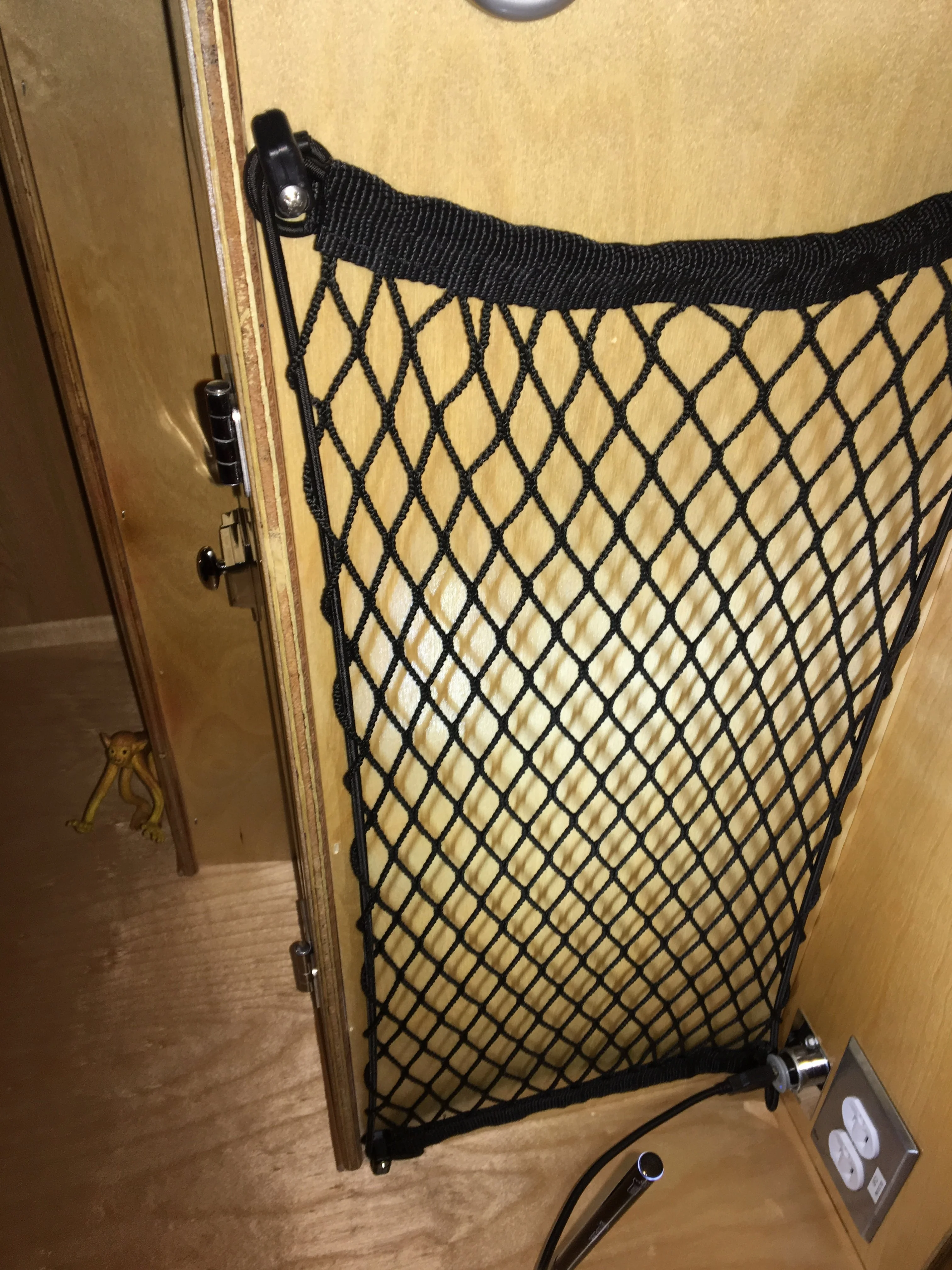

    Dean - thanks for posting this. I added a couple of the nets you referenced and I really like the extra storage.
    Given the A/C drain pipe, I had to offset one side, but there is still plenty of room for both nets.
    While you didn't mention it in your post, your photo's show a really good adjustment - that is to flip the loop under the net which shortens the width and allows it to perfectly.

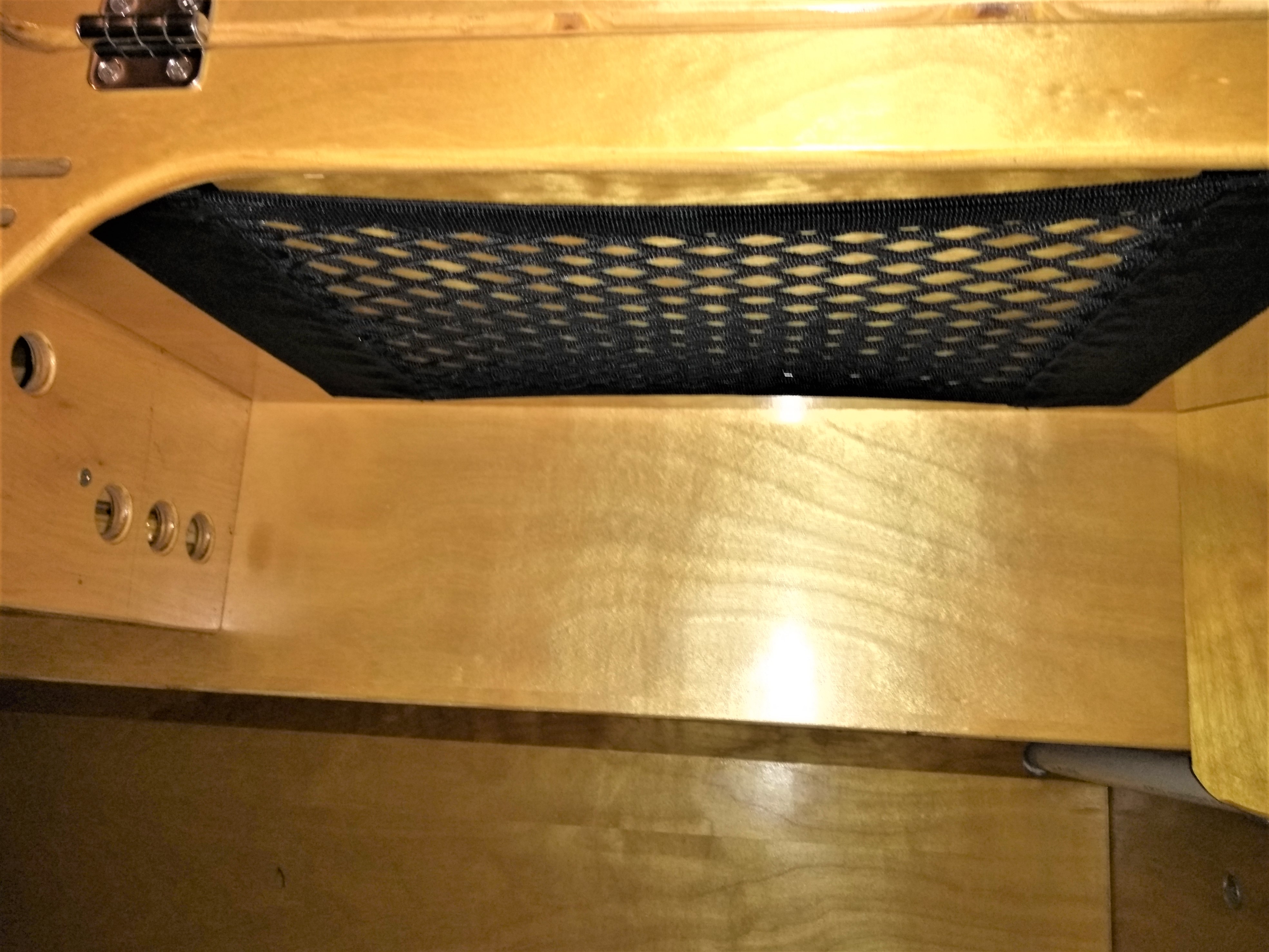

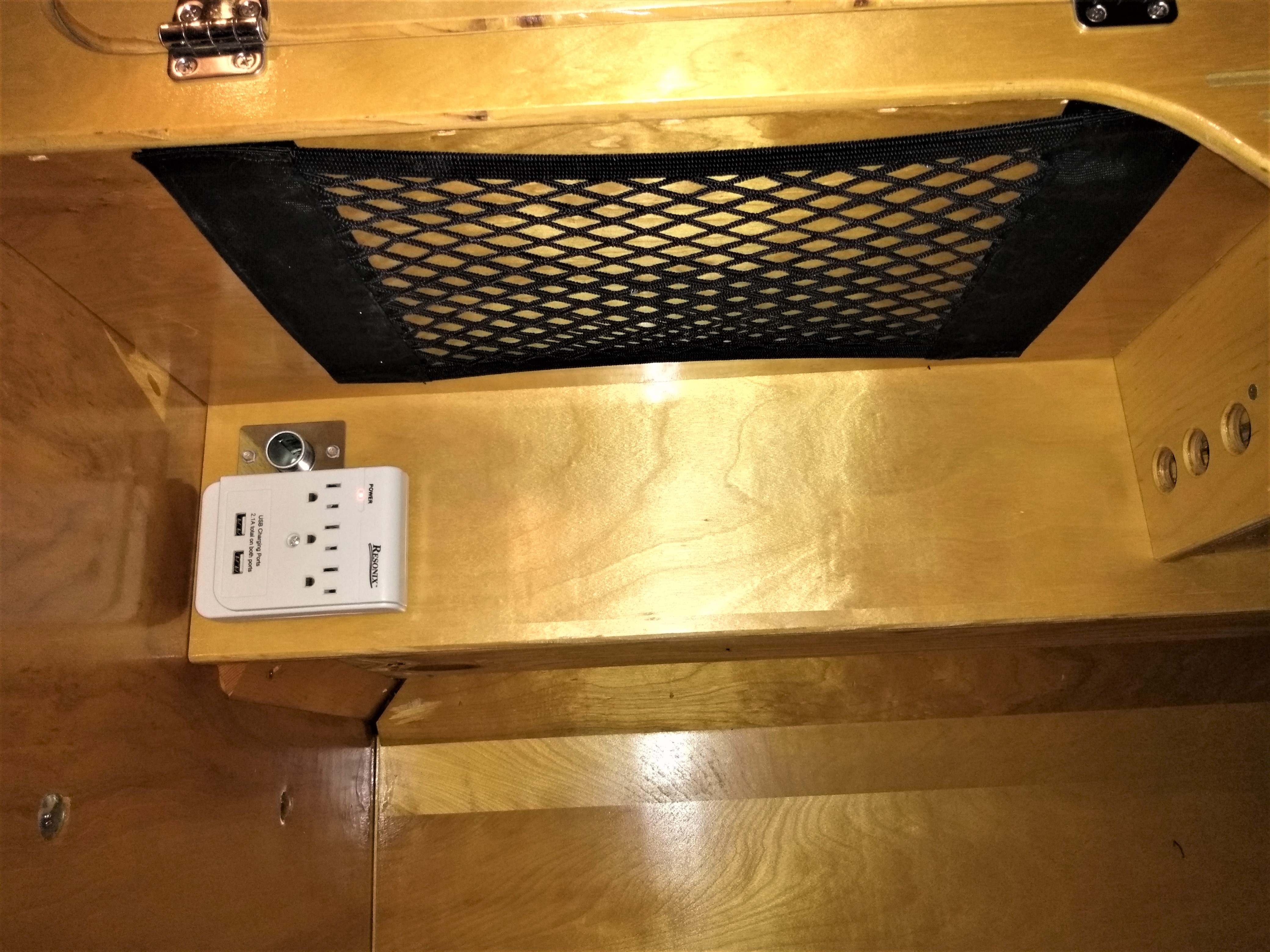

    We checked out the nets from Cabella's, and then at Amazon, but decided that because of the center drop down area below where the original CRT TV was installed in our TD, we didn't have quite as much room as Dean did, so opted for some that were a little narrower to better fit our situation.
    These also mount with hook & loop fabric at the sides, with a strong adhesive strip for the side that attaches to the wood face of the cabinet underside. I don't think it will easily let loose from the wood, but the hook & loop sections may separate from each other if the net is overloaded. So will see if it needs some screws for reinforcement once we've used them a little. ZKSM 2 Pack Car Storage Net Trunk Back Seat Organizer with Mesh Universal Cargo Net Wall Sticker Organizer Pouch Bag for Car and House Organize, Black

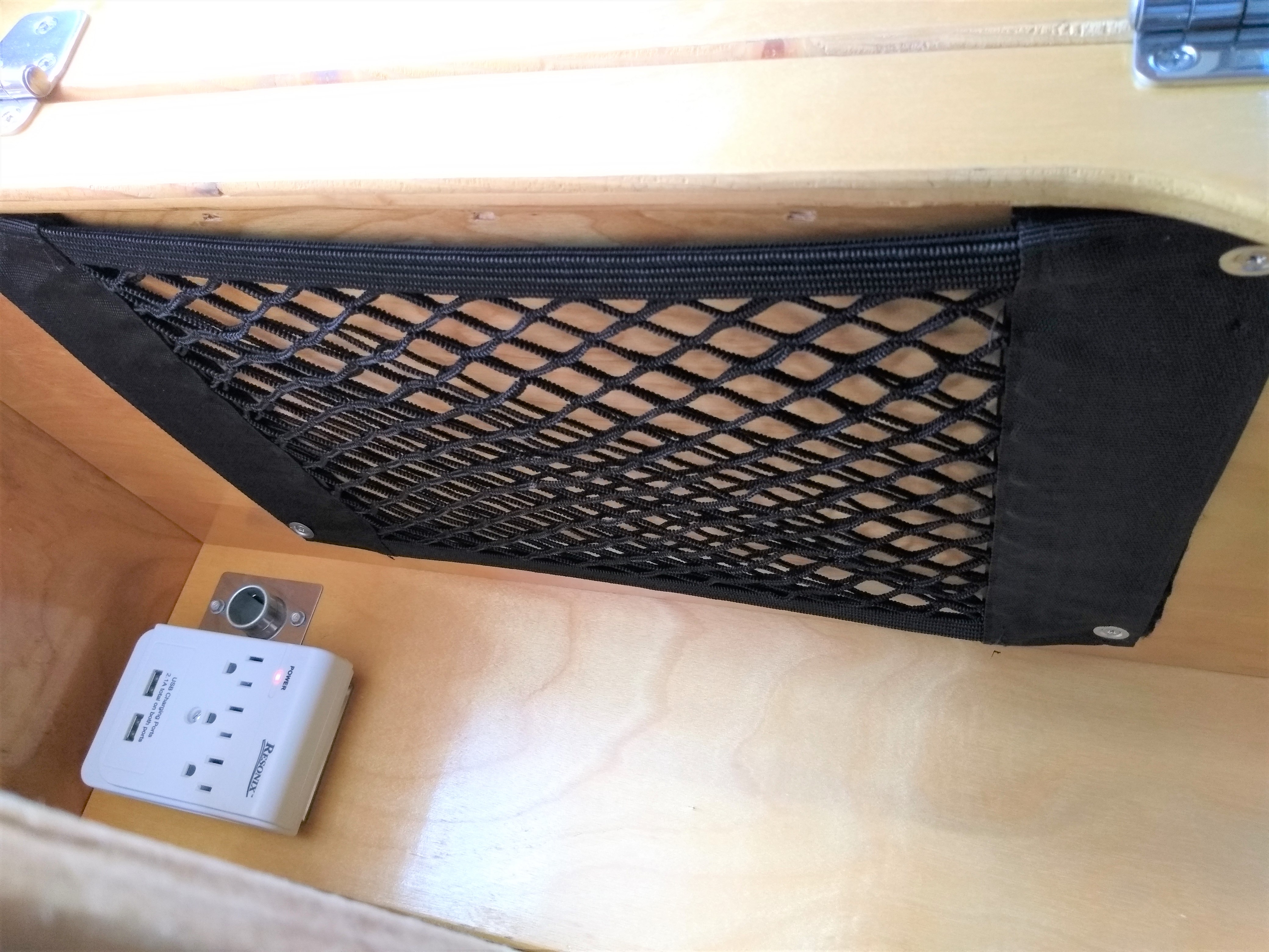

    Update: Well after 3 weeks, with some quite warm weather, I opened the TD cabin today, and found that the adhesive Velcro strip on one end of one of the nets had let loose from the wood. So, rather than wait for the rest of them to gradually do the same, I decided to add some screws and washers for some added security. I used some 1/2 in flush head screws with some indented washers specially made for flush head screws, just because that is what I had on hand. Pan head screws with s standard washer would works as well or better.
