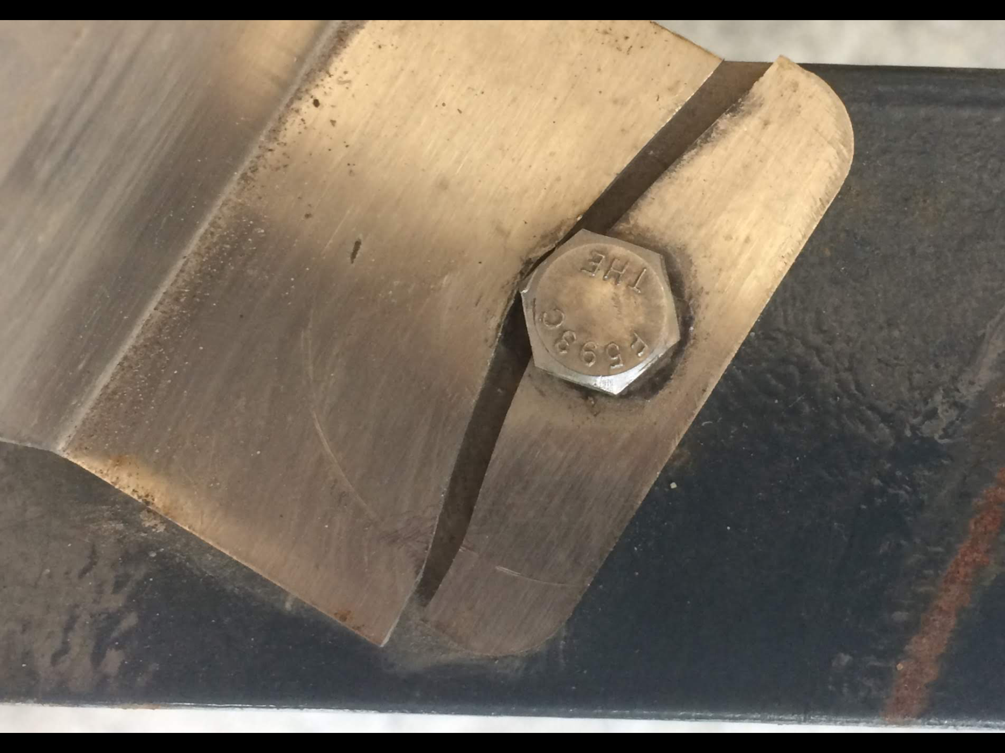

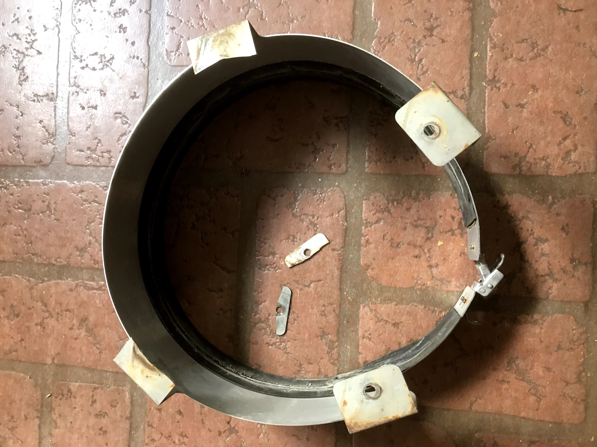

    Hi guys... We had one and then two of the feet on our stainless LP tank holder crack right thru the holes...
    It looks like it could happen to any Campinn Camper. Could be worse if you tried a 20# tank on there!
    - Below are pictures of our situation and how it got repaired.

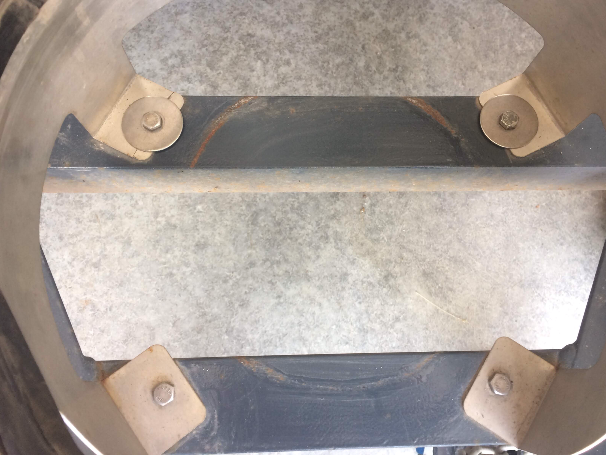

    First I tried a fender washer on top of the broken foot to reinforce it and the one next to it.
    A few back roads and the second one broke anyways.

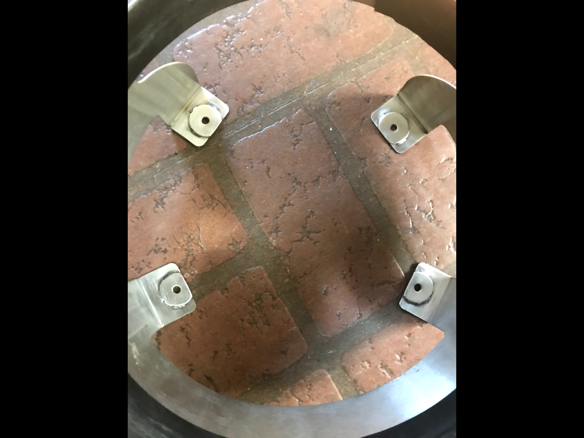

    I finally took it to a stainless shop and had it fixed for good for about $50-60.
