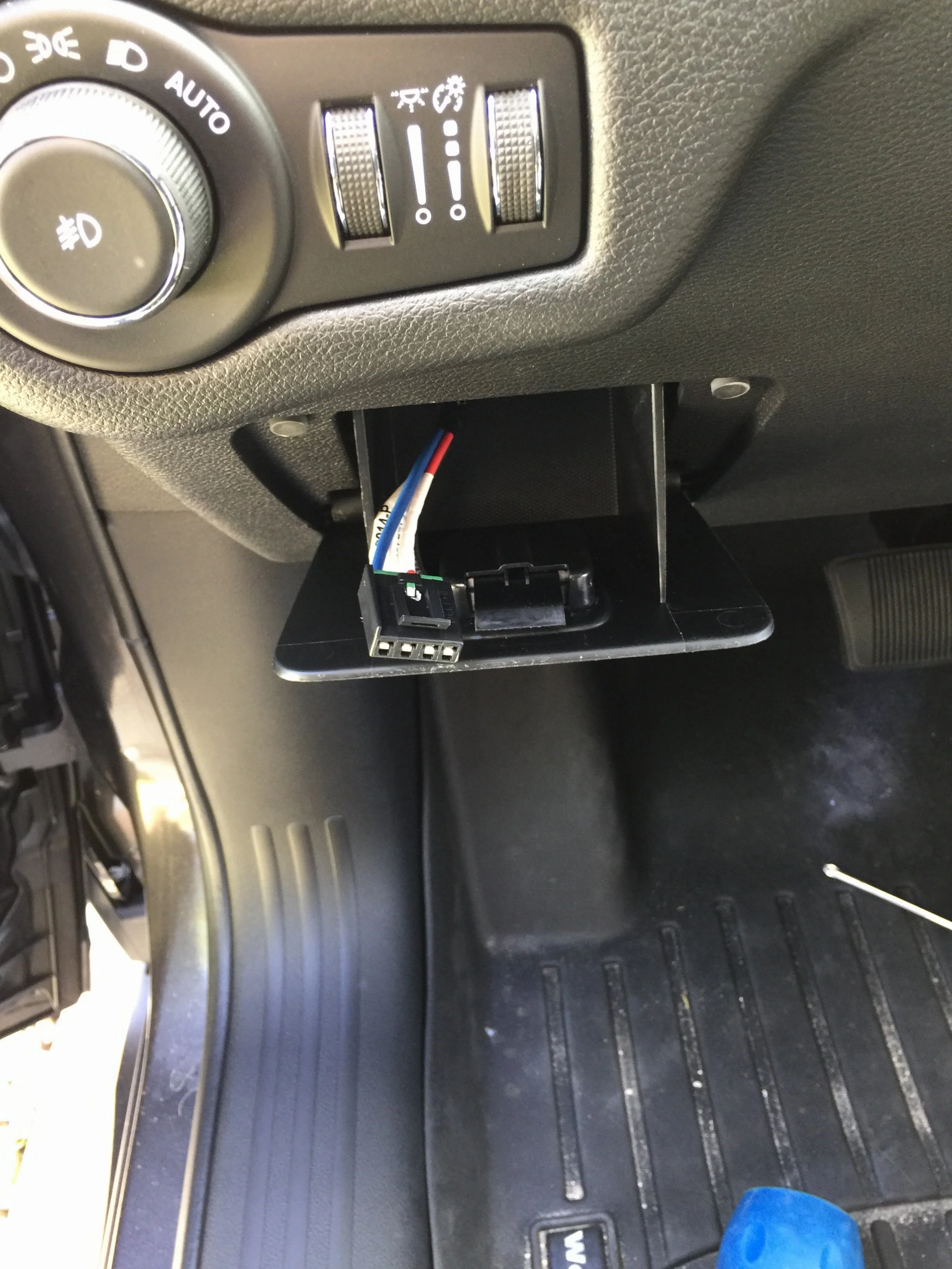

We went with the Tekonsha Prodigy p3. Bought it from etrailer on line. The tricky part was the plug-in wire adapter. There is not one that is verified to fit the 2017 Cherokee yet. (?) We ordered Tekonsha item # 3014p. Bill finally found the connector thing under the dash, and it looks like it will fit together. We watched utube videos to see where it was, and to see how to connect it. We plan to do it ourselves. If you have the tow package installed by Jeep wich has both the 4 pin and 7 pin heads, it is supposed to plug right in to both the Jeep and the brake controller itself. Then you just mount the controller where you can reach it. We will see. The connector plug was stuffed behind a bunch of wires, not easily accessible as most people found it to be. If you dont have the factory installed tow package, it is still doable, but not as easily. You would need more parts, too. We are waiting for it to arrive, and will keep you posted as to how it goes.

Well, yay! The Tekonsha is hooked up in the Jeep. The plugin wire adapter Tekonsha #3014p was the right one. Bill mounted it in the little cubby hole to the left of the steering wheel. (Lots of fuses behind that box). He actually popped out the plastic compartment and drilled a large hole in the back for the plug and put it back in. He zip-tied the plug up and out if the way. Beautiful fit! This is my first time posting pics, ss not too sure how this is going to go.
