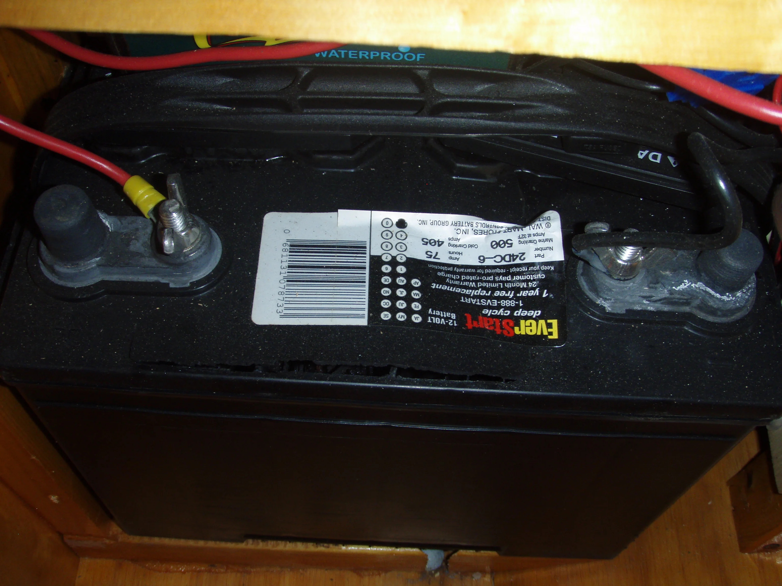

This pic is of the old battery when we took the wall apart and found out it was cracked open and one of the caps was popped off. It must have had some pressure to do that but at least there was no evidence of any acid leakage. The wood in the compartment is all perfect. That is except for the slight bit of water damage where the side marker light wires come through the outside wall but that has nothing to do with the battery. Another project. :)

I wondered why the galley had a sulfer smell. Note to self: Sulfer smell is bad. I knew nothing about batteries before last fall. When we put her in her storage unit we tried to turn on a light and nothing. We somehow found out where the battery was, took apart the wall in the under counter storage where the battery lives and saw that it was cracked open! I bet it was like that already when I picked her up. I am just glad nothing happened when I was sleeping in her.

Your battery tender likely cooked itself trying to charge a battery that couldn't hold a full charge. That is a common occurrence and a good reason to have your battery checked at the beginning of each season - never wait until it is about to die. It is a design flaw in the battery tender, which is why they moved it under the galley floor.
