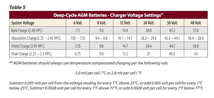

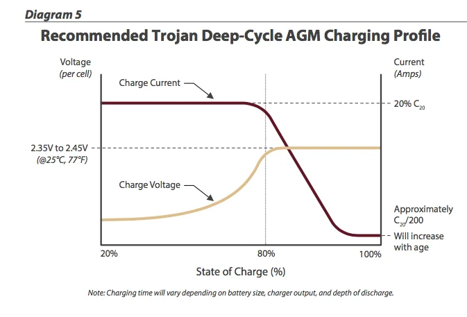

    here are a couple of charts from the Trojan (battery) user guide. I'm pretty sure there's no vehicle out there that doesn't come with an AGM battery that can match the needed charging profile. I think this is a pretty typical AGM battery charging profile.
    This is why our AGM batteries don't charge well on the road. I watch my battery's voltage and amps on the trimetric while it's charging (plugged in or solar panel) and there's just no way my car can do what the on-board charger or solar panel can do.

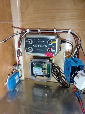

    Time for an update. I was unsuccessful with my indoor experiment - the power supply I have is a small one I use for desktop experiments and it could not handle the in-rush current when the CTEK charger turned on. The temperature is starting to get a little warmer and I moved Time Capsule into the garage to start work on installation of the charger. I was researching battery monitors over the winter and was leaning towards a Smartgauge for the fact that it does not need to be "calibrated" and maintained like the current measuring monitors. However I found a new on the market monitor that really spoke to the nerd in me. I bought a Simarine Pico One unit and will be installing it in the trailer. I'm feeling a little like a guinea pig because I can't find any reviews about how good it works for SOC since it is so new. I will be using it to monitor water tank levels and if it works well for the battery monitoring - I may purchase an expansion module to add things like indoor/outdoor temp, and amp usage/gain for solar or devices. It is expensive, but nothing is too good for the CI.
  15. Henry
    Henry Novice

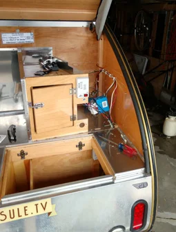

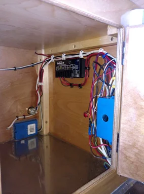

    Here is a picture of the existing solar controller in the right hand galley cabinet.
    Since the new hardware would require additional wiring, I was trying to figure out how to run them and finally concluded that I would have to remove the cabinet to get good access to the wiring. How come so many of my projects seem to require me to take things apart hmmm!
    Off comes the cabinet:
    Here is the wiring hole with most of the silicone sealant removed - not much spare room:
  16. Henry
    Henry Novice

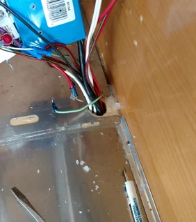

    Looks like a second hole is needed:
    Damage is done now - might as keep going. Here is a picture inside the cabin with the trim removed to see the existing wiring and new hole:

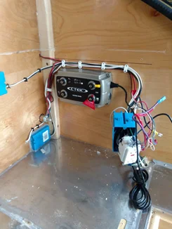

    CTEK charger mounted:
    Simarine shunt module mounted:
    Hopefully the temperature is warming up and I can go start wiring without freezing my fingers - heated garage would be great.
