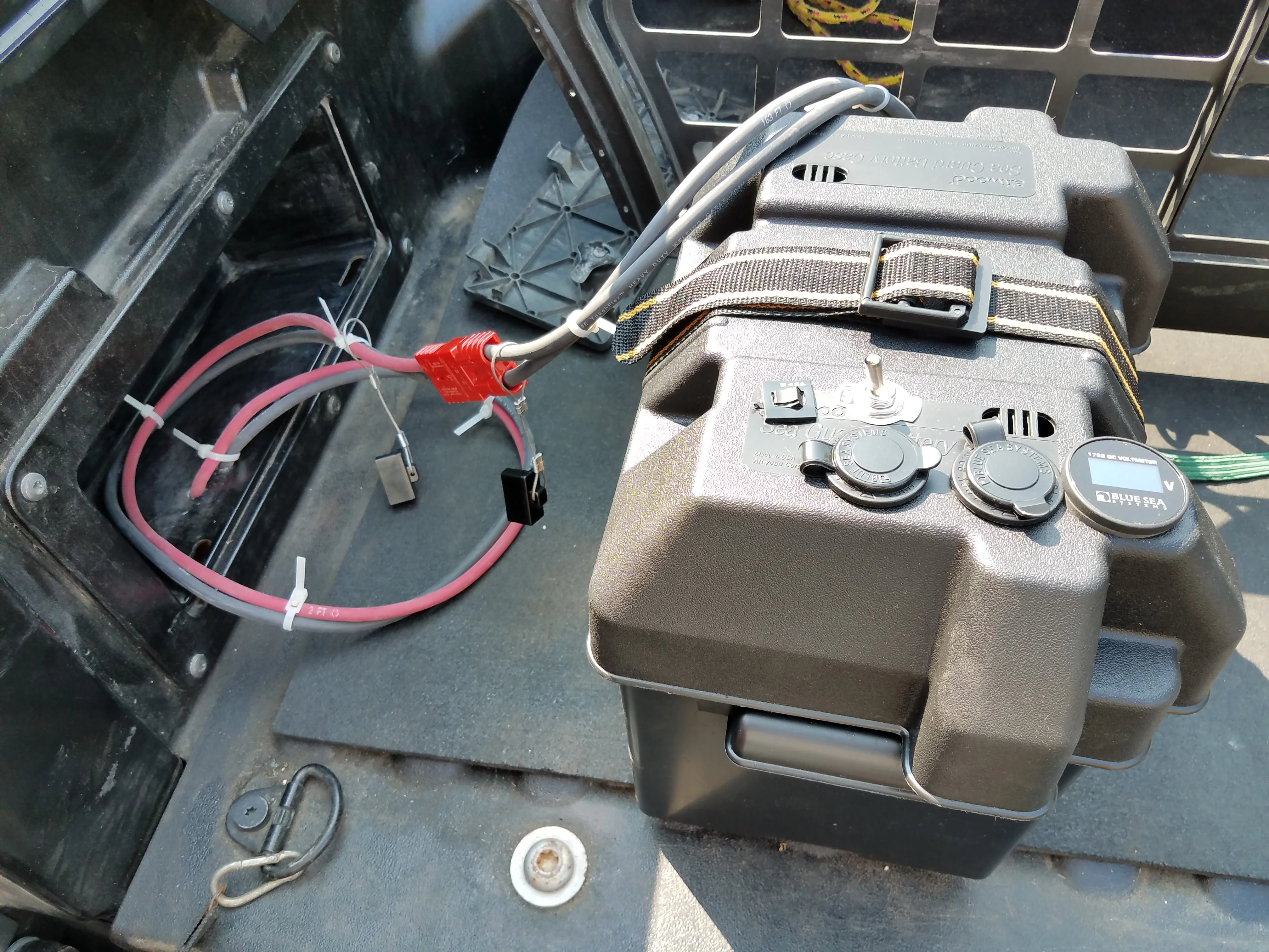

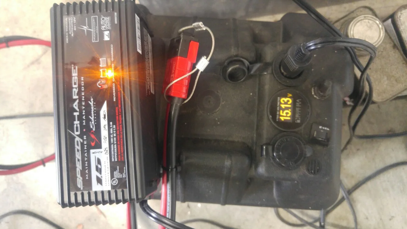

    I started by purchasing an Optima Deep Cycle marine battery, model D34M. I built up a box system using a box I had left over from a previous project, two power point sockets, a circuit breaker, switch, and a volt meter. It also has a 50 amp connector with #6 wire to connect it to the car.

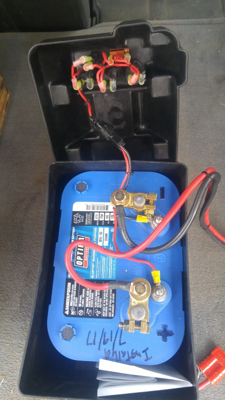

    Here is the wiring inside the box. I added a block of wood to keep the battery in place, plus it provides a place to keep the documentation for all the parts.

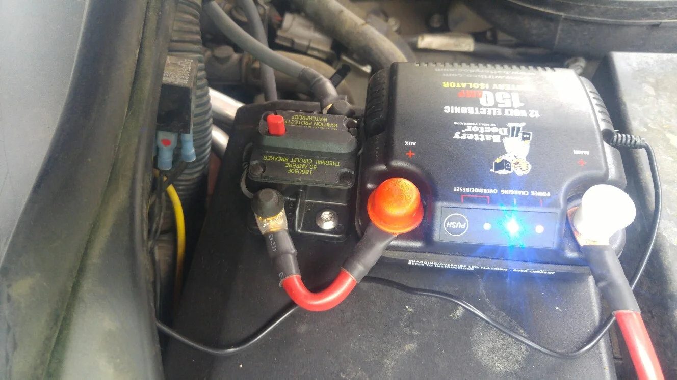

    Under the hood I added a battery isolator and a 50 Amp circuit breaker. The isolator is a Battery Doctor unit that keeps the two batteries disconnected when the car is not running, charges the auxiliary battery when it is running, plus includes a function that allows a "jump start" feature allowing the auxiliary battery to be connected to start the car if the main battery is too weak for the job.
    I then ran a #6 cable from the circuit breaker under the hood to the rear cargo area of the car, with a 50 Amp connector matching the one on the battery box. When we are ready to go, the auxiliary battery box goes in the back with the fridge, plugs into the car 50Amp connector to keep it charged, and the fridge plugs into one of the sockets on the box. There is a second power point for other stuff, such as charging a phone or whatever is needed. Also, a solar panel setup could be plugged in here to keep it charged. The voltmeter keeps track of the state of charge.
    For about $350 I now have peace of mind that we can keep our food supply fresh and be confident we can start the car when we are ready to move on.

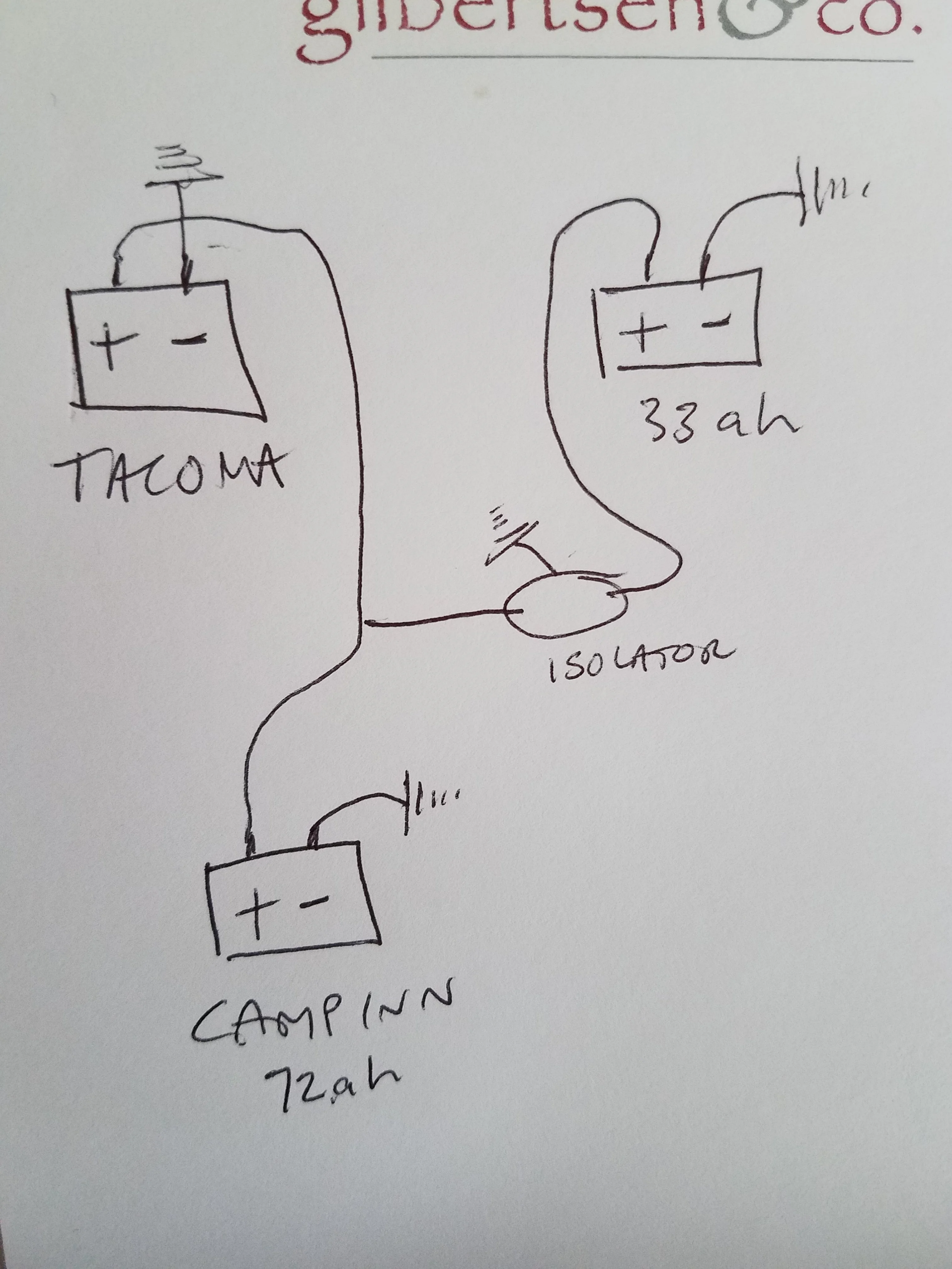

    Made a trip up to CampInn last week to have the larger AGM battery installed in the teardrop. Ours is a 2008 550, and was likely one of the last trailers made using the smaller, 33ah batteries according to the guys at CampInn.
    Craig did all the work : re-building the battery compartment to accommodate the larger battery, moving the fuse box etc., and adding both a cut-off switch AND external plug for the solar panel. (In the process, he discovered an issue with the brakes - one side was not working! Chris found and repaired a frayed wire. So, that made the 9 hours drive time there and back that day worth even more.)
    What I think I'd like to do is use the old 33ah battery in the TV to power the Dometic if/when we bring it along while out and about during a trip. I mentioned this to Craig and I think what he suggested was something very similar to what you've done. Basically, I'd keep the 33ah AGM in the bed of the pickup, set up to be charged by the truck. Including a way to top off the charge occasionally using the solar panel cable would be nice, too.
    I'd probably do as Craig suggested and tap into the charge wire supplying the 7 pin, and add an isolator in that run of wire going to the old 33ah battery in the truck bed. That way the truck battery would be protected from the set up.
    Would this configuration keep my trailer battery separate from the old 33ah battery?
    Sound like a workable option?

  6. Ken & Peggy
    I talked with Craig since, and his suggestion, based on my likely use of the Dometic while in the TV, would be to put the isolator up near the TV battery in order to protect it.
    I could add a female DC plug as a power source mounted in the truck bed. Then, I can put the old 33ah battery in a case that would include the following:
    - a female DC plug
    - a solar cable plug
    - a pig-tailed male DC plug
    This would allow me to charge the 33ah battery while in the TV:
    - using the male pig-tailed plug connected to the female plug mounted in the TV
    OR
    - using the solar panel and its plug (to give it a full charge every so often)
    Craig felt that, as long as the batteries were never deeply discharged, the disparity in the capacity(ah) and/or types of batteries shouldn't be a concern.
    Sounds reasonable to me. Any concerns for the electrical engineers?

    My big concern with this is the amperage capacity of a "DC plug mounted in the truck bed". If the auxiliary battery is low on charge and the TV is started, there can be a lot of current applied to charge the battery. Definitely add the battery isolator and some circuit protection appropriate for the wire size you use - either a circuit breaker or fuse.

    In this picture of yours, is that just a connector placed in between the auxilliary battery and the battery cover? Just to make it easier when constructing and servicing/changing the battery?
    Ken

    Indeed, that is exactly why I put that connector there. Several times when fiddling with it, I wanted to disconnect the cover, so I added the connector. (Confession - I have almost as much automotive electrical and mechanical bits in my shop as my wife has thread and fabric in hers. :cool:)

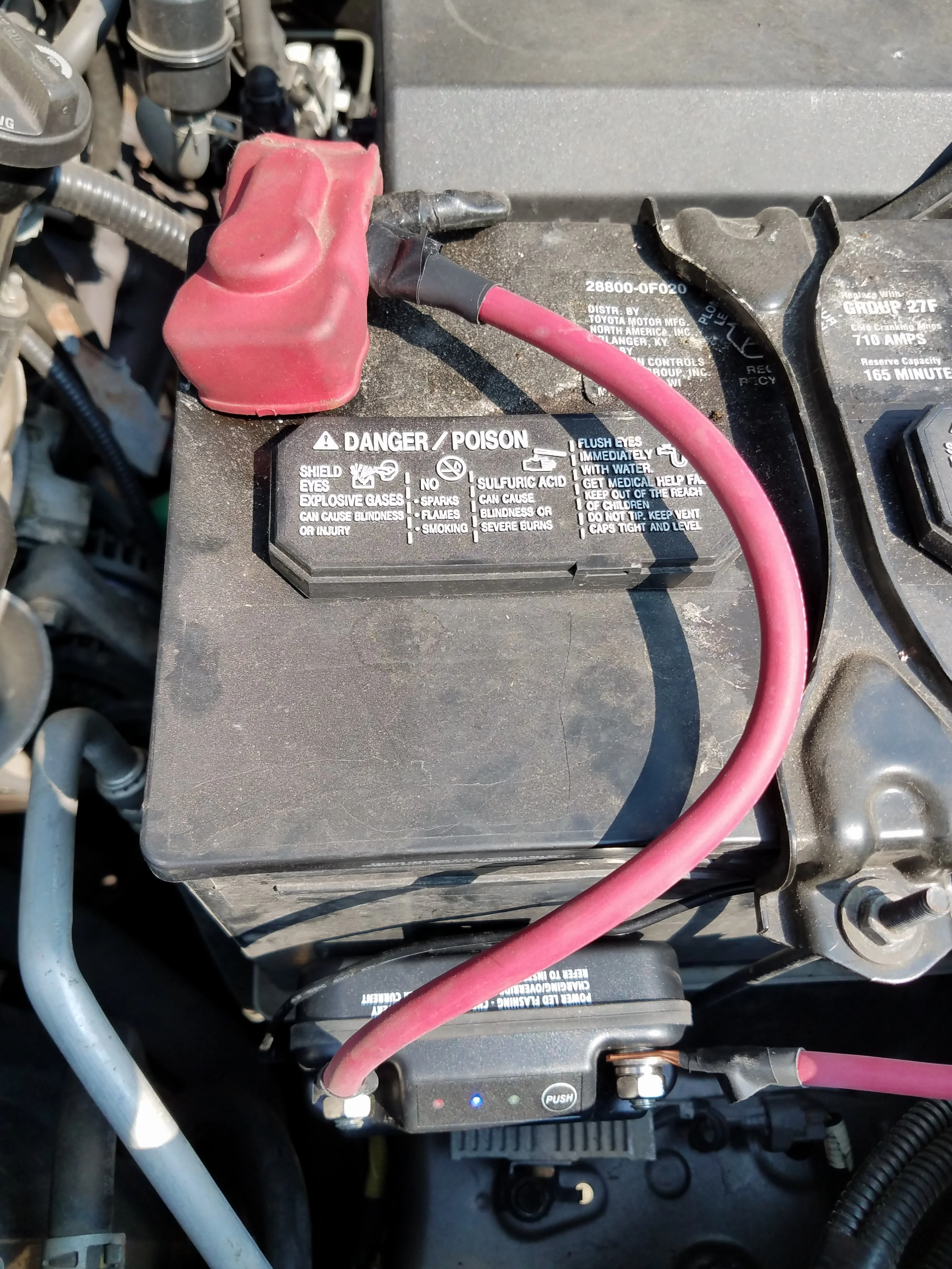

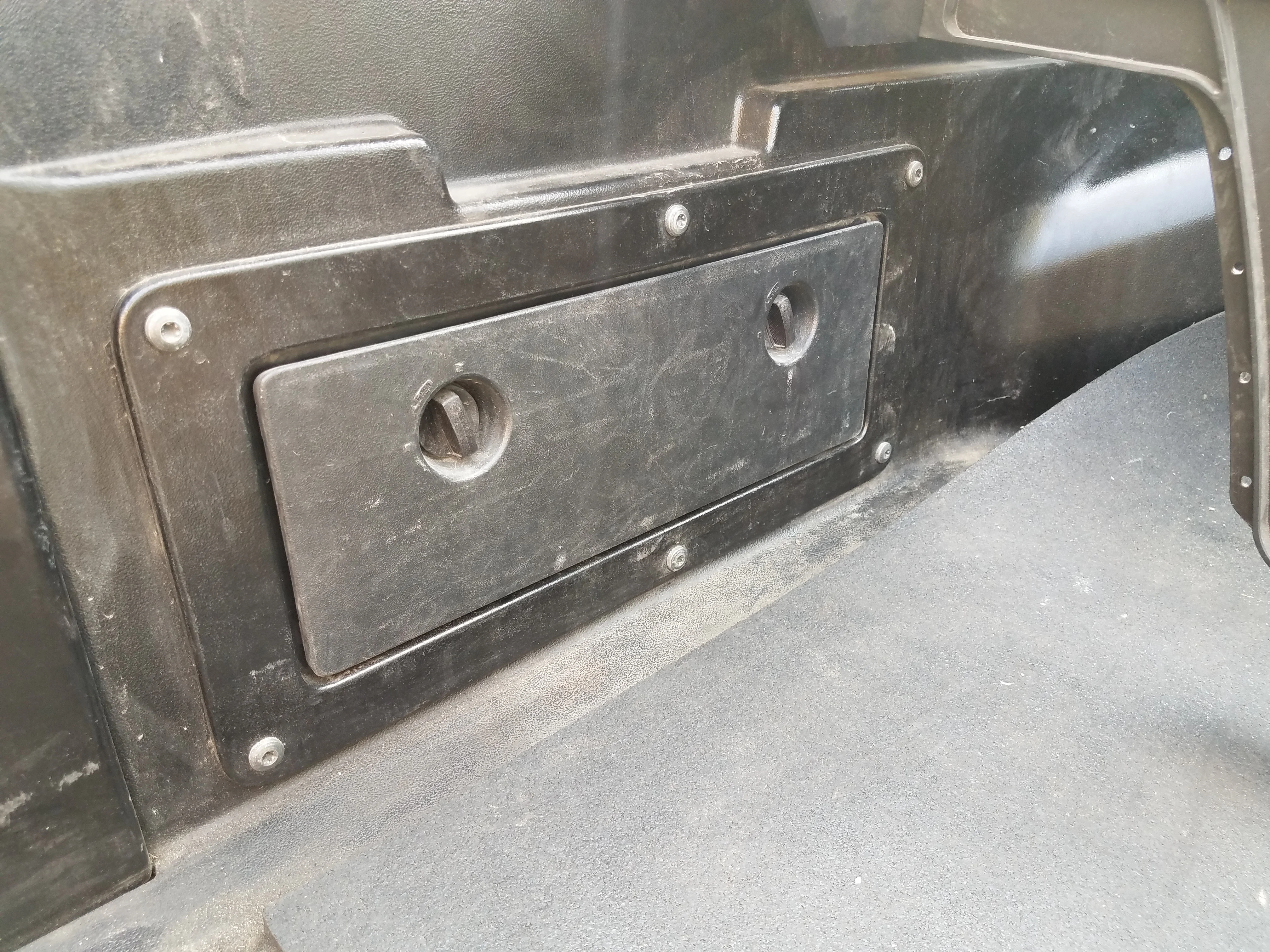

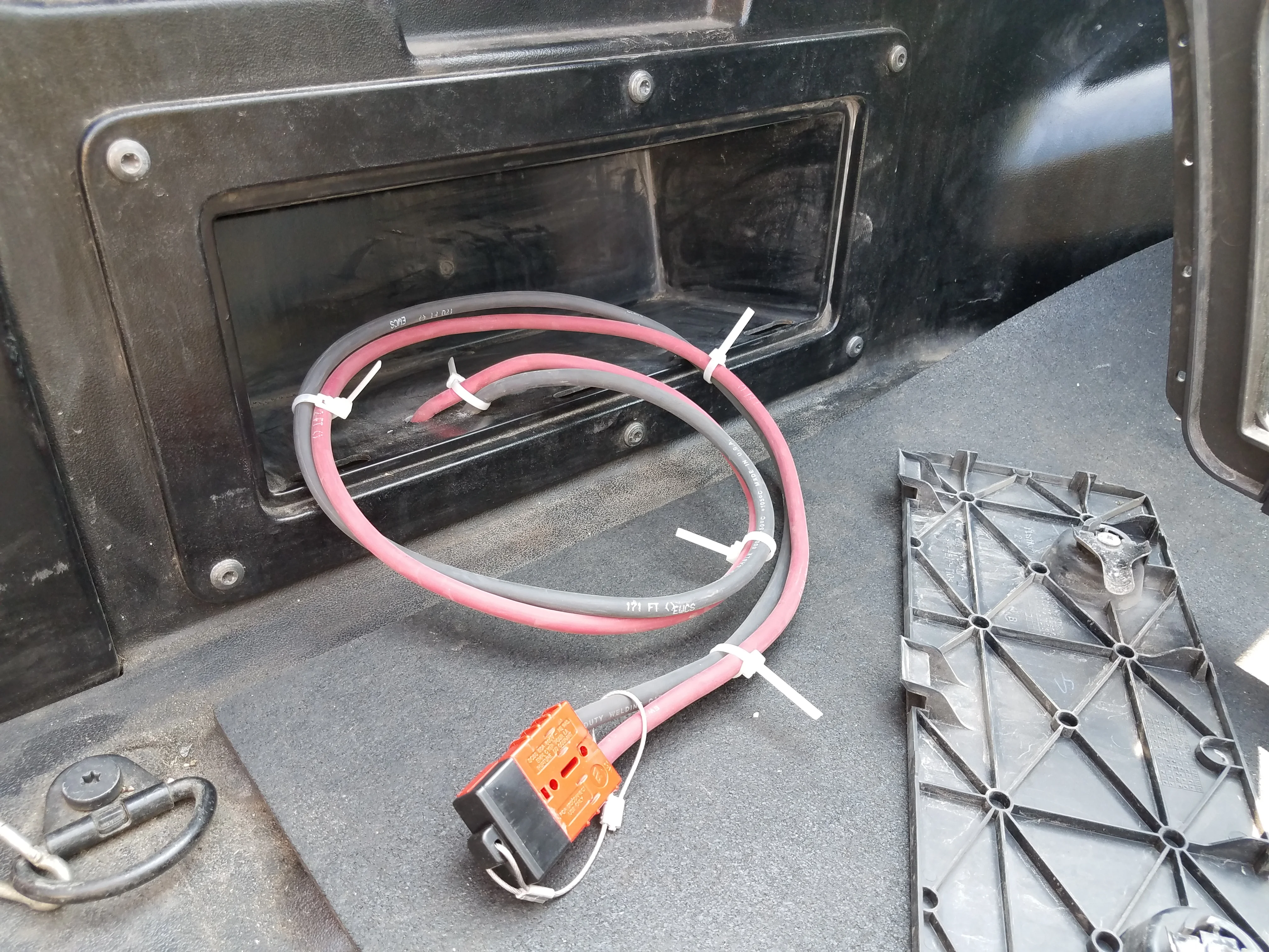

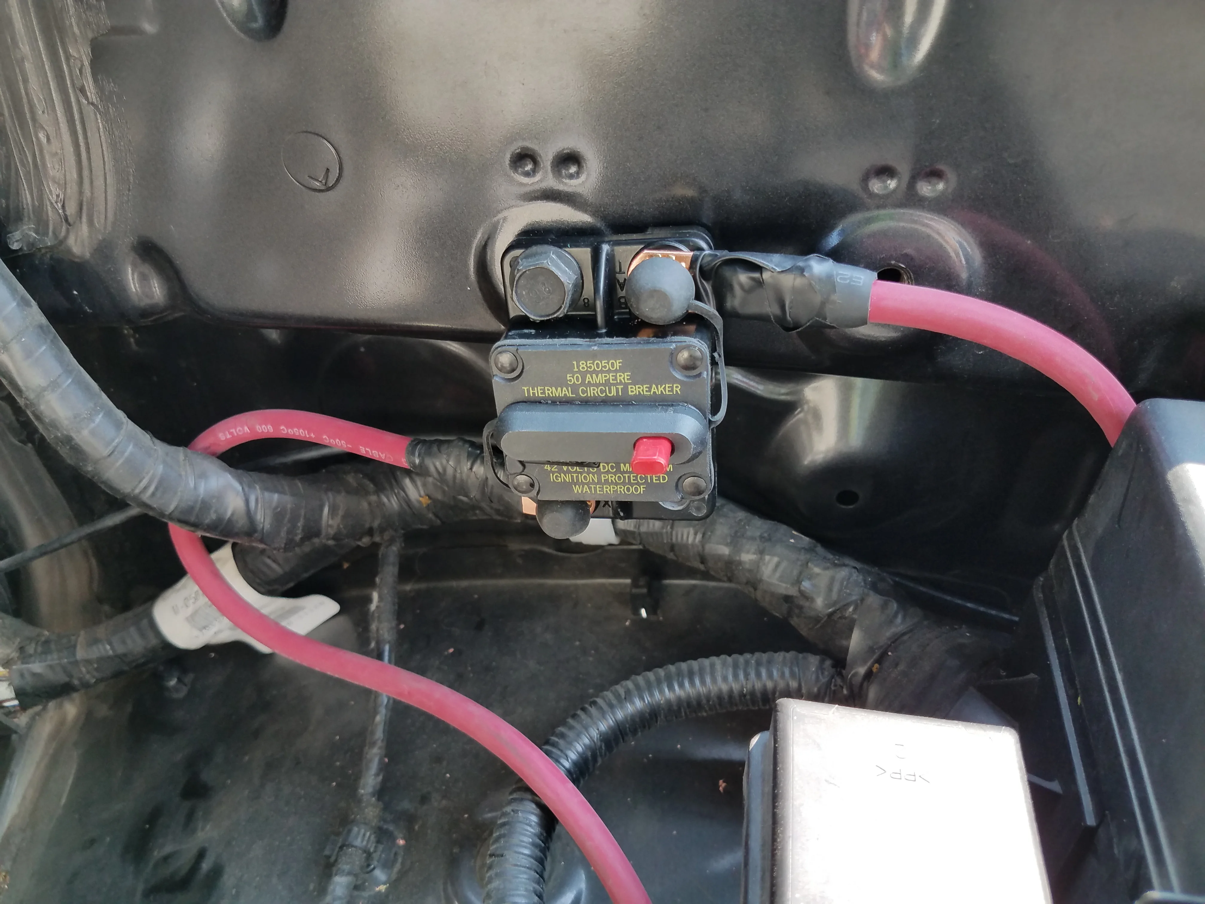

    The better part of my day was spent completing the job of wiring the truck to be able to power/charge an auxiliary battery in the truck bed used to power our new Dometic. Let me first thank you, rotus8, for your untiring willingness to answer every little nitpicky question I had along the way. I could not have completed this project without your help.
    Here are a few pics of my setup...
    Tow vehicle battery-
    20170910_142420.jpg Detail of isolator-
    20170910_180933.jpg 50 Amp breaker on engine compartment sidewall-
    20170910_142436.jpg Truck bed accessory compartment door-
    20170910_141839.jpg Power cables from TV battery-
    20170910_141918.jpg Hookup to auxilliary battery-
    The voltage (at idle) remained pretty constant from the TV battery back to the AUX battery - 13.70 volts.
    Next up will be testing the ability of the solar panel to charge this same AUX battery through one of the cigarette lighter adapters in the AUX battery case. I am really liking the idea that I will be able to charge a dead TV battery with the solar panel, too.
    Thanks again, Ted - you, sir, are the man!
