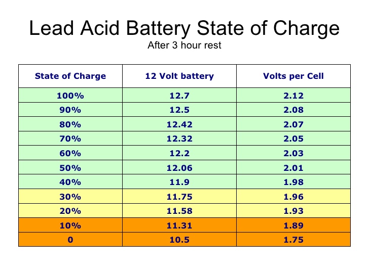

  17. Sorry photo of the chart didn't attach...
    Also, the nomenclature/marketing of these batteries can be confusing. If it says Deep Cycle" and is marketed as such, but provides 650-700 cranking amps in its specs, then it is a Hybrid/Marine battery, and not a dedicated Deep Cycle. Even many batteries sold on solar websites (which should and could be a true Deep Cycle, with no necessary cranking capacity) still contain this feature. Which means that it has thinner plates to provide the cranking amps and shouldn't be taken below 50%.
    Kevin likes this.

  19. Thanks ferlane; I missed this one. I think I might have confused it with another Trojan Marine model. There are no cranking specs assigned to yours, which is a very good indicator of its deep cycle properties and long-term robustness.
    However, in the online literature, I couldn't come up with with any info that would indicate that you could take it below the nominal 50% Depth of Discharge that we can with other cheaper Marine Deep Cycle batteries of the same A/hr rating. Did yours come with any cautions about what voltage you safely can take it down to?
    The extra years you can likely get out of an AGM like yours (when properly fed) are certainly a selling point for me, when they are balanced against the higher upfront cost. Even if it ends up being a 'wash' on the economics side, there is still less waste/recycling, less future shopping, less hassle. What would really seal the deal is one that I can also discharge further than 1/2 way before it needs recharging.
    Unless I have misread the information out there, I believe that all flooded and AGM DCs stop (or should be stopped) at 50%. The only ones able to get further and into the 20% DOD range are the on-board lithium crowd, a la Troutbum, which, as a complete electrical system re-think, and not just a battery replacement, is a non-starter for many of us.
