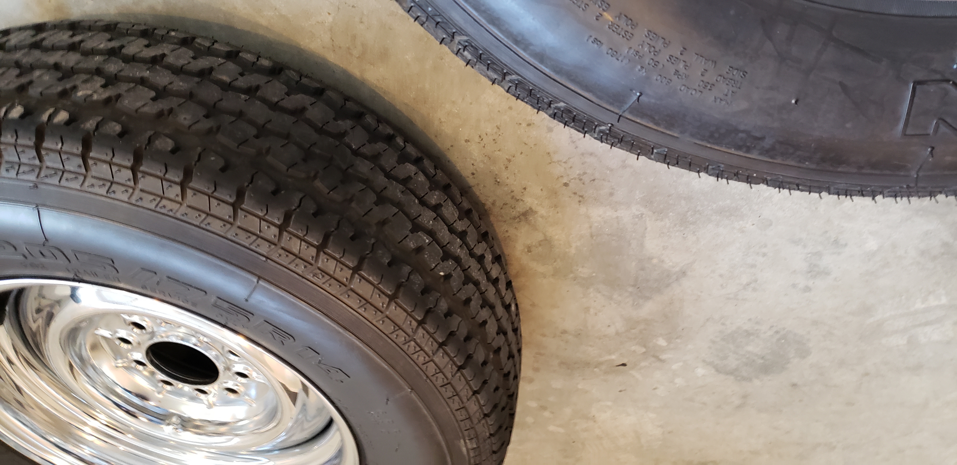

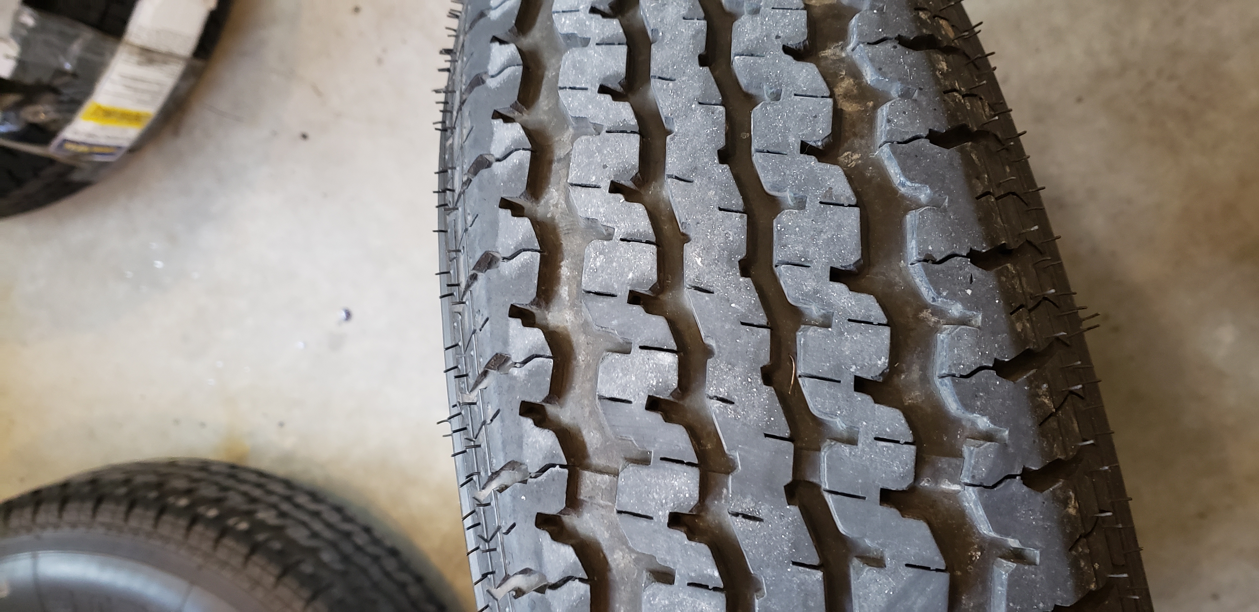

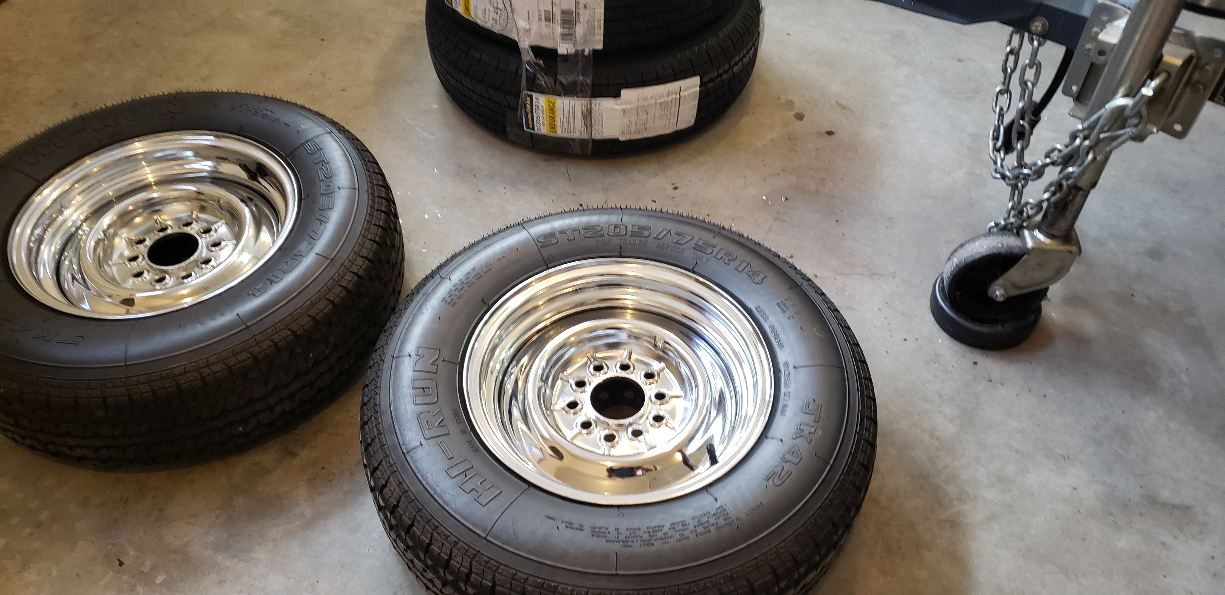

    I have my original 2013 tires coming off and getting the new Goodyear Endurance mounted and balanced. I just purchased this in July 2021 from the original owner and he said the tires have 2,000 miles on them at best. The tread is great, was always garaged so there is no weather checking on the sidewall but, the age makes it mandatory for replacing.
    Its also a great time to look underneath ...do a good cleaning, greasing the stabilize rs, replacing the front wheel, etc.

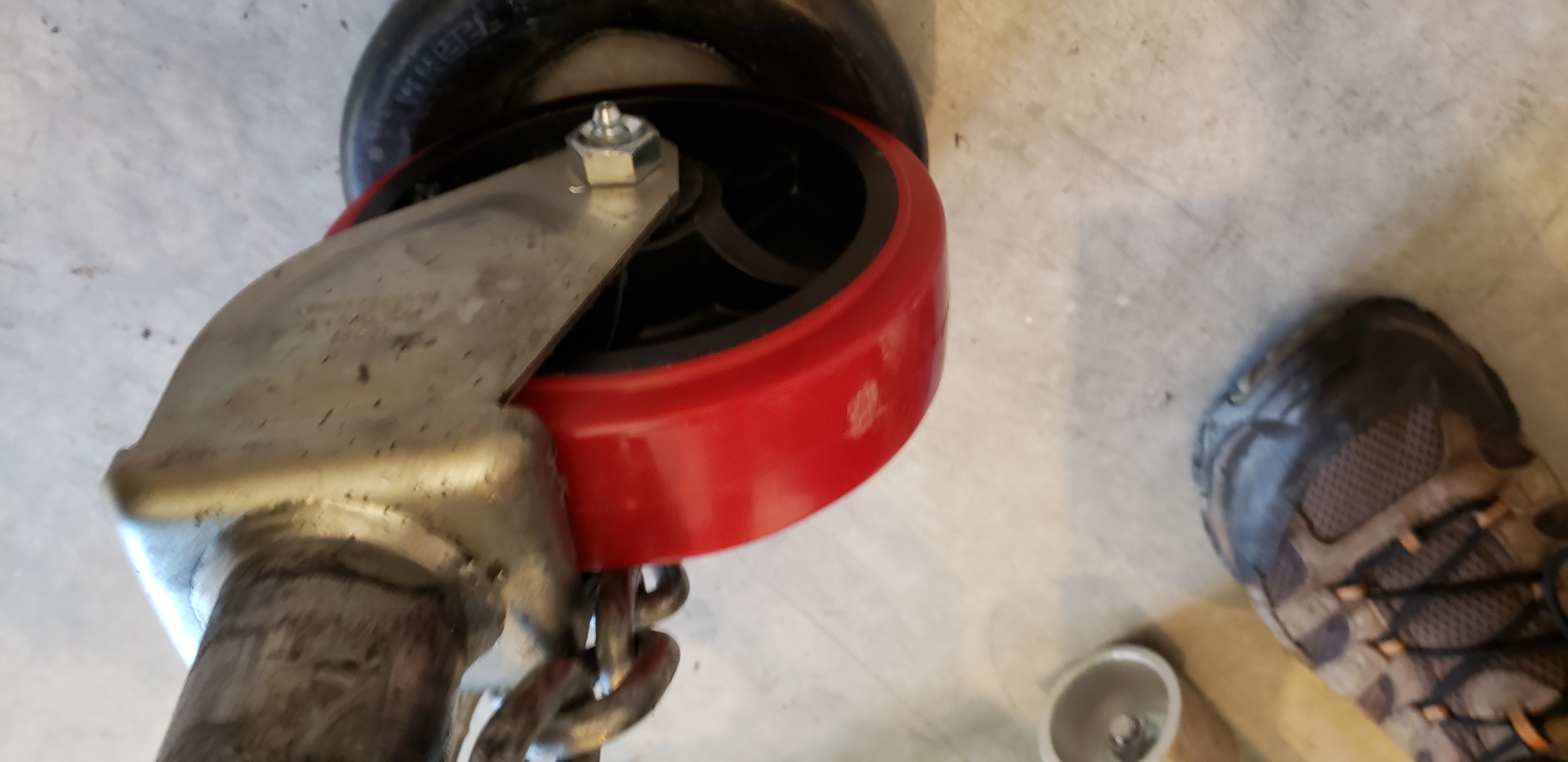

    So how are you going about replacing the front wheel?

    To replace the front swivel wheel,
    1. walk out to the garage
    2. open garage door
    3. walk to the tool box
    4. pull open 3rd drawer on bottom chest
    5. remove sockets and wrench
    6. close 3rd drawer on bottom tool chest
    7. walk ..don't run to garage that the Camp Inn is stored in (safety first)
    8. lower the back stabilizer jacks to allow front end to be lifted
    9. jack up front of Camp Inn Ultra
    10. walk back to first garage and get the jack stand I forgot
    11. again walk ..don't run to garage that the Camp Inn is stored in (safety first)
    12. slide jack stand under front frame of Camp Inn
    13. lower the frame onto the jack stand
    14. remove the nut from the bolt passing through the swivel jack wheel (lefty loosey)
    15. pull bolt out of wheel hub
    16. drop the wheel from the swivel jack
    17. slide bushing into poly wheel
    18. place replacement wheel into the opening in the swivel jack
    19. slide bolt through assembly
    20. place washer and nut onto bolt
    21. tighten bolt with socket (righty tighty)
    22. jack up Camp Inn 550
    23. remove jack stand
    24. lower jack
    25. walk back to first garage with sockets, wrench, and jack stand
    26. wipe down tool and put away
    27. walk back to garage where the Camp Inn is in storage
    28. reach into garage refrigerator and grab a cold Upper Peninsula "Yooper" ale
    29. stand back and admire a job well done

  6. Jim Carter
    That is entirely more detail than I was expecting. I was thinking more along the lines of what do you replace it with and where do you get it. :)

  7. Lipster
    Lipster Junior Ranger
    6" replacement caster wheels are available on Amazon and E-Trailer for about $16.

    campdude Ranger
    Lol Jim...I knew what you were asking...I purchased a 6" urethane caster with a greasable through bolt.
