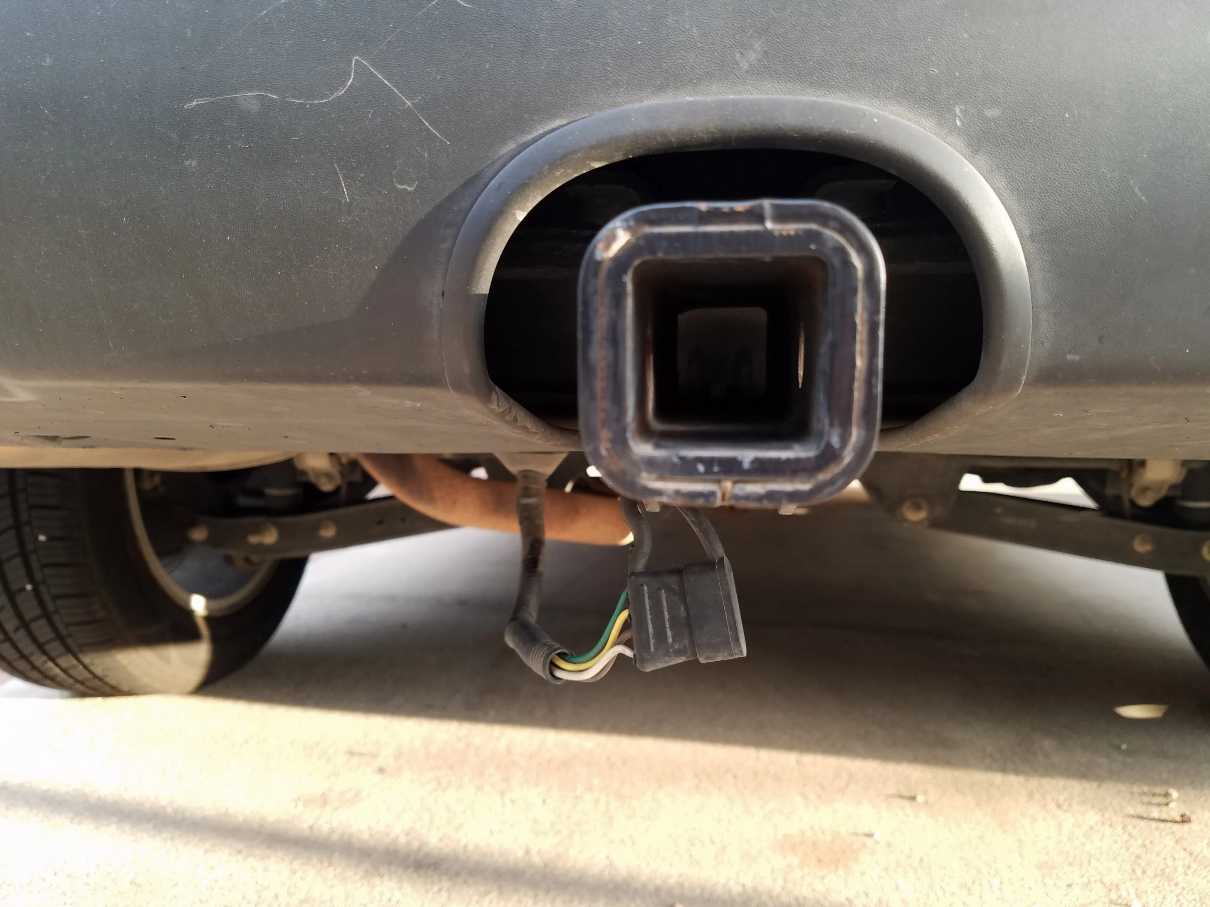

    We have a 2012 Subaru Outback 2.5i, which has a hitch integrated into the bumper. I assume this is a factory installed hitch (we're not the original owners). It currently has a 4-pin connector, and Cary told me that we will need to get a 7-pin adapter installed and wired (except the brake controller wire for the Autobrake brake controller). I'm unsure where we should take our car to have the 7-pin adapter installed: our regular car mechanic? I'm also wondering where the 7-pin connector should go on? There isn't an obvious place for it in line next to the hitch with the integrated bumper.

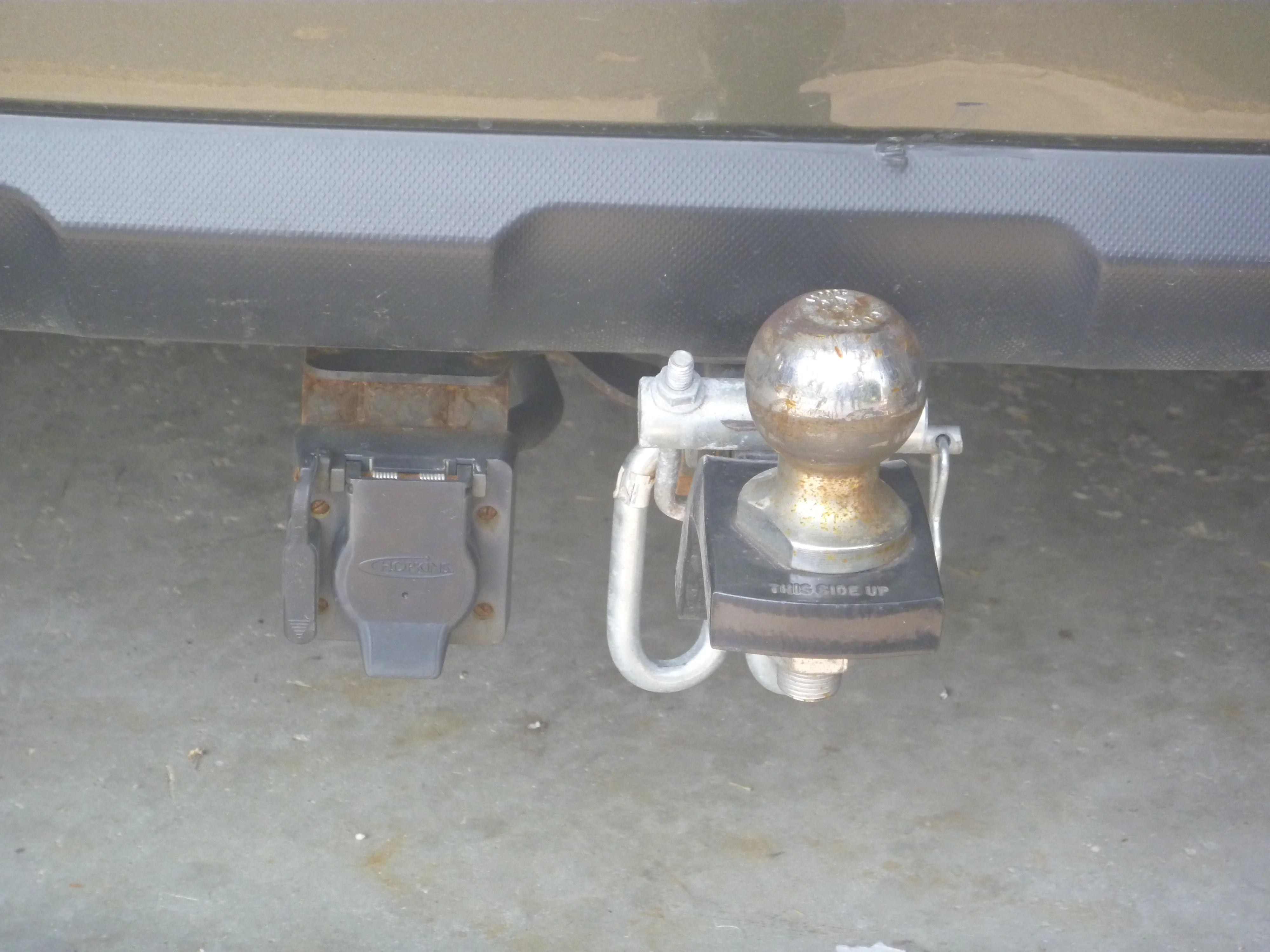

    We have a 2015 Outback with factory installed hitch and 4 pin. I ordered 7 pin through Etrailer. Our mechanic installed it. I did call several other mechanics who also said they would install it. Rv centers also may install it. Ours is located next to the 4 pin.

    Curious how your setup looks. I can't figure out where the 7-pin would go? This is what our hitch looks like in the bumper.

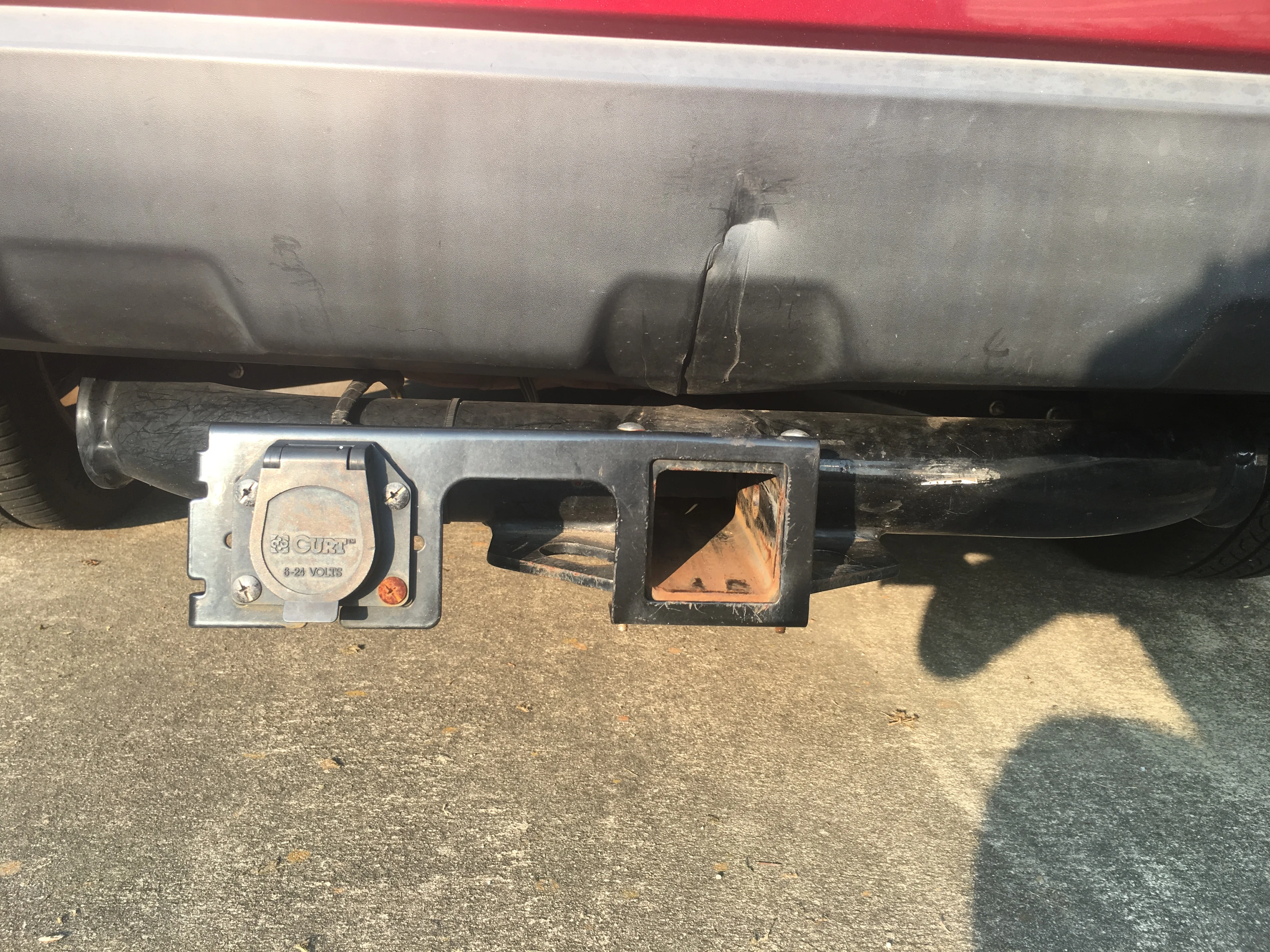

  4. Our hitch was added as an after market by a place recommended by the Subaru dealership. We took it back to the same place we needed to add the 7 pin. And if you look at the bumper, you can see what happens when you don’t hitch the Camp Inn properly.

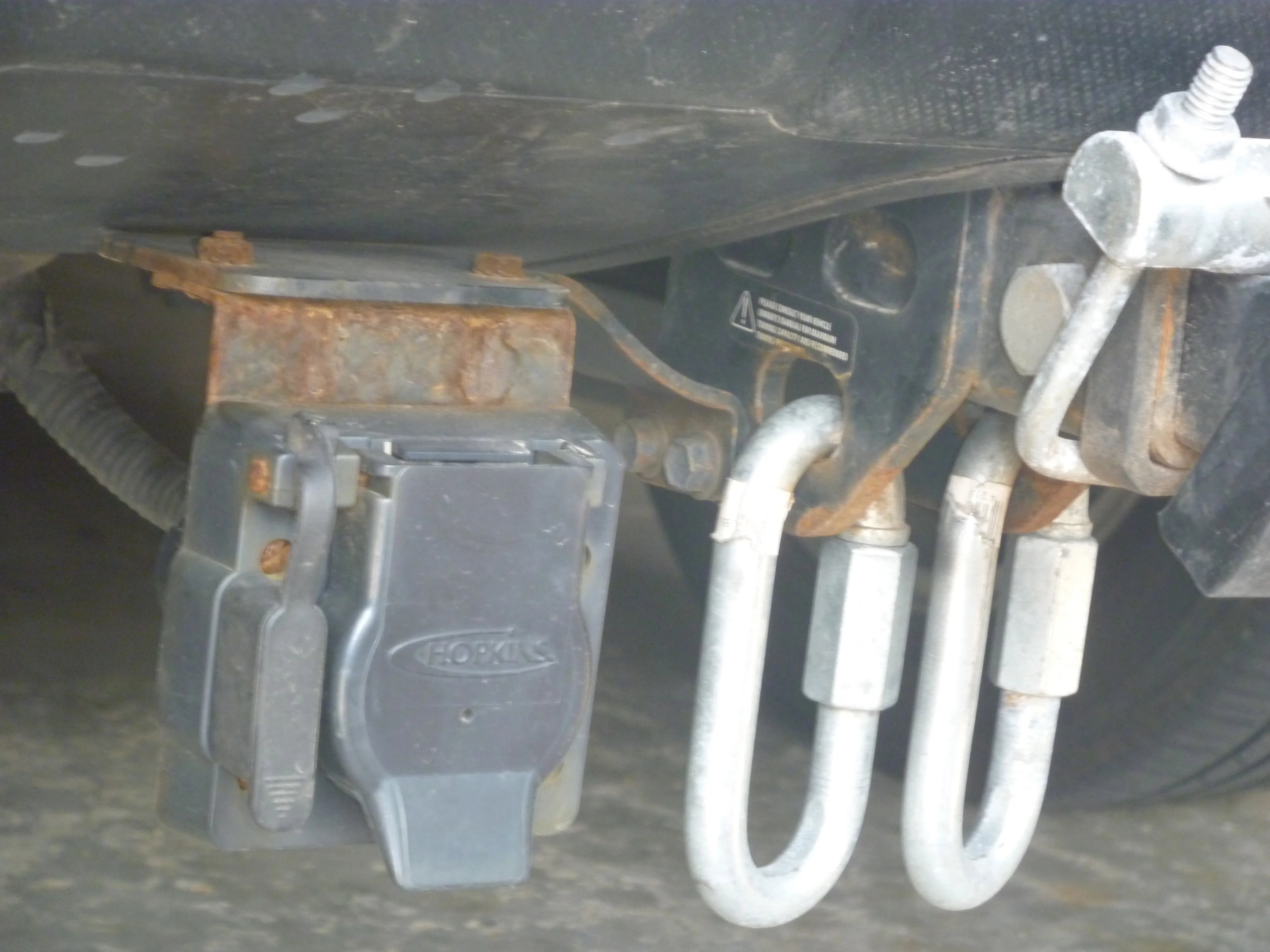

  6. klint74
    klint74 Novice Donating Member
    It appears that the 2015 hitch has changed from your model. P1040620.JPG P1040623.JPG P1040623.JPG
  7. sarmay
    sarmay Junior Ranger
    Thanks! The part where you have the plate for attaching the 7-pin connector seems to be the same/similar. It's the notch in the bumper that is different. I'll take a look at it closer tonight to see if it looks like we can mount it underneath the bumper.
