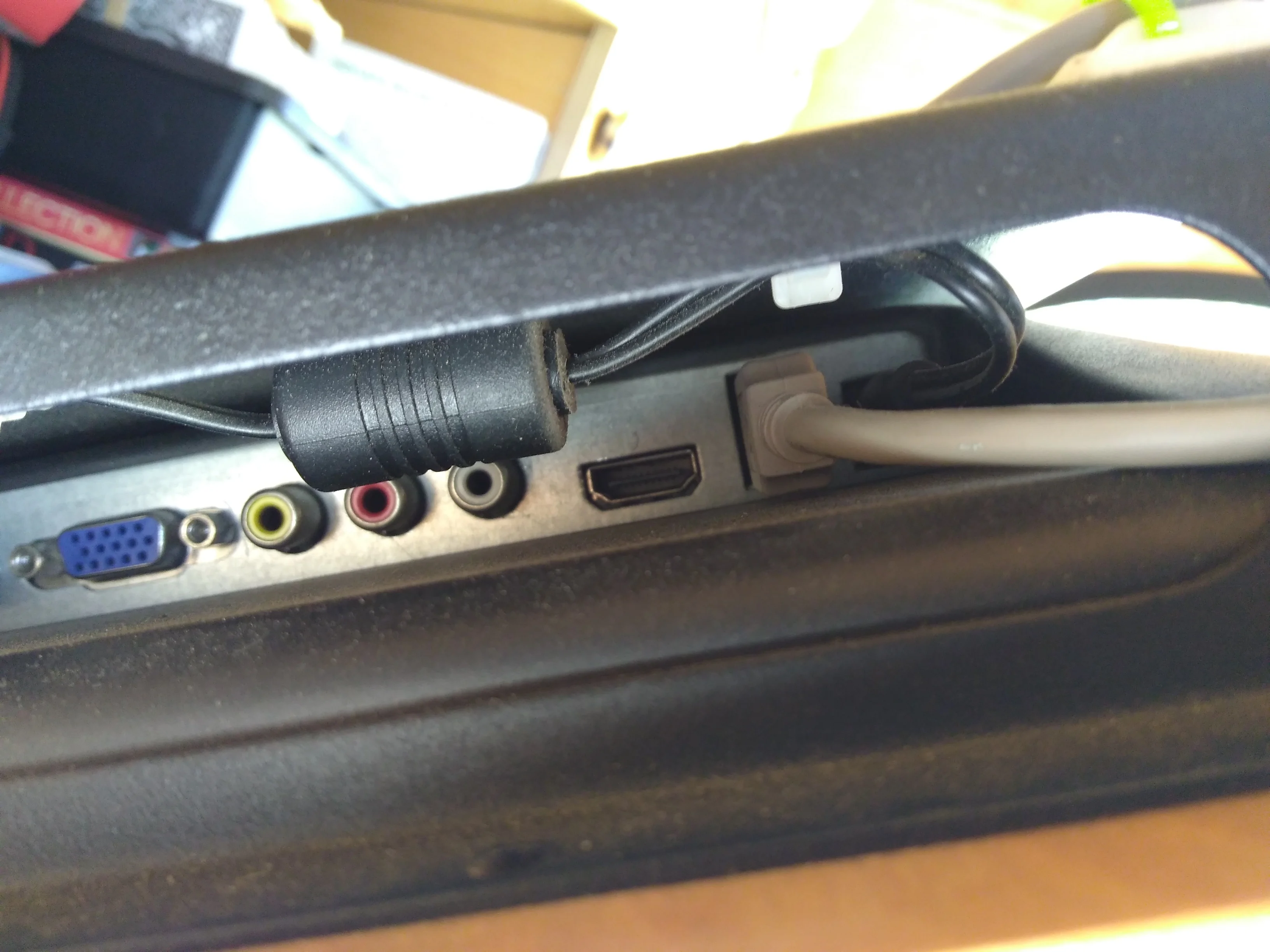

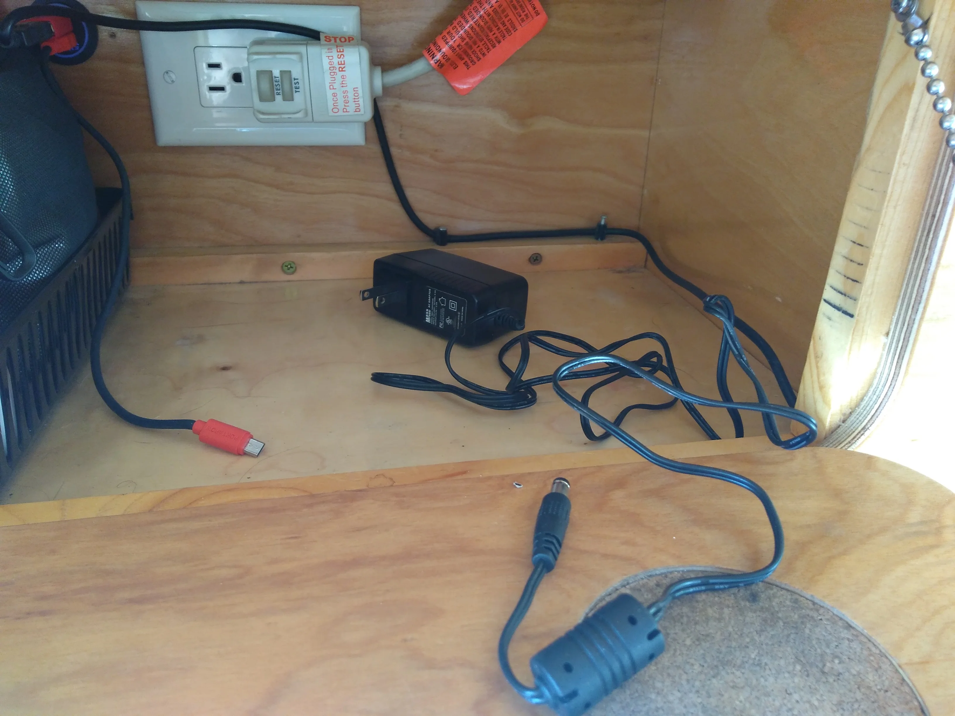

    This picture shows new power supply, existing 110v duplex outlet, and an existing USB extension cord that is routed along the bottom of the television to the cabinet on the far side of the television:

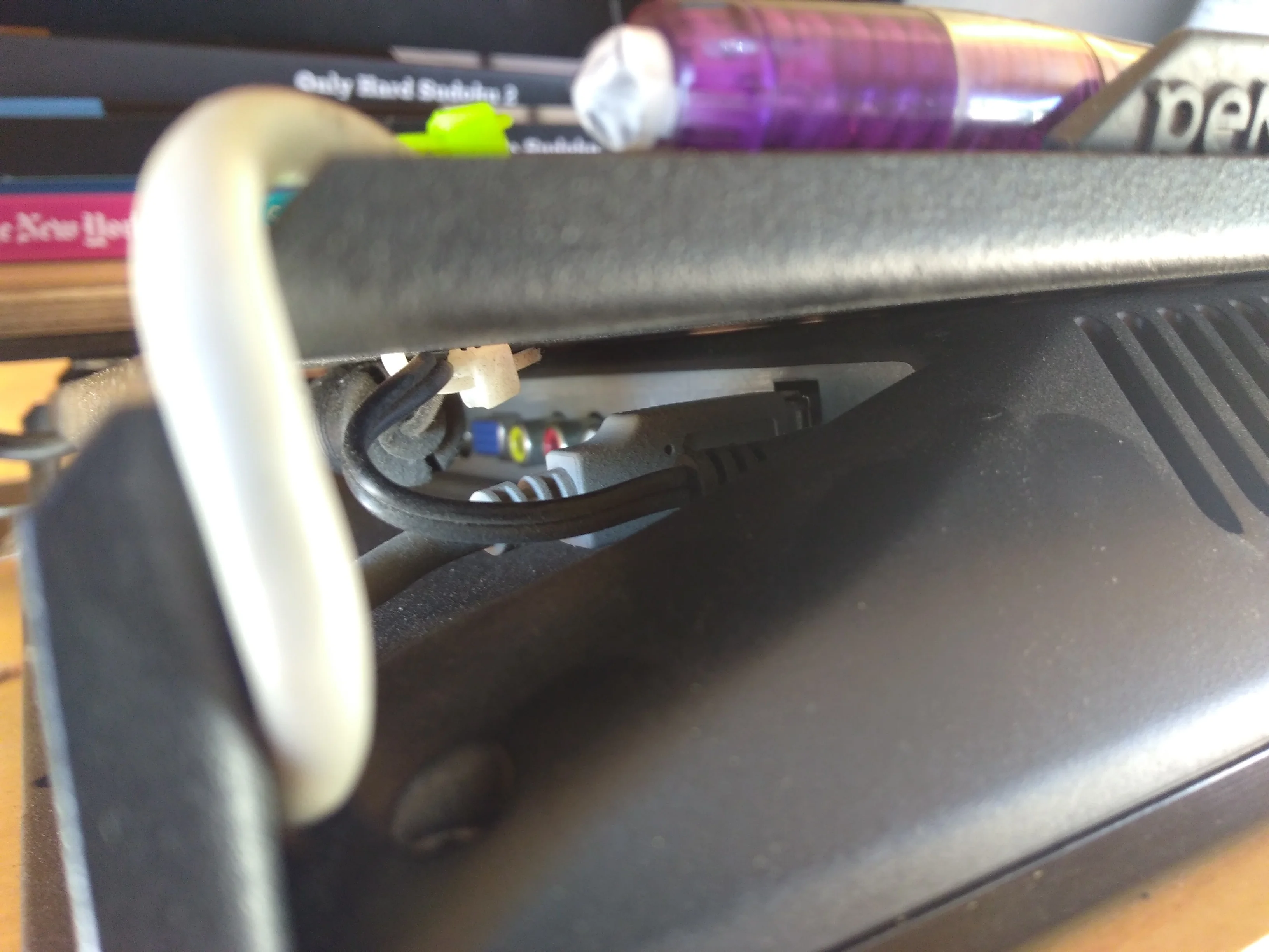

    The plug for the existing factory 12v wiring:
    The new wiring from the 110v power supply (the old wiring is still in place behind this):

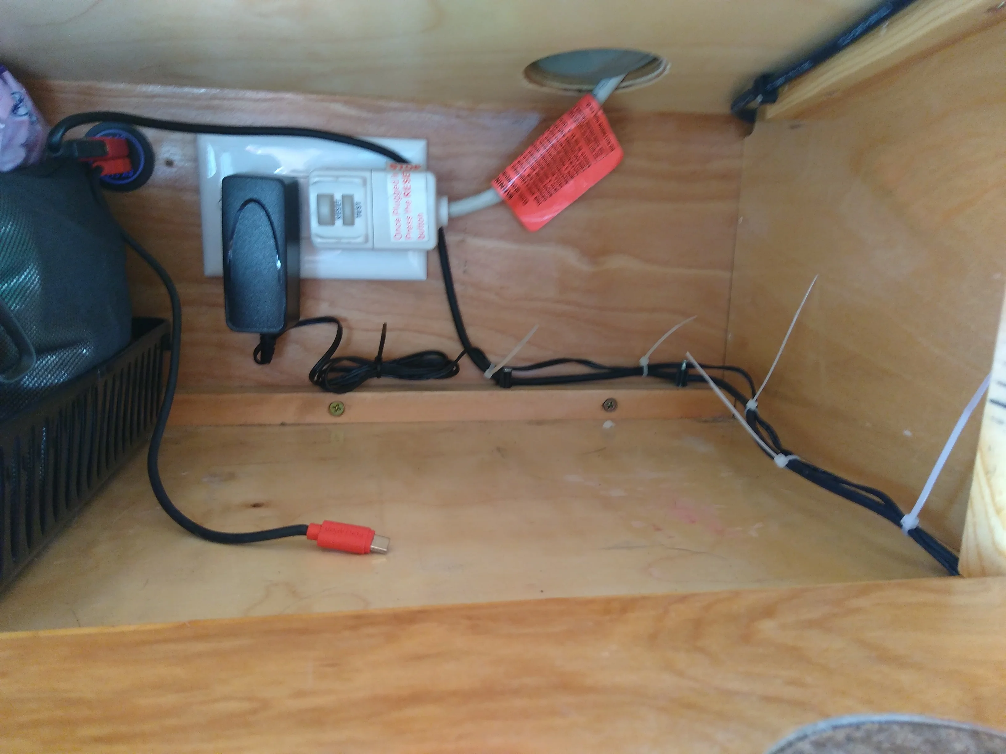

    Securing the wiring in place:
    Securing the wiring in the cabinet:

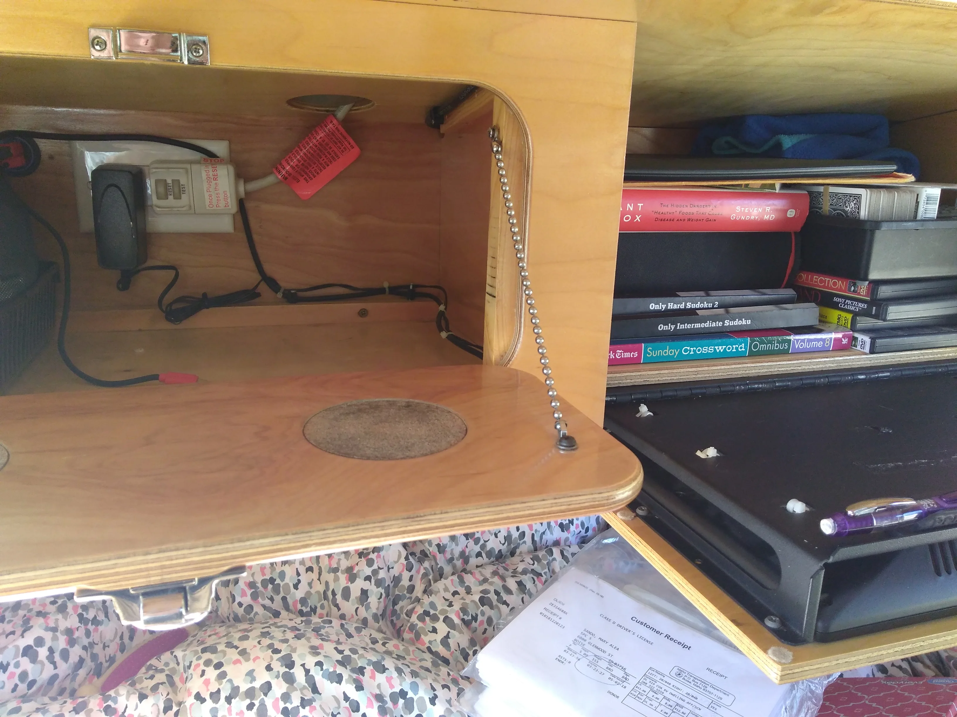

    Everything trimmed up and working:
