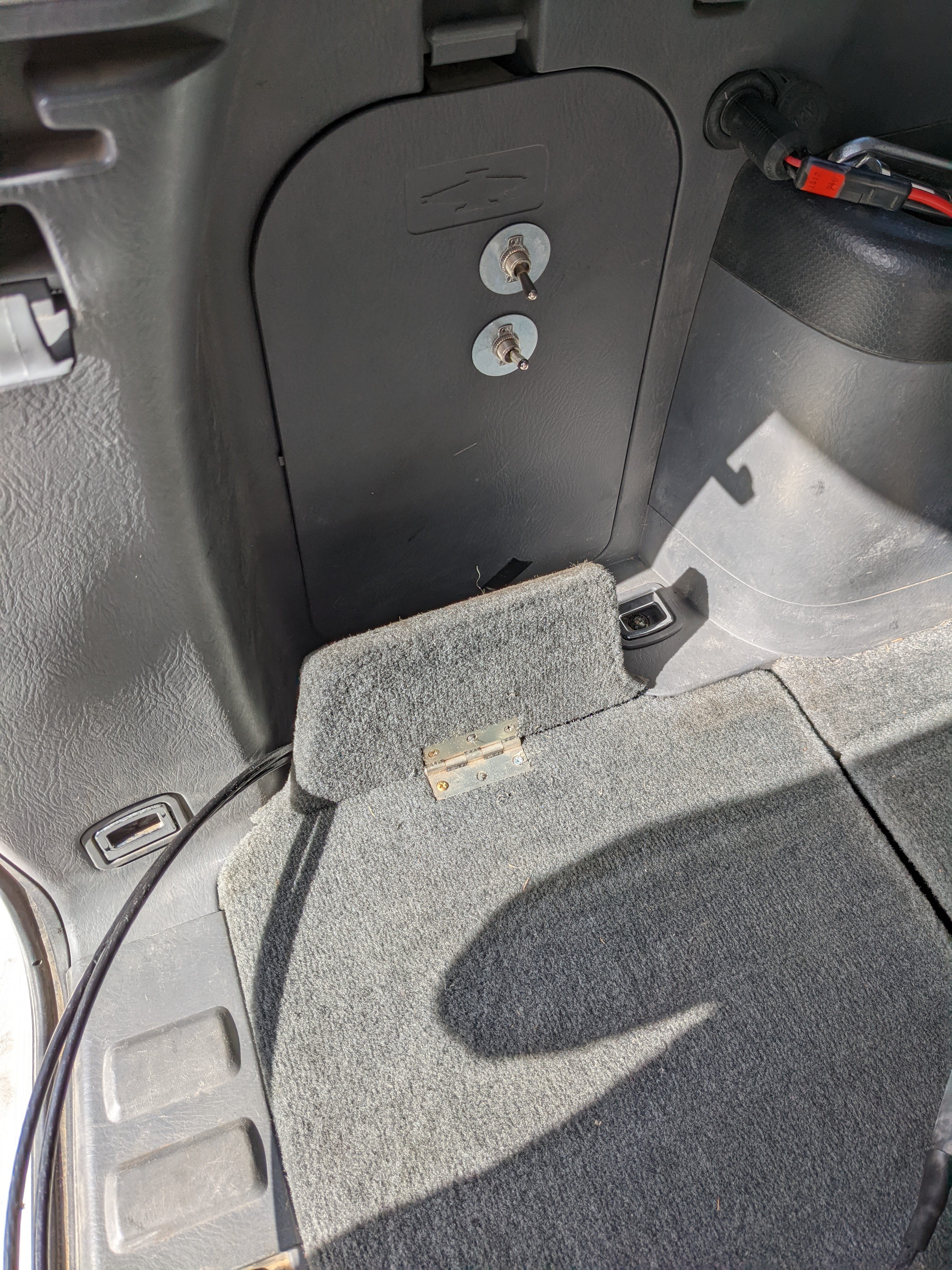

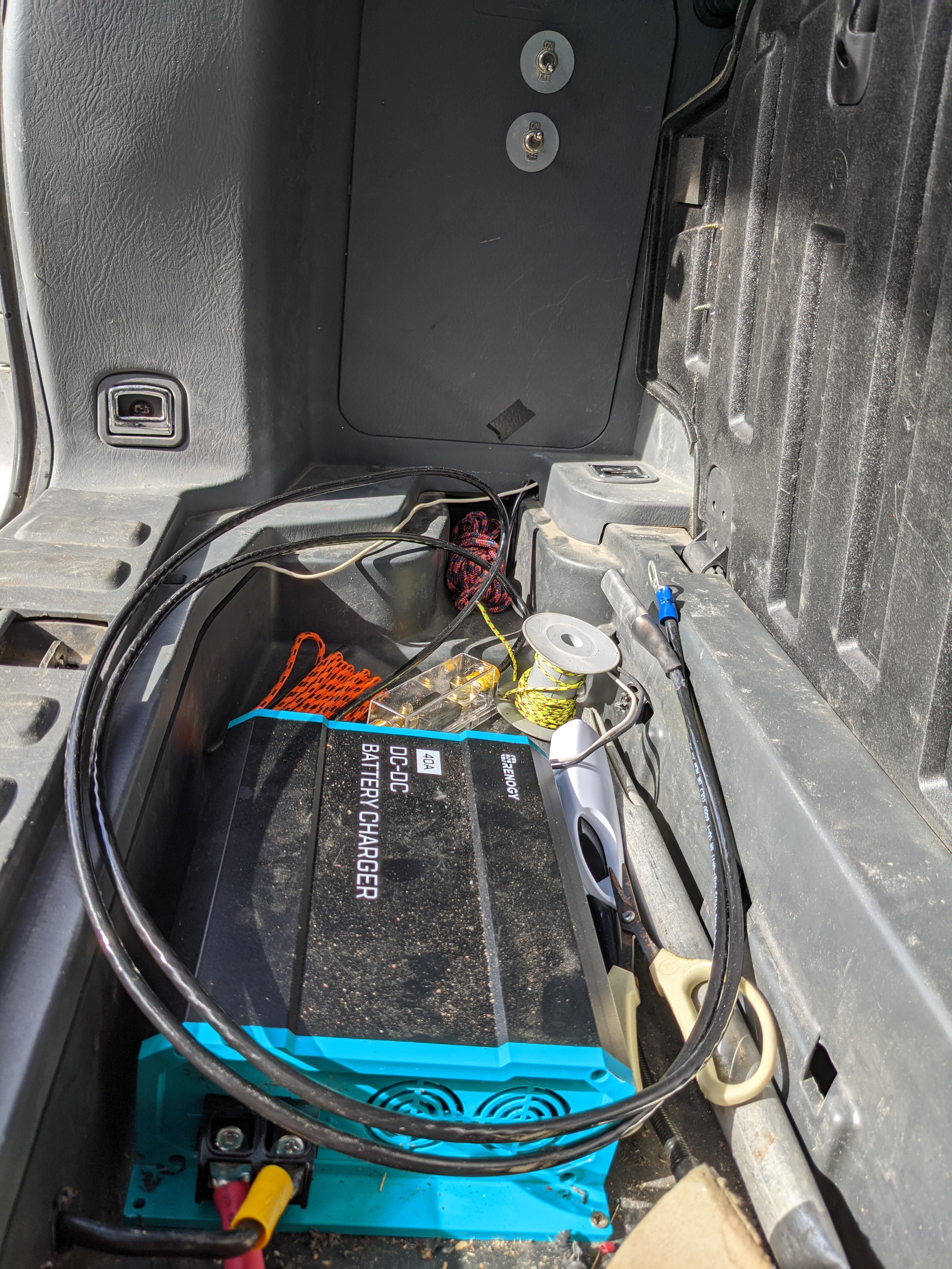

    I have a 100 W panel and have gone over a week with a fridge and the power kept up fine. I was, however, in full sun. When camping in the woods I have had the same problem as you and keeping things going takes a lot of attention, more than I am willing to give usually. My solution was to buy an extra battery to use solely with the refrigerator when things were stretched. Even that is limited of course, but it will get you through even a long weekend generally. With the fridge as you know, the weather outside has a lot to do with the time you get.
    I first used a big, Chinese lead acid battery that was quite a pain to carry along. When it quit, I recently got a lithium battery to replace it and am delighted with it. I also installed a DC-DC charger in my old Honda Pilot so that I can charge it up from the car when necessary. This I realize is a lot more than most people would be willing to do and it is probably enough to convince most owners that they can get by with a cooler after all. I however, have reached Power Nirvana.
    My charger installation. Yes, I know the car looks like hell but this is my camping/hang gliding vehicle and I don't care. The two switches are for power and a current limiter in the charger.
